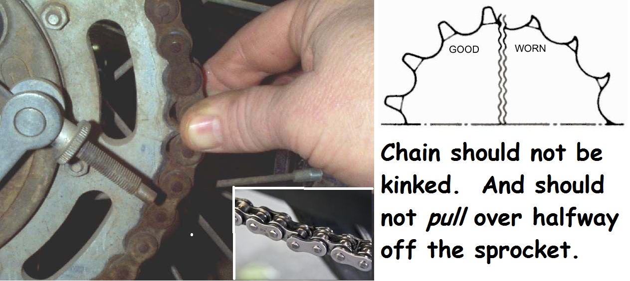

I was able to check the chain and it was looser than it should have been, but nothing to be alarmed about. I took it for a drive before tightening it up and gave it plenty of chances to slip, and only had it happen three out of maybe 12-15 times. I noticed it happening the most when in second gear and giving it full throttle from 2500-3000 rpms, and having it "jump" right around 4000 rpms. It only happened in second gear again.
I tightened up the chain and only got about 6 or 7 tries in, and it pulled with no problems. I wouldn't say the problem is fixed just yet though. This bike always tricks me the first time i ride it after working on it. I just can't believe I didn't think to check the chain in the first place.
I took a picture of the teeth on the rear gear. I would say it is worn some, I just don't know how bad is too bad. I have some store credit at a motorcycle shop and am thinking about converting to 520 chain and sprockets.

If it were me, I'd either be doing the conversion, or replacing both sprockets and chain.

The sprocket may last a while longer, perhaps for life of the existing chain, then replace both simultaneously.
