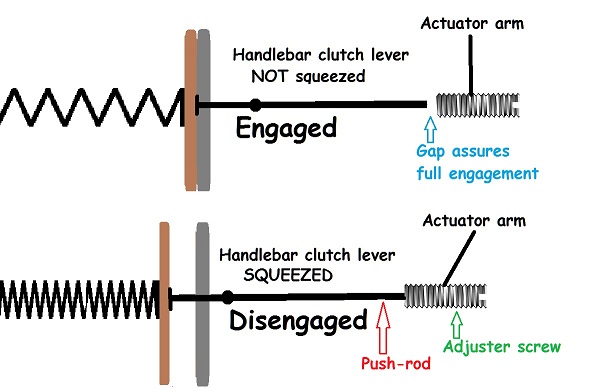

Perhaps needs clutch push rod adjustment.
The instructions in some manuals are confusing or erroneous as to the clutch push rod adjustment.
Particularly with regard to which direction the adjustment screw should be turned initially to close the gap and then turned the opposite direction to provide the necessary small gap.
If first turned the wrong way, the gap won't be closed, but will be opened so far that squeezing the handlebar clutch lever only reduces the gap and fails to press the end of the adjustment screw against the end of the push rod.
If the above instructions are applicable to the bike at hand, note that the adjustment screw is first turned out counter-clockwise to initially close the gap.
Upon failure of such adjustment, try again and reverse the screw turning sequence.

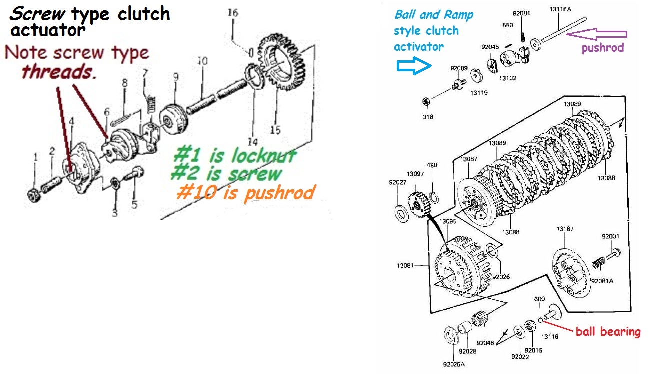

So I tried to adjust the clutch lever again, and when I would turn the adjusting screw in either direction, it would turn and turn and turn and turn, with no change in resistance at all.
I decided to take off the cover in order to get a better look at what was going on. When I did so, everything seemed to be in order and went back together just the same. There is some disconnect somewhere... I can't figure it out.
I read on another forum that the ball bearing (#600 in the exploded diagram for the ball and ramp style clutch above) might be missing... but I know I would have heard/seen if that had come out when I was replacing the clutch plates. The manual says to use a magnet to get it out, so it doesn't seem like something that would just fall out unintentionally.

On the 550's, the C1ymer instructions are wrong for the ball-ramp type actuator. Maybe the same is true for the KZ440. If yours is a ball-ramp type, and not screw type, then maybe check the link on my signature for the 550 clutch adjuster.
Also, that push-rod ball-bearing can easily fall out if it is not held in by grease, at least on the 550's. You'll want to confirm it is there by pulling out the push rod (unless you have the clutch side wide open, in which case you can see through the opening). Sometimes it will stick to the pusher 13116, and when you pull it out you won't realize it's stuck loosely (by grease) to the pusher. Then it will eventually, silently, roll off somewhere.

15 Apr 2012 21:28
Missing Ball between Pusher and rod
