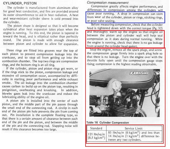

Have you done a compression test? Engine warm, Ignition off, plugs out, and throttle open?

04 Oct 2011 04:28 - 05 Oct 2011 09:21KZ1979LTD wrote: KZ Gurus, My bike has been running pretty crappy lately. 1979 KZ 1000 LTD. Pulled the plugs. Number 4 plug fouled with oil. Not good. Could it be time for a refresh on the top end? Bike has almost 30,000 miles on it. Runs bad at low rpm's. Better at higher rpm's. What exactly is involved in a leak down test? How does that differ from a compression test? Showing my ignorance I know but need answers. Could I just need new valve seals? Need input please.
With half-way decent maintenance and absent serious abuse, 30,000 miles is barely broken in.
Compression test can indicate weak compression.
Whereas a leak down test can better pinpoint exactly where the compression is being lost, such as a particular valve failing to seal and/or compression leaking past piston/rings into the crankcase, or sometimes a leaking head gasket. Basically, uses an air compressor to add air pressure to the combustion chamber, and then determine how long it takes for the compression to dissipate, and listen to where the pressurized air escapes (exhaust port, carb intake, and/or crankcase vent.)
