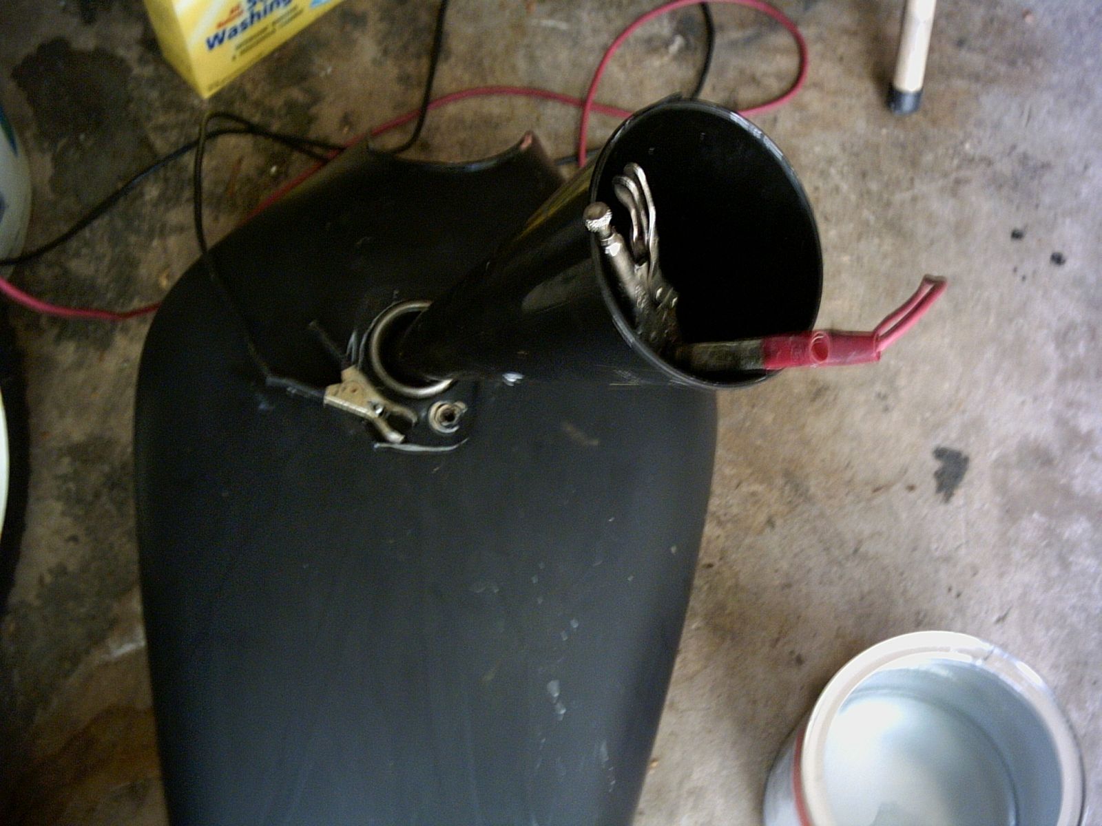

So I tried to take a couple of photo's with my POS camera. this one turned out good enough, but the others= Trash.
There is a piece of re-bar going down inside the plastic funnel, keeping it insulated. The depth is set off the bottom about an inch. the vice grips hold it there. The re-bar has about 4" exposed from the bottom of the funnel, this exposed section is where the transfer takes place. The water keeps coming out clean, but there is still scale attaching to the Cathode= re-bar, so continue to treat. I have the petcock and the Fuel Sending unit removed. i plugged the hole for the sender with a tool I already had, a Block off plate from my Two Stroke Crankcase tester. The petcock, well i have just been placing a fresh piece of Duct Tape over it each water replacement. So far only twice has it decided to leak from there.
I'll try again with the POS next water change, and see if I can get the rusty looking crap to stand out on the re-bar.
I found that if every 1/2 hour you pull the rod out and clean it, it goes much better. Rally starting to look good in there. I can't seem to get a decent photo to same my ass with this POS camera.

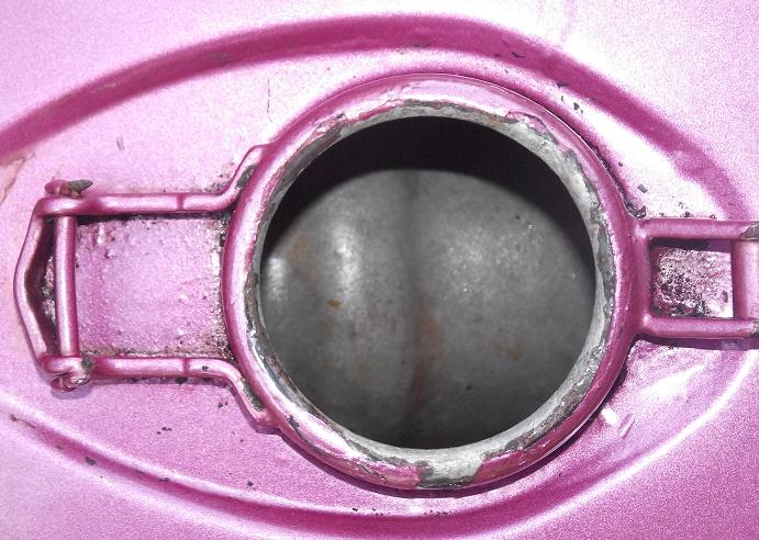

Ok so I've been at the electrolysis for quite some hours, like about 30. now I have poured in Phosphoric Acid, Immediately it has taken any slight surface rust away. now I've looked where I could with a small mirror and flash light. I see very little scale anymore, I can see right down along the seam at the bottom, looks really good. With this Acid rinse sitting for 1/2hr then rinse it and look again. I think it will be really clean, and no "Liner" needed. That was my goal.
Highly recommend the Phosphoric Acid, etches it to bare metal quick. The Electrolysis also did a lot of cleaning, worked quite well, although takes time. I think any through method is not going to be a "Slam Dunk", gravy grabbers repair. Like I said make sure the Beer fridge is stocked up Before the work starts.
