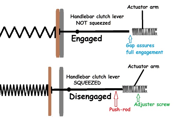

16 Jul 2011 01:41 - 20 Jul 2011 21:51If not already done, would perform clutch push rod adjustment.RunningFree83 wrote: ...kick start is slipping though. Some times it works but not enough to get it started. I push down and it just clicks and slips all the way down....

20 Jul 2011 21:50Patton wrote:If not already done, would perform clutch push rod adjustment....RunningFree83 wrote: ...kick start is slipping though. Some times it works but not enough to get it started. I push down and it just clicks and slips all the way down....
A frequent error in performing the clutch push rod adjustment is turning the screw the wrong way to lightly seated before reversing it 1/4 turn to provide the gap needed to assure clutch engagement.
Absent the required gap, the kick starter may push through as if the clutch lever is being squeezed.
Don't trust the manual, as it may have erroneous or confusing instructions.
The clutch actuator mechanism will be either a screw type design or a ball and ramp type design.
The screw type adjuster screw turns in clockwise to lightly seat, then turns counter-clockwise 1/2 turn to provide the gap.
The ball and ramp type adjuster screw turns in counter-clockwise to lightly seat, then turns clockwise 1/2 turn to provide the gap.
If there's any doubt about the adjustment, would do it the reverse way to see whether it might resolve the reported kick starter issue.
