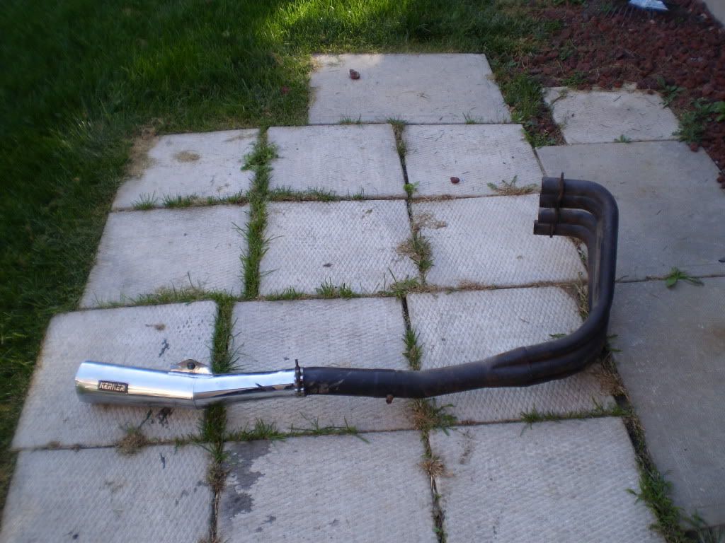

I am getting this exhaust this weekend. It is a kerker muffler on a non-kerker header. If this is a mac header , which from what I have read sucks, will this exhaust sound and perform like a mac, or will it be not too bad. For the price I am not complaining, I am just curious.

I doubt if it is a MAC. The Kerker i have has a bigger diameter pipe than my Mac.

Looks like a Mac to me. The Mac I have looks like the one in the photo. You can tell by the steel mounting flanges at the head connection.
I have no problem with the Mac header. It's the Mac mufflers that are really cheap. They sound terrible and need a lot of jetting. The only issue to beware of is to make sure you use new crush gaskets at the head. Those steel flanges can bend and cause leaks (which leads to popping on deceleration). With new crush gaskets, it shouldn't be a problem.
I think a Kerker muffler on a Mac header would be good. In fact, that's exactly what I'm planning to do.
Oh, and I have Kerkers in several sizes. I plan on putting my Kerker K-series muffler on a Mac header. They are both 2.5".

Well I ended up getting it. He gave me the handlebar for free and the exhaust for 120, BUT there is no baffle. It has the kerker endcap with what looks likea 1.5" hole. The header looks like it is in good shape, a little sanding and some bbq paint and it will look like new. The muffler looks good too so I am happy. I have not been able to find a good used exhaust anywhere for anything like 120 bean including shipping so I am happy.
Does anybody want to sell me a kerker baffle??? are good sounding baffles hard to make?

Yes, you can get new baffles for a Kerker, but they are not cheap.
www.dynoman.net/exhaust/baffles.html
It's not hard to make one if have access to a welder. Or you could probably make the metal parts and have a muffler shop weld the pieces together. Fabbing the parts is what takes time.
kzrider.com/index.php?option=com_kunena&...ew&catid=2&id=313649
Dennis Kirk sells pre-made, peforated tubes for making baffles. They have many many to choose from. Just search their site with "baffle".
Here's just one example:
www.denniskirk.com/jsp/product_catalog/P...32&leafCatId=&mmyId=

what i did for my kerker was to pull out the old baffle and insert a muffler i got from auto zone for about 30 bucks. it sat in the cone about 1/2 inch diffrent so i just drilled another hole in the megaphone to attatch the kerker end cap.

How does it sound though? I like the look and SOUND of the kerker, so I dont want a kerker pipe that doesnt sound good. Does the baffle make a big difference on the sound?

sounds good to me. dont think it makes that big of deal. just a little quieter and if i get stopped i can point to the innerds and say..."why yes officer it does have a baffle in it."
