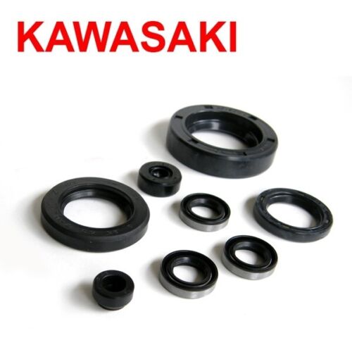

There is no bushing in the sprocket cover. There are three seals. One in the transmission cover and two in the sprocket cover. One is pressed in from the outside facing out and the other is pressed from the inside facing in. They have to be destroyed to take them out as the the cover is milled to act as a bushing for the lever shaft. The two seals act as support for the shaft. You'll find they come as a set of three in the seal kits.

And not very difficuld to remove and press the New ones in
Re: Seal by shift lever
25 May 2023 08:42
I bought the whole kit on eBay.
1973-80 z1 z1r kz900 kz1000 kz 1000 motor engine Oil Seal Kit crankcase gasket

Z1E also has them. Part 200-1032, you'll need 3 of them. Install them as described in Steve's reply.

I paid $31.49 with free 3 day shipping. I changed all the seals while I was at it.
