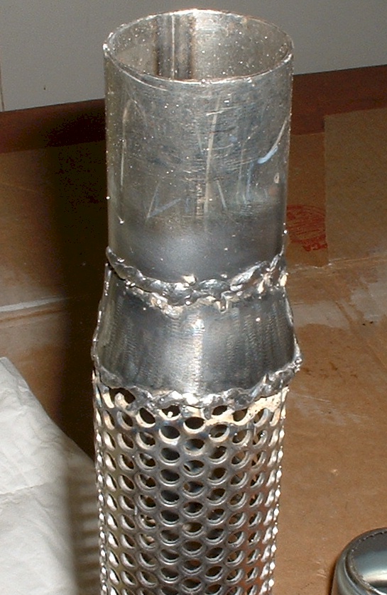

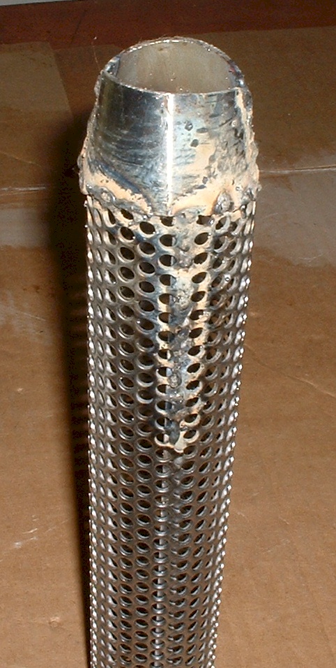

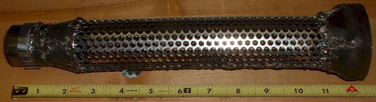

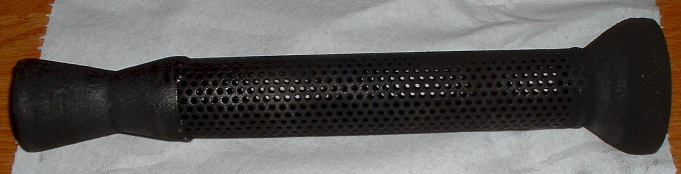

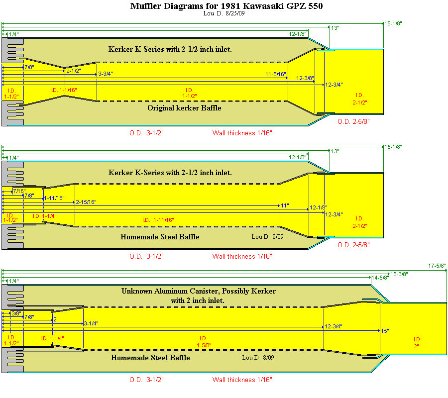

Dennis Kirk sells the screen material already rolled into a tube. You just have to make some ends and weld them on.
I've made several, but I rolled and welded my own screen that I bought at a home improvement store.
Here are some diagrams for a couple different size Kerker K series canisters.
Here are some photos of the homemade baffles I made.
Here's an actual Kerker K series baffle.

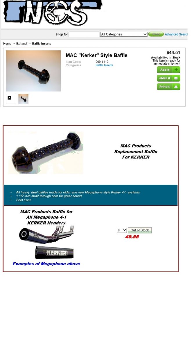

MAC builds baffles for Kerker exhaust... ~ $50...
NCS MAC Kerker
MAC Baffles - Kerker
