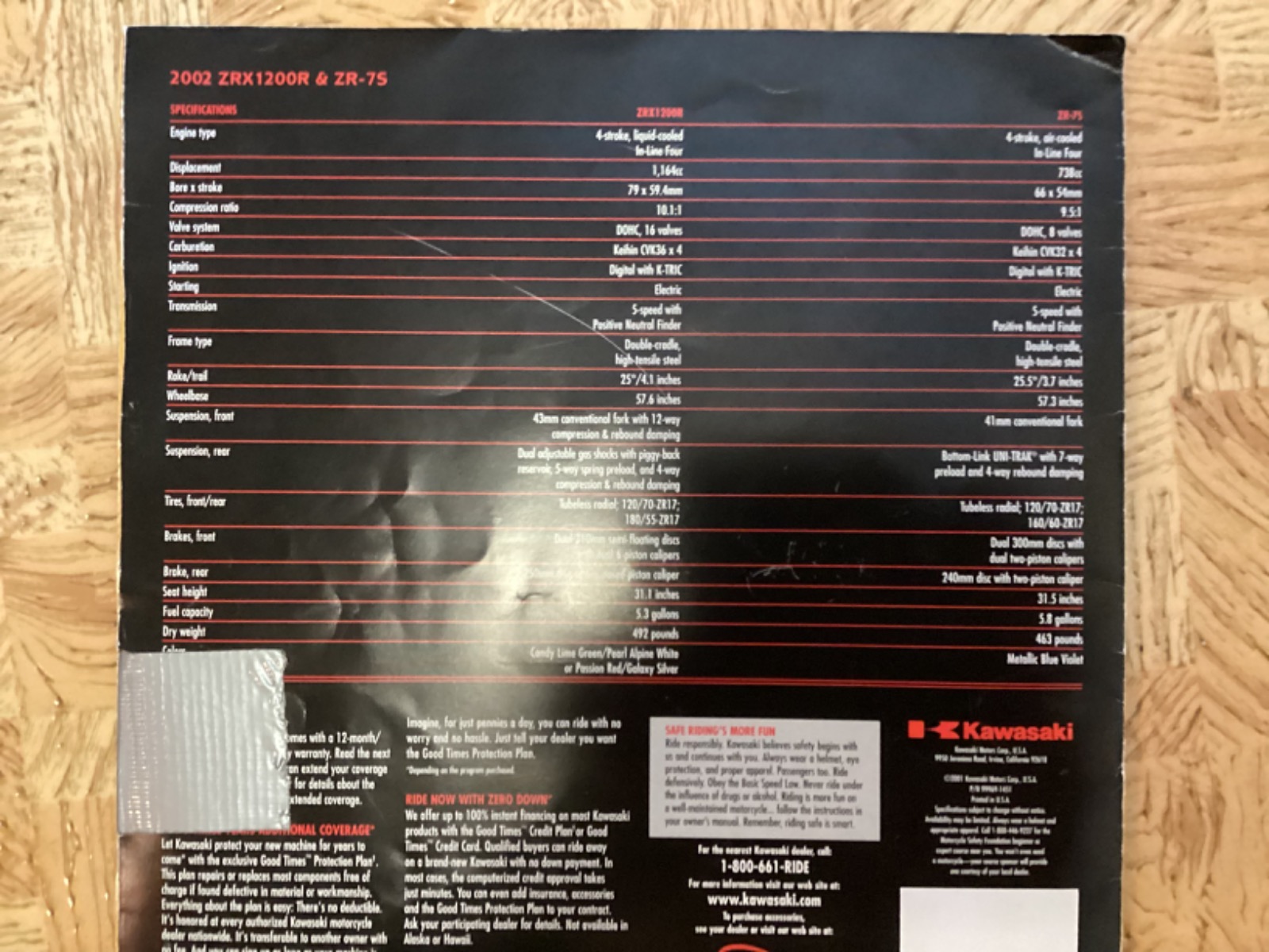

I know I’m digging up an old topic but I find it of interest.
I'm posting a link to a review of the '82 GPZ750. Inside you’ll find the engine specs and where Kawasaki got the power for the engine. You can use this data to compare it to the specs of the engine in the newer ZR7/ZR7S.
For starters, the ZR7 uses CVK32mm carbs compared to the Mikuni 34mm of the '82 model.
The compression ratio on the ZR7 is 9.5:1, same as the '82 750.
I don’t know if Kawi continued the mild port job on the newer engines or much else about the internals such as cam specs but I’m assuming the pistons are the same.
The 1982 dyno'd at 65rwhp. My seat-o-the pants says my 2001 ZR7S does too, or darn close.
Here’s the link… www.motorcyclespecs.co.za/roadtests/kawasaki_gpz750_cycle.html
Heres a blurry pic of a brochure. I have the factory 2001 manual if more info is needed.
