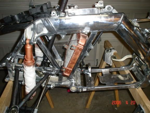

i spent 2 months polishing an all aluminum 4-wheeler frame. it wasnt polished originally and it was rough forged aluminum. easiest way is to use a 320 grit sandpaper to sand the big rough spots out, then keep stepping up till you use a 2000 grit wet sandpaper. after that i used a die grinder with a polishing wheel and i used some green crayon like polish. heres a pic before and after...
s82.photobucket.com/albums/j253/cannibal...current=cannon10.jpg
i82.photobucket.com/albums/j253/cannibal...stalled/DSC02041.jpg
this is the first 4-wheeler ever to use an aluminum frame. also it has no auxillery oil reservoir. you actually put the motor oil inside the frame and it circulates through both sides and through the motor. wierd setup but works great as a heat exchanger.

I agree, gmokage. The variable speed Dremel works great and saves lots of time. I finally broke down and got one last week. I used the 1-inch felt wheel with Simichrome (just enough grit but not too much).
Cool job, Cannibal440. Having spent a bit of time with the small amount of aluminum on my GPz (just the wheels), I can appreciate the effort! Very satisfying when you see the results.
