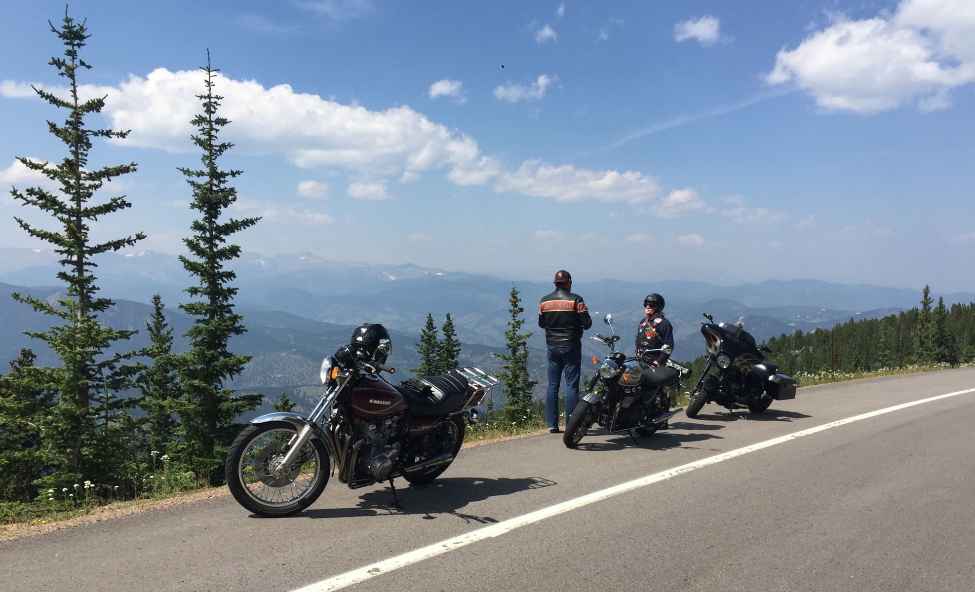

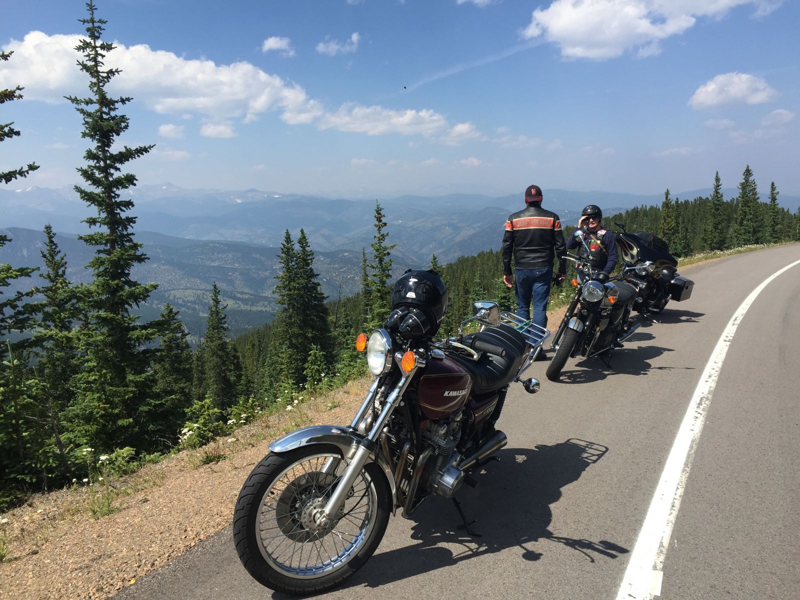

305 miles on the fresh top end overhaul with 1075cc kit.
My two riding buddies... Jim's big Harley with 12:1 Pistons and all kinds of hot rod mods. And Danny's 2014 Triumph Bonny and of course my 77' KZ1000.
This was a couple hours ago over Squaw Pass near Mount Evans

Nice pictures! Must be awesome riding up that way.
