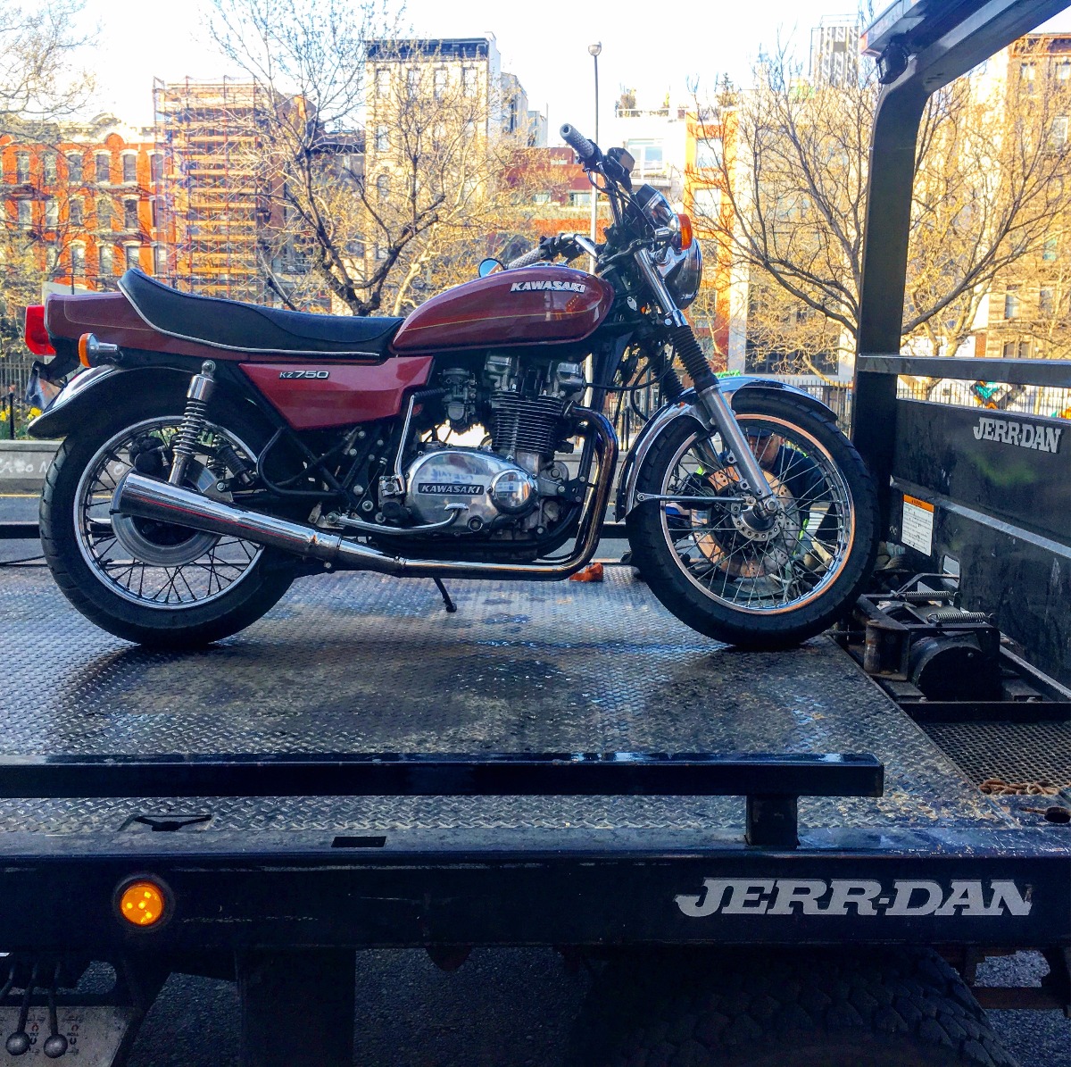

Thanks. Here is my bike getting towed after it happened:
