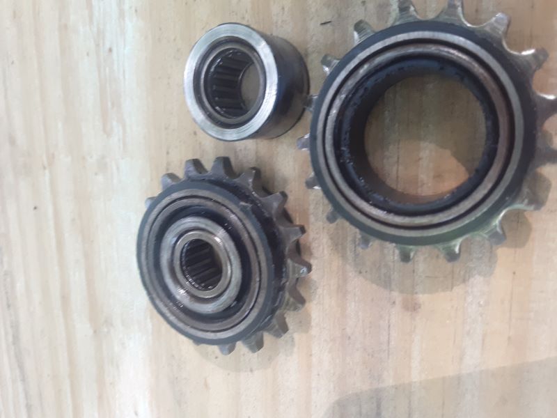

As far as KZ's go, when I had the top end of my 900 motor apart last year I found some sprockets with the rubber separated from the bearing (see pic). I think it was due to 45 year old parts not being run in 15 years.

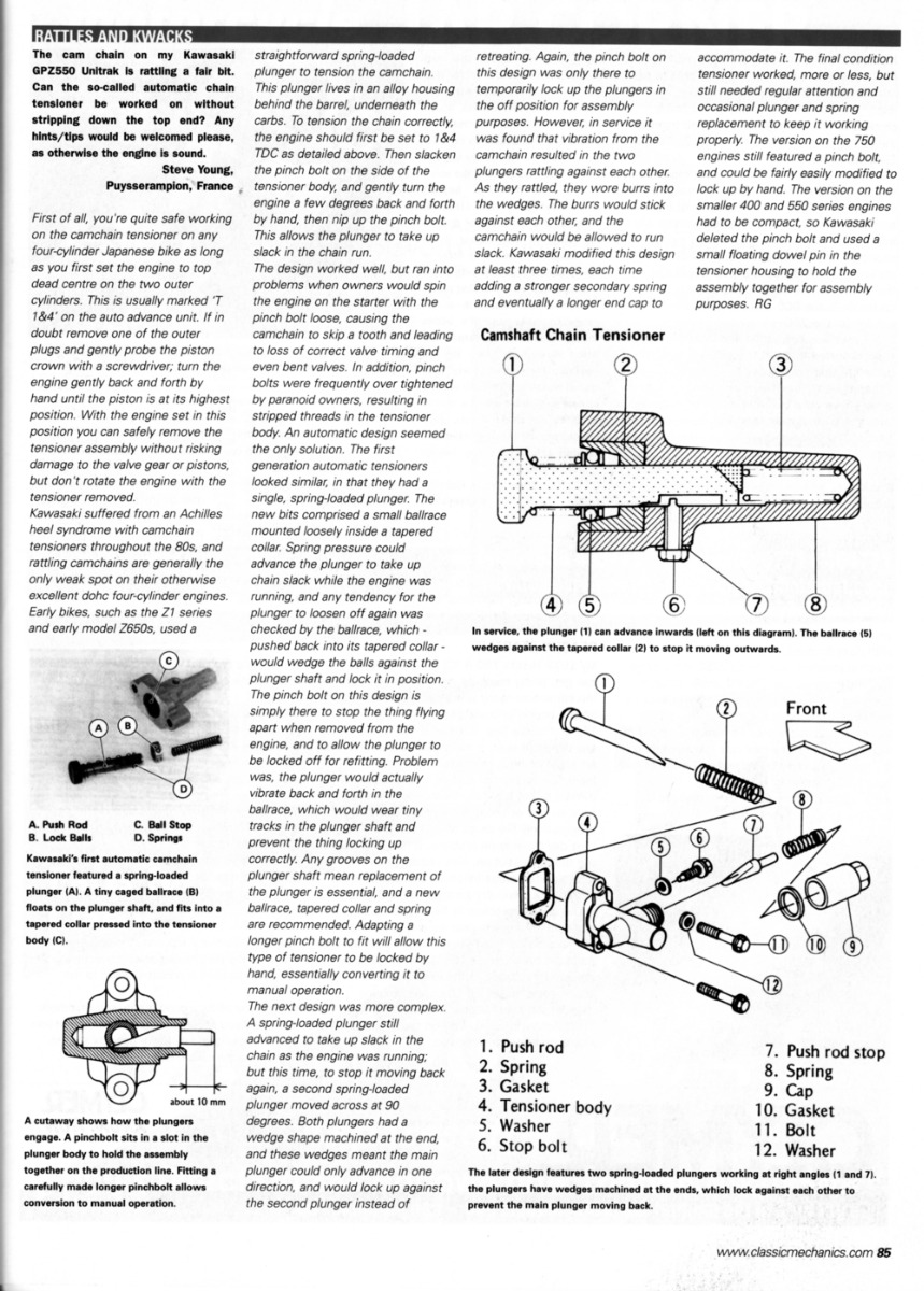

ALL three mentioned camchain tensioners had their problems. Slmjim, the 360 along with the CB350F and 400F had that horseshoe tensioner that wrapped along underneath the crankshaft camchain sprocket and totally different then any Kawasaki. It's main issue was that maintenance of adjustment was rarely addressed plus accessibility to the adjustment was in a precarious spot. Sandwiched between front lower engine mounting plates and frame down tube. Not maintained lead to chewing-up of the "shoehorn", have done my share of them. The early Honda VF750 "tariff imposed" and VF500 had problems too. They in comparison to any Kawasaki, were quite complex with that double bank of sliders/springs and guides. Can't remember exactly the issue but perhaps, oiling? The V4 had an oiling issue because the camshafts were the last to get oil pressure from the pump. Oiled thru the transmission before any oil got to the top-end resulting in a lot of those with still running Magna/Sabres and Interceptors with In/Out clattering of valvetrains. Moving to the early KZ1300. YES, those early camchain tensioners with the "Lock Balls" or also called Retainer were a miserable design Kawasaki chose to use starting in 1979 on many KZ models. Intention was a "wedge" of Shaft/Balls and metal tapered sleeve pressed into the tensioner body. Was only supposed to move in a progressively outward location to keep tension on camchain. In reality the balls in retainer would start hammering away at shaft and tapered sleeve or pinch points. This oscillation, because they do, rendered the design short lived. The "later" 2 wedge design was a Much improved/needed upgrade.

My 1981 750 has the dual wedge type tensioner, with the cap and spring, which makes install of the valve cover quite easy. I don't race, so can't say I max stress the engine, but so far, no issues.
I think some people like to complain about tensioners needlessly. They move to a manual tensioner, then over tighten the chain. It's a common tendency, which is one of the reasons, I suspect, that the OEM's moved to automatic tensioners.

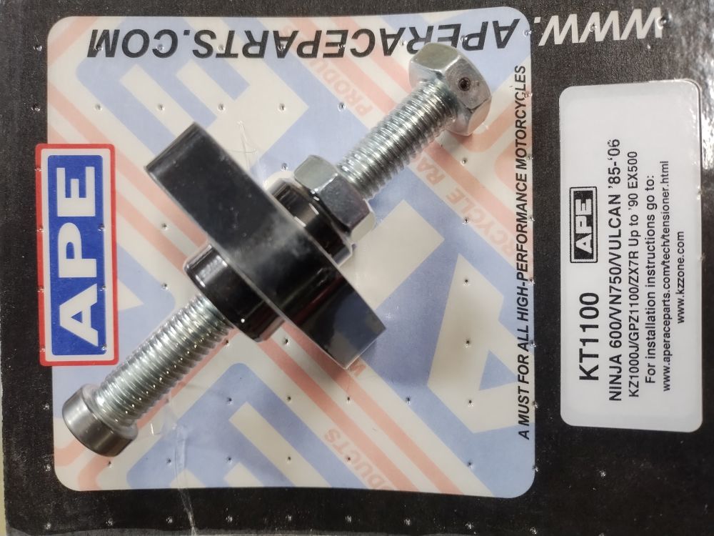

There is the double wedge auto type on my 1983 KZ1000R.
I took it apart and cleaned it.
When reassembling it, the smaller wedge, which gets inserted last, is supposed to stick out 7.5 mm or so, I believe.
The smaller wedge went in much more than that, so I'm not trusting it.
I'm going to have another look at it, but have already bought a new APE manual tensioner, so will likely use it.
