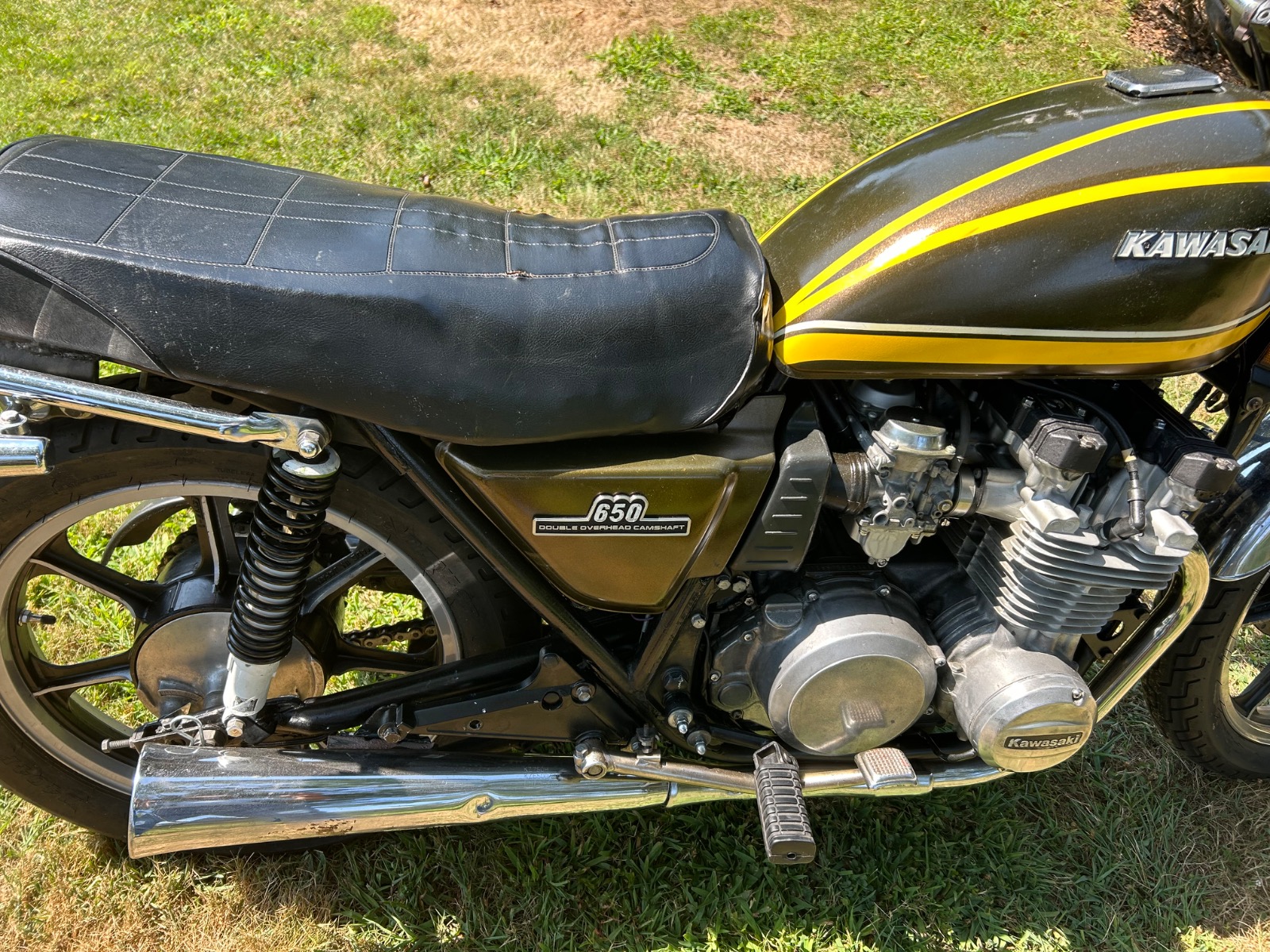

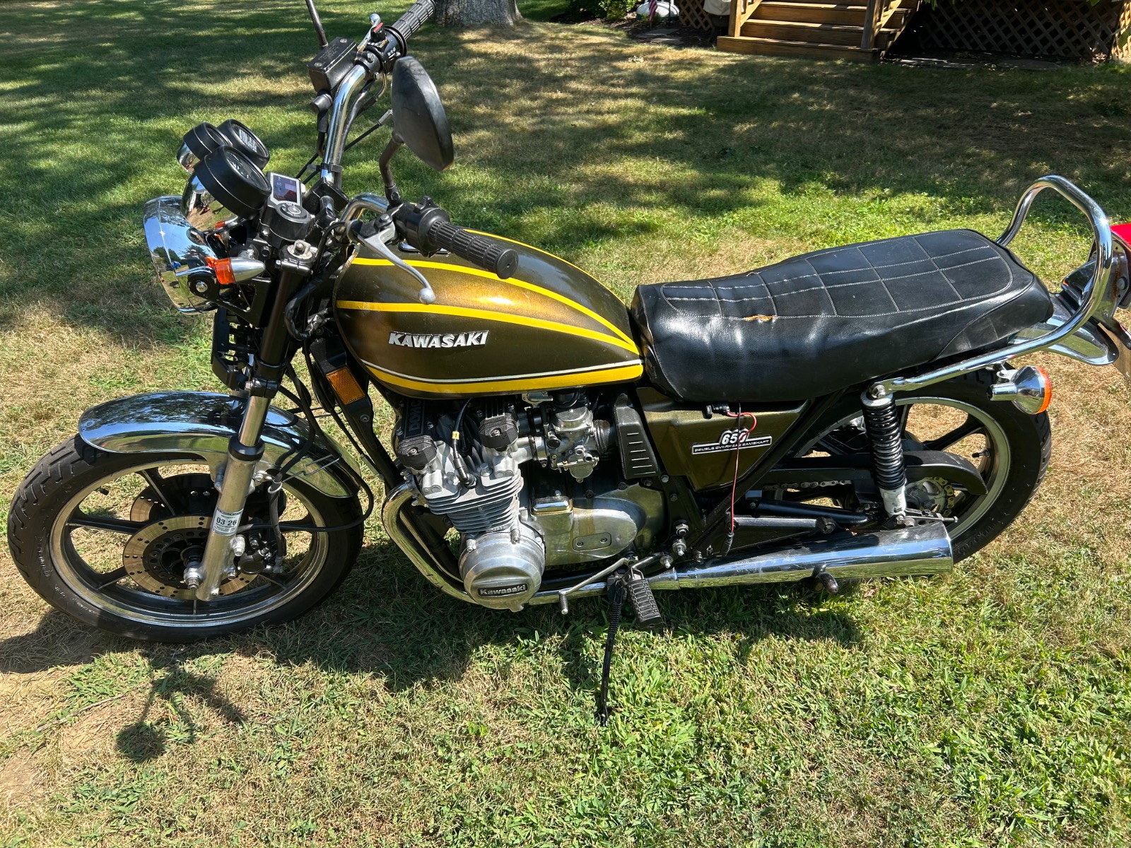

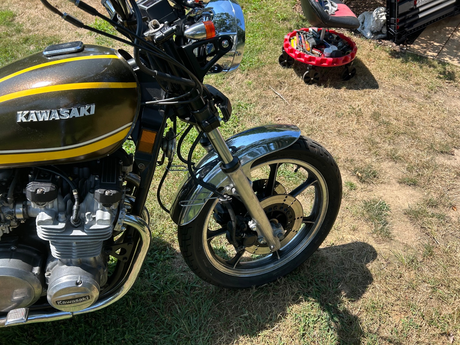

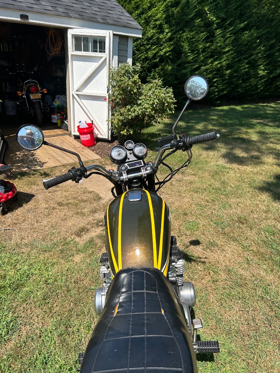

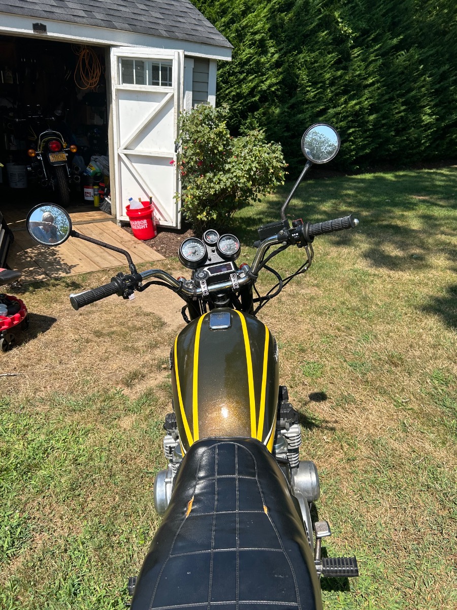

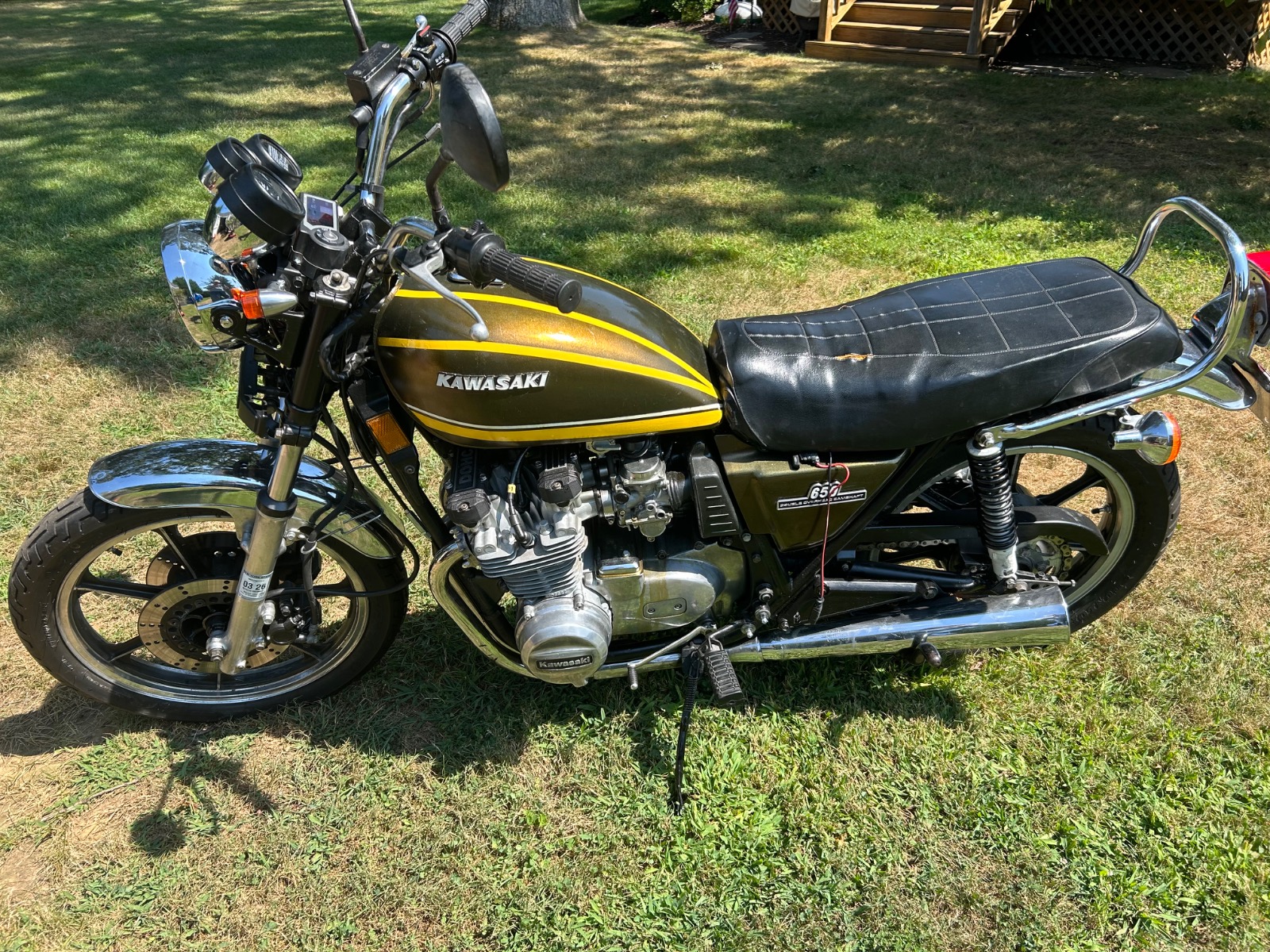

Hi, just to add, what makes this site great, is the help and info, members provide, info is here, search a problem on google, one of the replies sends you here, this patina special had a toasted harness, bent bars, busted tach, and more, but it had compression and a key, no papers, had about 15k miles, and about $2k later this came to be, all from the Kawi parts bin, via ebay and others, motor not touched, had this out the other day, runs great, with a a few mods, new stator, 775 reg/rec, gpz 750 ignition, electronic advance, engine covers from a 700, as are clocks, these are geared for cruising, low end, 70mph=5000rpm, and steady as a rock, I don’t ask a lot of questions, just do research, thanks to all

And you did a great job with yours. It looks like you took a lot of the CSR out of it. You changed the wheels, but did you change the rear wheel size too? (not sure if that's even possible)

looks like an 18". 650F or 550A. should be direct swap.

So 16 to 18 is a direct swap?

Yes it is, had a 16 cast wheel on first, I’m tall, found the f2 wheel in Germany, not many sold here, also 750 cam cover, they flew first class dinner and drinks, $$$ shocks are kiwi part from the 70’s had on the 900, probably gained 2 inches or better, took it to beach today
