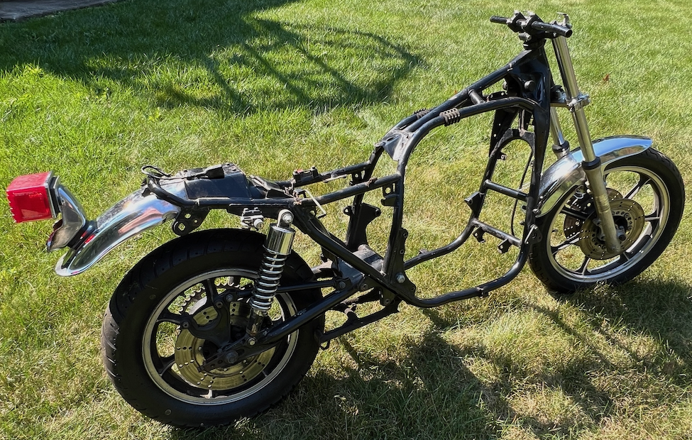

I recently picked up a 1981 KZ1000 for a project. As you can see, she is 100% complete
The plan is to build an electric bike and this frame has so much room foractivities batteries. It does have all of the brake and footpeg hardware, mirrors, decent tires, and it came with a really nice tank as well. $200 with a clean title
The funny thing is the VIN says it's a 1000CSR but it has LTD wheels; from what I've read, it looks like the CSR should have spoked wheels. Oh well.

If the seventh letter of the frame number is K, it is an LTD. If the seventh letter is an M, it is a CSR.

09 Feb 2025 20:55Appreciate the info - yep, it's an M.If the seventh letter of the frame number is K, it is an LTD. If the seventh letter is an M, it is a CSR.

10 Feb 2025 05:32 - 10 Feb 2025 05:39The funny thing is the VIN says it's a 1000CSR but it has LTD wheels; from what I've read, it looks like the CSR should have spoked wheels. Oh well.
if the cast alloy wheels are lighter than the spoked, then that would be a good thing, especially on an electric motorcycle.

10 Feb 2025 06:43 - 10 Feb 2025 06:49if the cast alloy wheels are lighter than the spoked, then that would be a good thing, especially on an electric motorcycle.
That's also a good question. I bought the frame from the father of a guy who was planning to do a diesel conversion. I don't know if that was part of the wheel-swap decision, or maybe he bought it that way originally.
