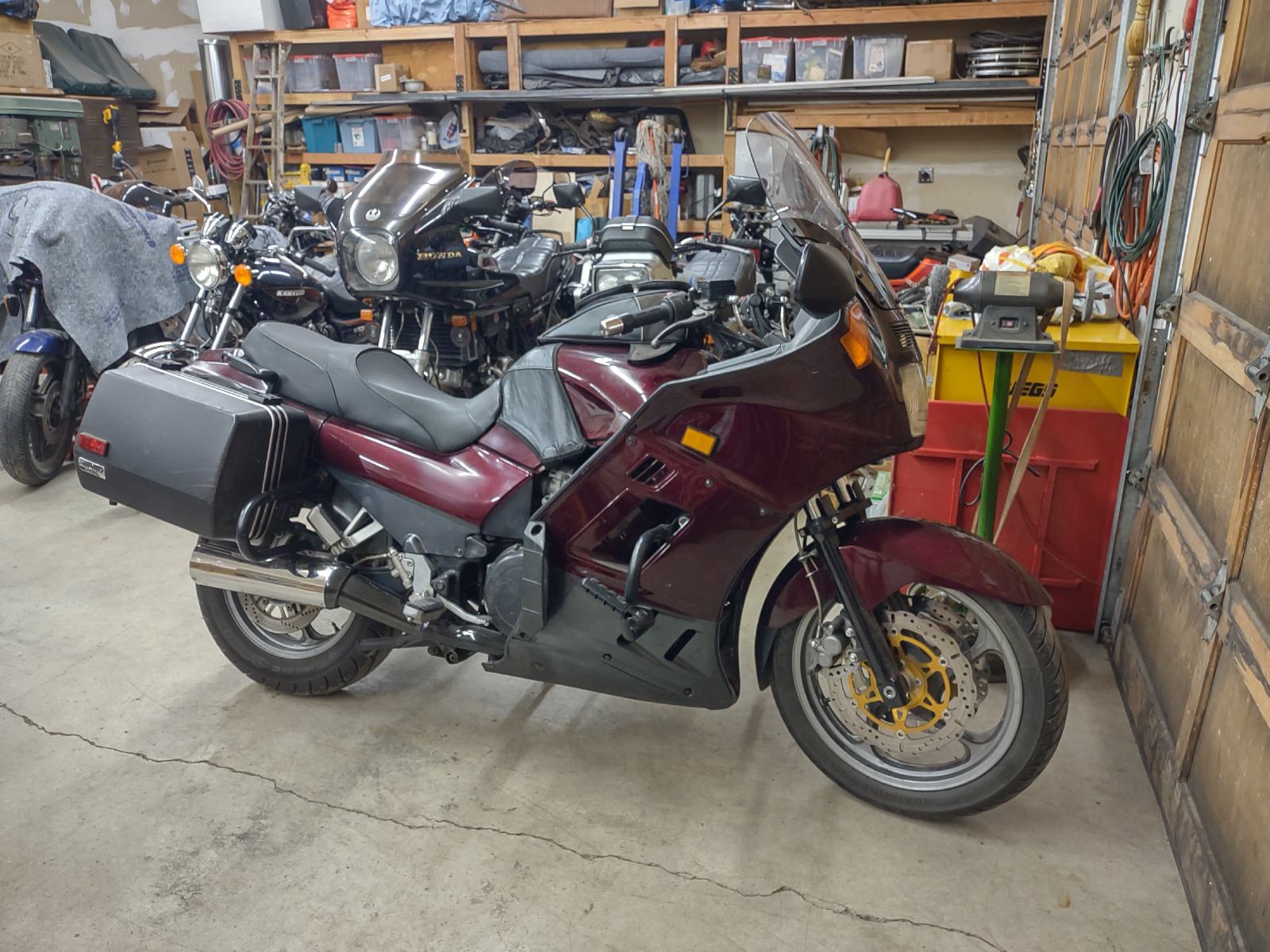

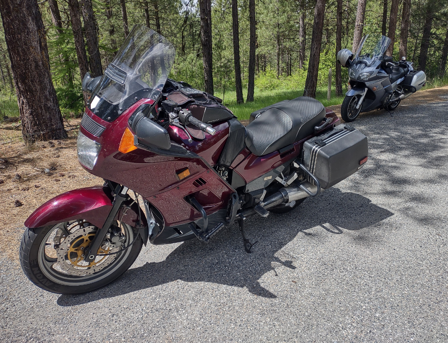

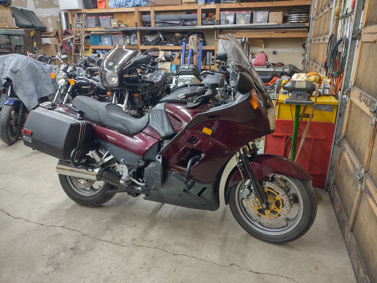

Wookie, you can always accept the ZG 1000 GTR/Concours for consideration, there's a lot of them since Kawasaki built them for 20 years, 86' to 06'. My 94' is old enough that it now has collector plates on it. They were built for sport touring and handle really well. I go on long distance rides every summer on mine and it is an amazing bike. Kawasaki really did their homework when designing it. If you are a fan of Kawasaki's you should appreciate what they came up with to compete with the Goldwing using many parts from the bin.
I love my 77' KZ 1000 LTD, it's my favorite bike but I wouldn't take it on a 4k mile road trip. I've done 750 mile days on the GTR/Concours and felt fine the next day and ready to do it again.
I appreciate many brands of bikes and think Kawasaki really accomplished the goal of producing a better sport touring bike that could cover the distance and still be absolutely fun while doing it.

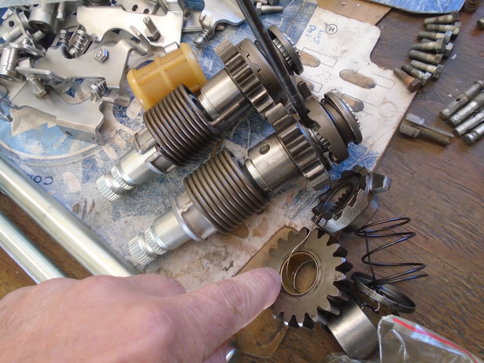

Didn't want to clog-up the initial intent of this Topic but.. Lets know what You find Hardrock. Could be a multitude of things, lots of stuff spinning in there. Sound can resonate within the castings and make it hard to denote "what's-up". You answered the question i was going to ask, a bad camchain sprocket (4). I show a picture of the kick starter assembly, that bushed gear is always spinning. I have gaggles of crap if You need it. Fancy to merely replacement, Tupperware containers of it.
