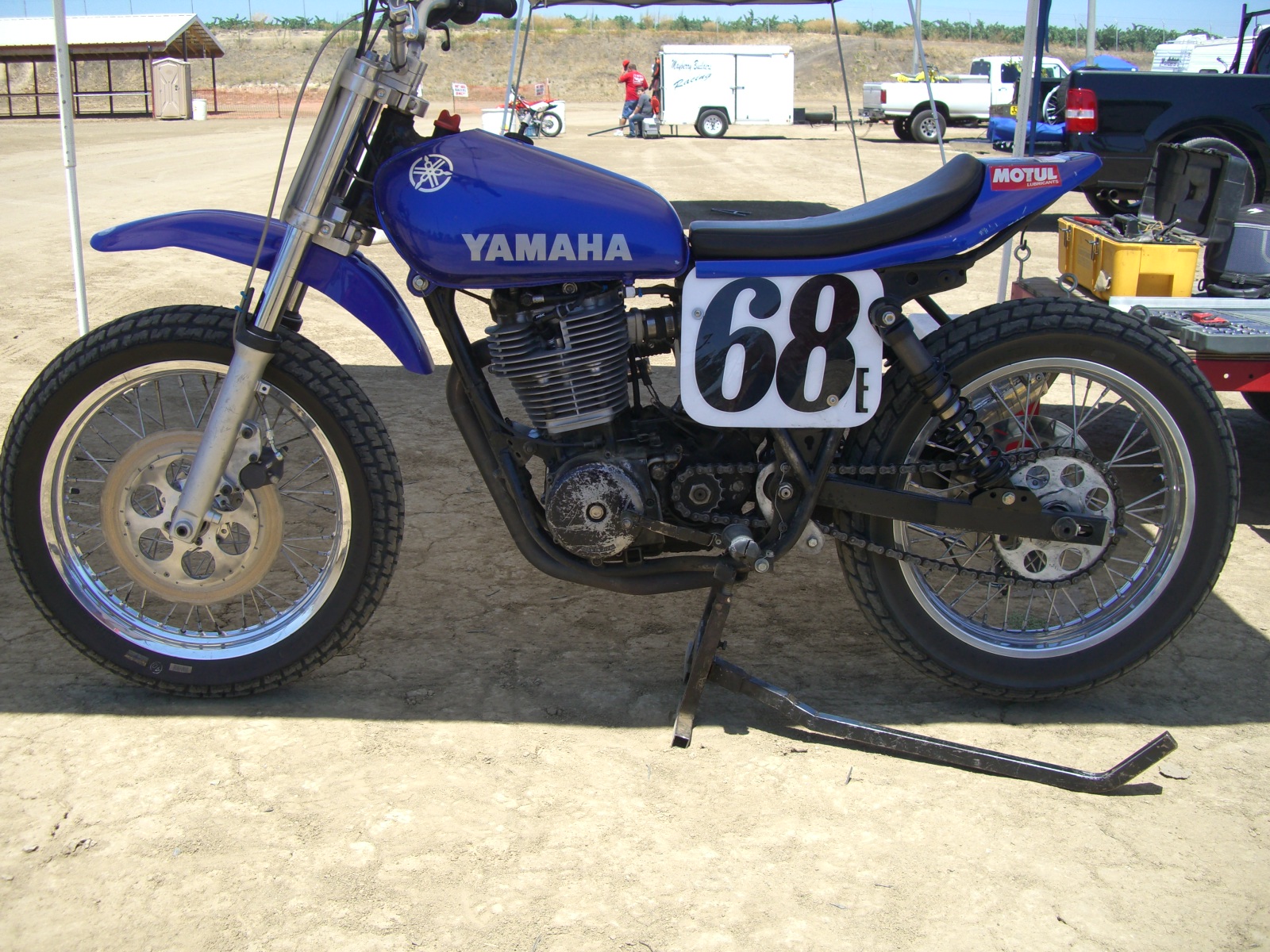

It is/was a pretty common mod in the flat track world. Especially old guys riding/racing old cantankerous vintage bikes
See the modified cover with the flush fitting bolt in the middle of the cover.
dammit... ETA #2. It didn't use a drill motor. Off the top of my head, it was a Toyota truck starter motor mounted onto a hand held frame. Sorry, no pics of it

07 Jul 2023 13:03I believe mine was from the gas model. Either way, it was turning over almost 670ccs at a time of 13:1 on that old blue bike in the picture above. If you're using one to spin a 4 cylinder, 1000 cc, you're really only compressing 250cc at a time. Easy peasey.Toyota diesel truck starter motor, just as strong as the 440 Chrysler but more compact, more $$ used. I believe they are a high torque starter motor.It is/was a pretty common mod in the flat track world. Especially old guys riding/racing old cantankerous vintage bikes See the modified cover with the flush fitting bolt in the middle of the cover.
