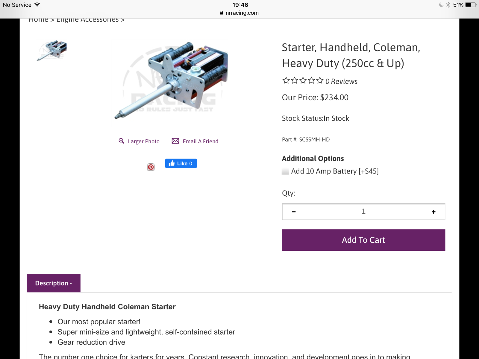

Not sure how successful you will be with this, if you look at the starter clutch and starter pinion it's about an 8:1 ration to multiply the torque (paddock starters have a set of reduction gears in the nose) also how is it going to disengage when it starts paddock starters have a specially designed fitting to "cam out" the starter when the engine fires?
Love the pioneering spirit though

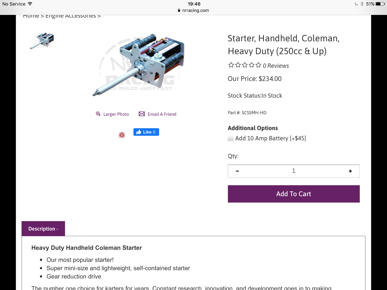

No worries, the starter clutch reference was to highlight the gearing required to spin the engine with an electric motor that size. As you can see the below "off the shelf" item also uses reduction gears

You'll have no issue removing the socket. Once it fires you'll have more trouble keeping it on there than taking it off.
Wookie is right you'll need a big drill to turn it over. Especially if it's a large capacity single. I use a large kango type drill in rotation mode to start my bench builds and even that was touch n go powerful enough on a 1100 4 cylinder.
