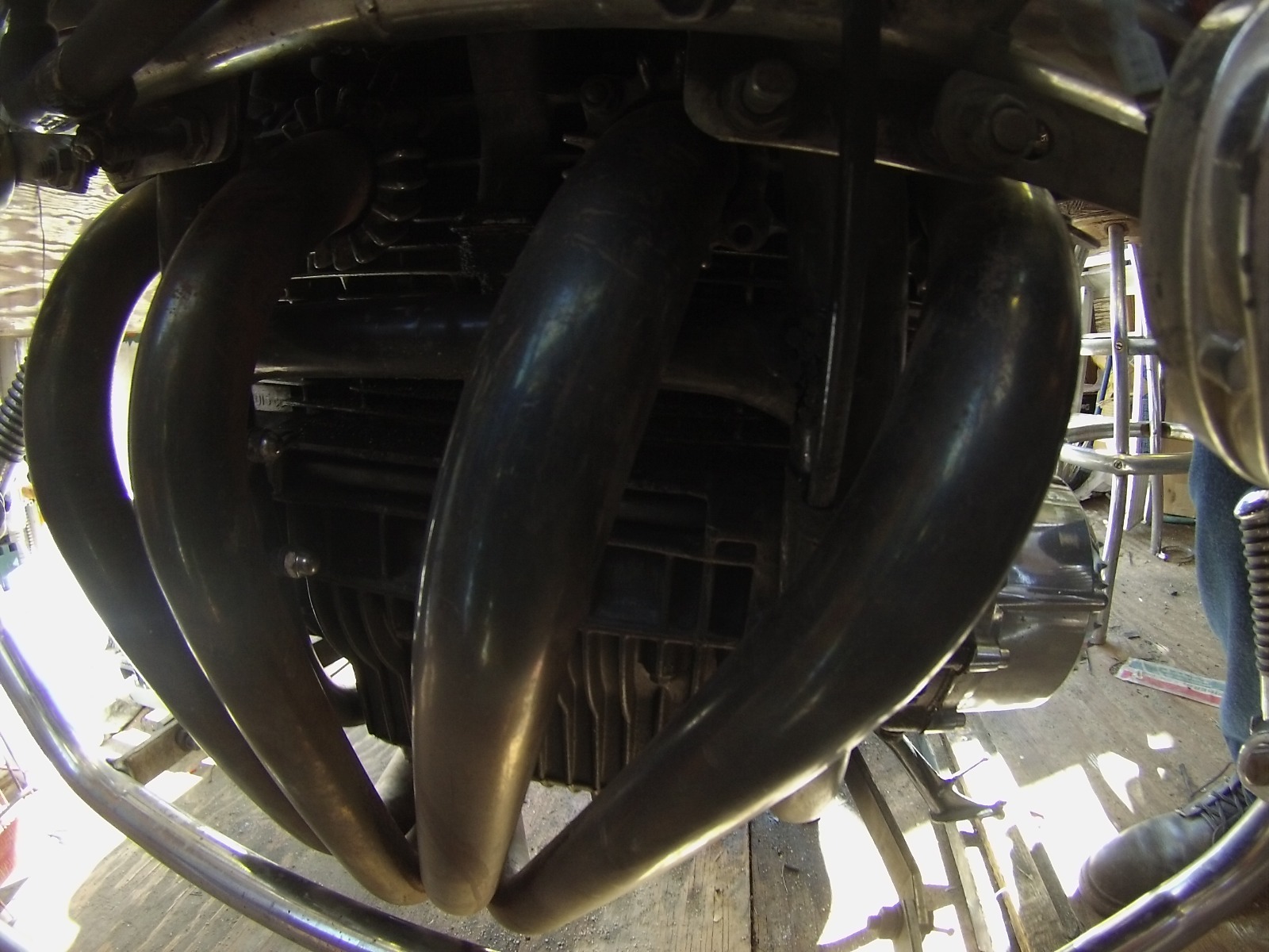

I used what I had on hand to beef up the gusset on both sides. Next I'll be using larger angle metal to completely cover the gusset top to bottom in the same shape. The one I added to the frame below the pipes helped too. The one above them you can't see. This is a KZ 900 frame and had the same cracking problem. I bought what thought was a Z1 frame but it turned out not to be. Now it's a Franken bike with a salvage title but it's all mine and I can do with it what I please without decreasing it's value. Love what you ride and ride what you love.

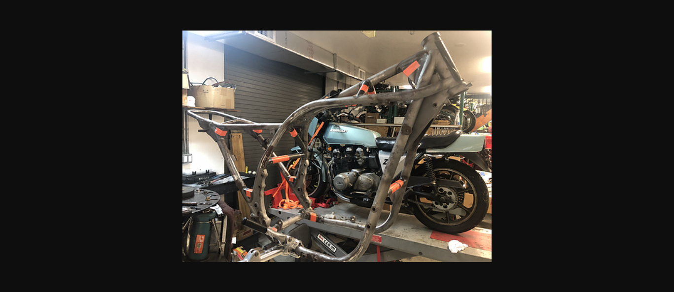

The best thing you can do with that gusset in the front of the Z1/KZ frames is remove the whole thing and replace it with some tubing going from the front downtubes to the lower part of goose neck. Then weld in two tubular braces between the two front down tubes. Then from that lower tube you just welded in place another piece of tubing going from that tube up to the very top frame tube. I can guarantee you that will stop any frame flex in the goose neck area!!!!
This is what Sanctuary does to all of their 50 grand trick Kz1000 builds!!!!! Here in the States the road racers have been doing this to the Z1/Kz900/1000 frames since back in the late 70's!!!!!
These two photos will give you a great idea of what I am talking about.
You can clearly see the tubular brace going from the front down tube to the lower area of the goose neck. Notice the tube that goes from the newly welded in lower tubular brace all the way up to the very top frame tube.

20 Mar 2021 09:28The best thing you can do with that gusset in the front of the Z1/KZ frames is remove the whole thing and replace it with some tubing going from the front downtubes to the lower part of goose neck. Then weld in two tubular braces between the two front down tubes. Then from that lower tube you just welded in place another piece of tubing going from that tube up to the very top frame tube. I can guarantee you that will stop any frame flex in the goose neck area!!!!
Thanks for the advice Doc. Our advertiser here does nothing with the gusset and the three back pieces won't work with the air box and center stand so I'll use a little of what they all have, what KHI did with their later frames and beef up the gusset as planed. The gusset is flimsy at best but it works with my cooler so I'll keep it.
KHI boxed in the areas where all the tubes meet so at least they were finally getting serious about it.
I'll be getting a Mig soon so I can get started. It's a cheap HF one but has good reviews and is all I'll ever need plus there will be plenty of money left over for fork emulators among other things.
