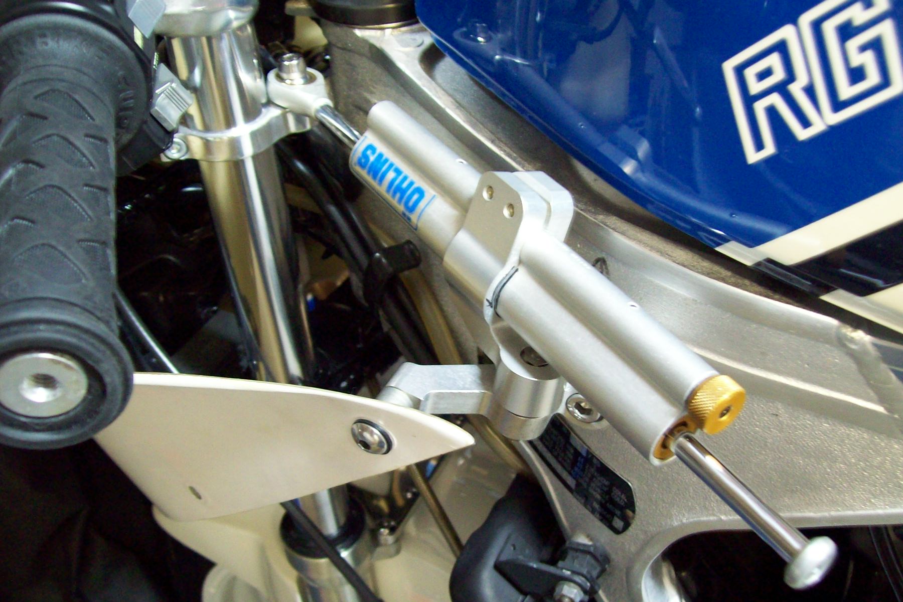

1986 RG500G 2 stroke terror.

Re: Wobble and weave
18 Mar 2021 19:13
In a swimming suit with a steering damper????

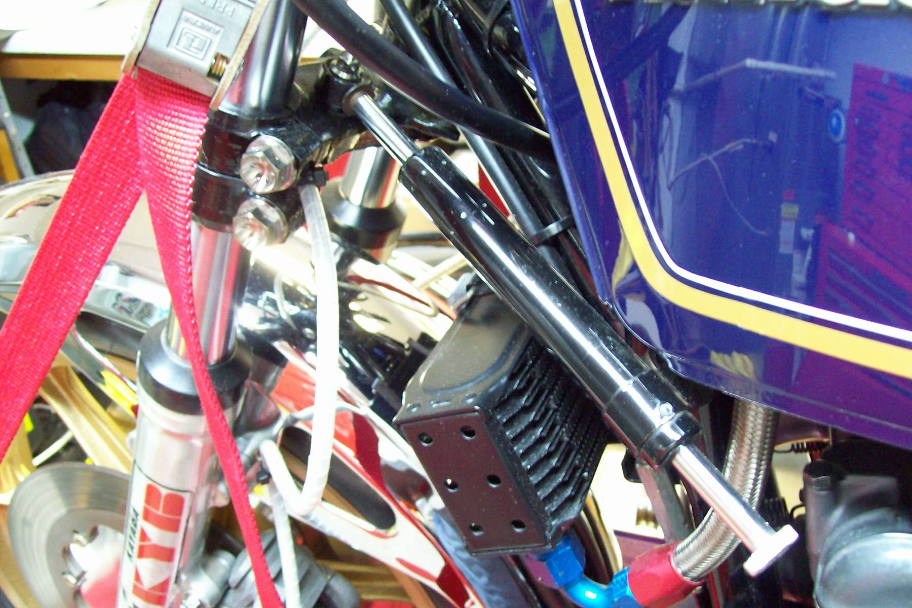

Here's my solution.
Me and my buds were going way to fast to allow any wobbles.
I experienced wobble on my 750 Triple H2 and didnt want to ever go thru that again
So we all gusseted our frames, Roller bearings in steering head, , steering dampners ( 2 on mine ) and tight bearings in the swing arms, all back in the day
Since then I added the fork brace and then had Les Holt @ PDM build me these trick triple trees
My Bike Dont Wobble and I feel the effort was worth it. No worries at speed

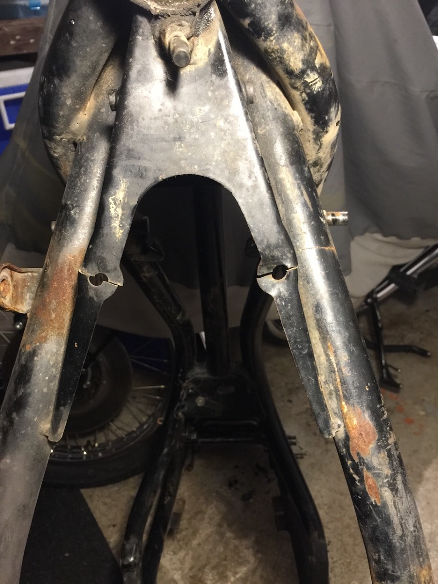

This is an example of what Steve was speaking to. You can see that both bolt holes for the oil cooler have cracked. On the right side (left side from rider position) you can see how the crack went into the frame and was almost all the way around the downtube.
There were several fixes to this problem. The first was what Steve mentioned...a brace was added to the frame across the oil cooler holes. It was a little chicken shit but it was effective in stopping the flexing that would eventually lead to the cracks. The second fix was to not drill the holes. My other Z1B(Jan/75 build) didn't have the holes. If you wanted an oil cooler you had the holes drilled when the cooler was installed. The third fix was a total re-design of the gusset between the down tubes to add some strength. This was done on the KZ900 bikes.
The method of failure was vibration induced fatigue failure. It started at the bolt holes because that was where the frame stresses were concentrated to the highest amount. When a crack developed it would continue across the gusset and eventually work into the frame. The PO of my bike was lucky he didn't have a frame failure while riding. He had souped the bike up pretty good and I suspect he rode it hard.
