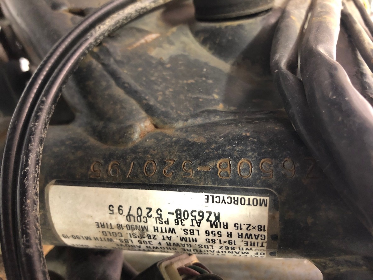

It says KZ650B on frame label. I assume B2 is for 78 (this is what I am finding everywhere)
But online store selectors keep asking if it's B2 or B2A. I "suspect" it's color, but not sure.
Mine is black which probably not original.

So it's a mistery and I will never know if I have B2 or B2A looks like
Change of topic - noticed on picture that label is slightly peeling. Is there any way to remove it and re-attach later? Plan to re-paint frame and that spot won't look good..

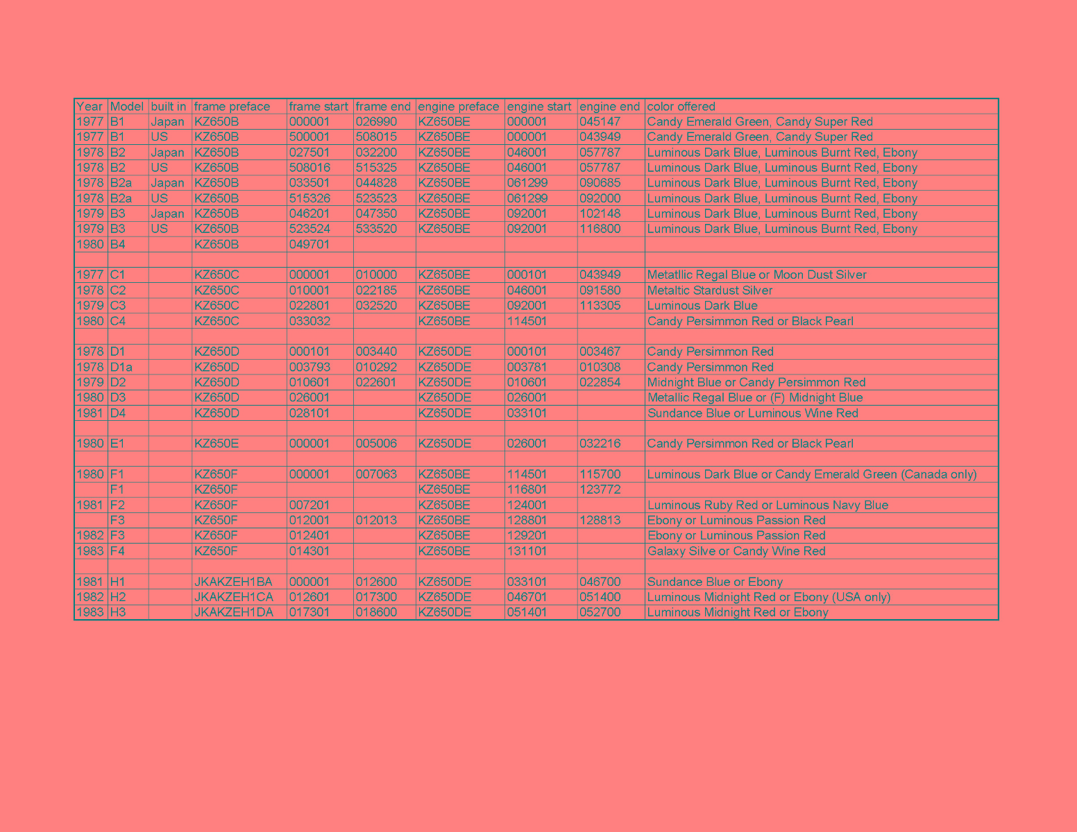

The frame number you posted would indicate the bike is a B2A built in the US. To the best of my knowledge it was offered in ebony. I have attached a table I created in the past with frame and engine numbers I could find. Not saying it is 100% correct but what I could find and make sense of .

30 Dec 2020 09:42gd4now wrote: The frame number you posted would indicate the bike is a B2A built in the US. To the best of my knowledge it was offered in ebony. I have attached a table I created in the past with frame and engine numbers I could find. Not saying it is 100% correct but what I could find and make sense of .
According to your table yes, it does look like B2A.
How did you figure out it's "ebony"? Any pictures of this color scheme?
Another question, is there any difference between units built in US and Japan?
