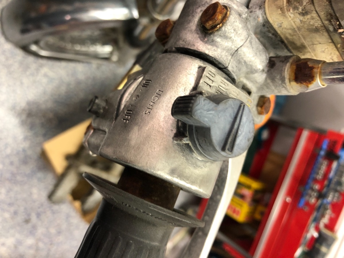

Dr. Gamma wrote: As of January 1st, 1978 by federal law motorcycle headlights had to be on at all times, and stricter emissions standards.
Is that right? How is it that the 1978 Z1R still has the headlight switch? I always thought the switch was deleted for the '79 models. My highest number Z1R is dated 12/77 and it's in the low 8000. They made 17,000 '78 Z1Rs so production must have carried over into '78. It seems like that would have required a KZ1000D1A?
It is possible that the headlight requirement was actually mandated at a later day in 1978, but they were making a running change to the 650B and 1000A for some other reason and decided to incorporate the switch change at that time?

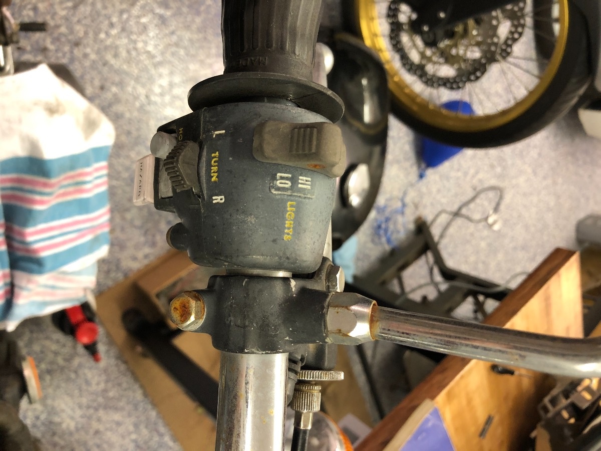

All the info the other guys have posted is correct. 1978 was when they were going through a lot of emissions changes. The B2A was late 78, B2 early. Like mentioned, they changed the carbs from 24mm to 22mm, and eliminated the headlight on/off option. The carbs on the B2 were air jet adjustment, the B2A was pilot jet with the plastic restrictors that kept adjustment limited to about 1/2 turn. Both only came in the blue or orange color. Black was also a rumor, but I never saw a black one to this day.. I still have both a B2 and B2A and can't say the B2A ever ran in any way worse or took longer to warm up. It runs just the same.

31 Dec 2020 08:36The lack of an on-off switch, and the manufacturing date suggest a B2A.
