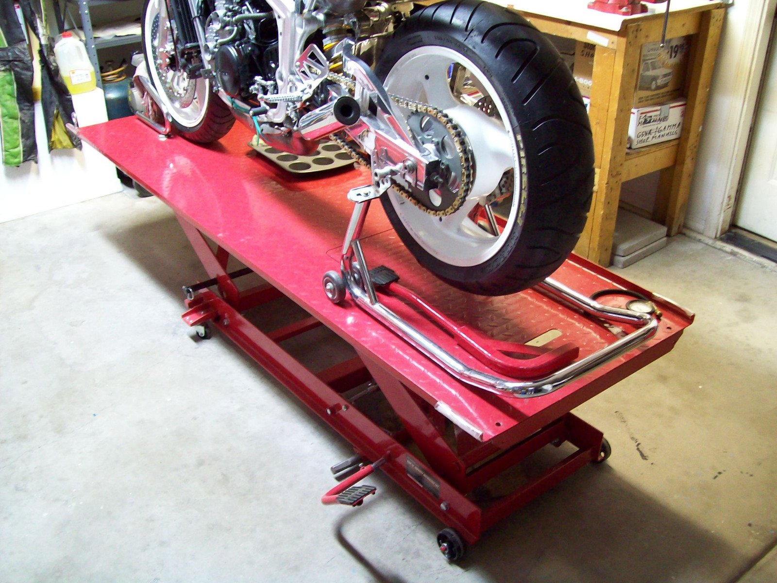

I have been using motorcycle lifts since I started working in a shop back in 1973. The older I got, the more and more I liked using a lift. Even at home I had to have one. Get the adjustable height lift for sure. I have been around both, and trust me you will eventually see the advantage of the adjustable height lift. I don't like any of those big bulky front wheel clamps to hold a bike on the lift. Don't like them because they put pressure on the front disc's. I have too much money in my front disc's to put a big clamp on them!!!! Never lost a bike with the simple wheel chock and two tie downs to the handlebars in like 40 years!!!
Right now I have the budget minded Harbor Freight lift. Been using this for the past 6 years or so. I in the past had Western Manufacturing air lifts. Not even sure if that company is still around. Their lifts were like the Cadillac of the industry. Built like a brick shithouse. You could stand on them and kickstart a bike in the raised position.
Last time I priced one they were like 1,200 dollars!!!!! The Harbor Freight lift will get the job done, but they are not as well built as the Western lifts. I would not climb up on one and kickstart a bike in the raised position. The table will flex when you stand on it in the raised position!!! For the money it is hard to beat the Harbor Freight lift. If you have the big bucks to spend buy a lift like the Western Manufacturing style lift.
The Harbor Freight lift in the lowest raised position.

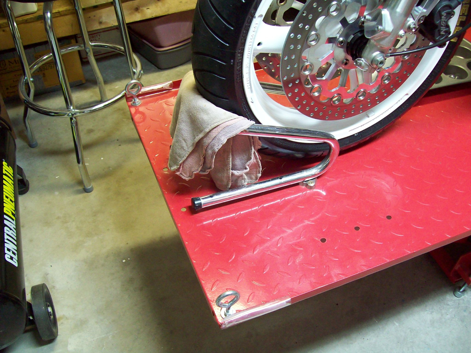

I use a Pingle removable wheel chock and two tie downs to hold bikes to the lift if I can't use a rear work stand on the bike.

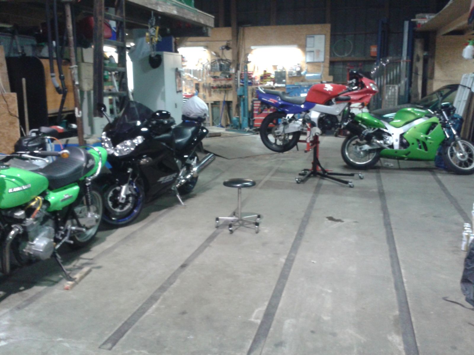

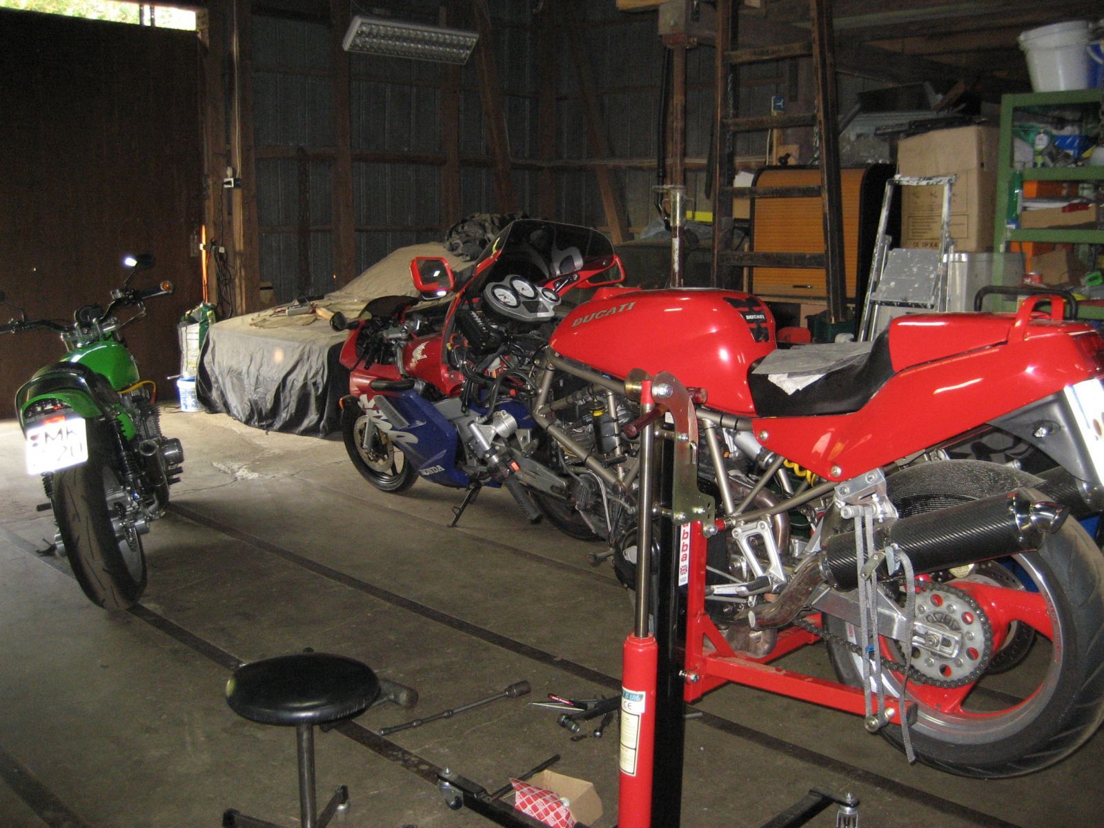

I like my ABBA lift, both wheels off the ground at the same time and you can roll it out off the way if needed.
For me the best tool Investment ever done.

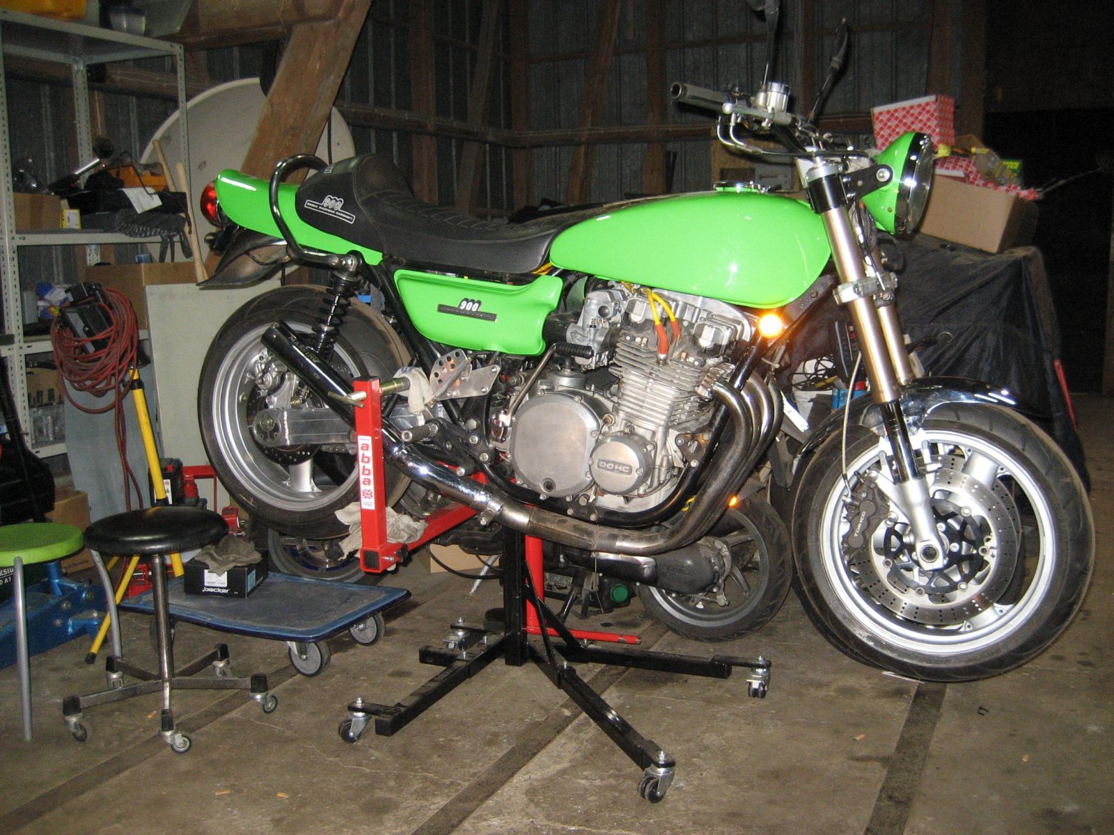

It took me about 3 minutes to attaches the ABBA lift to my KZ ready to lift up.
If my swing arm piviot would hollow bored it took only 1 Minute to setup, like i did on my Hayabusa.
Pics of the Kz on the ABBA stand will follow as soon as possible....

It´s my favorite lift and it´s useful on most bikes, maybe on Harleys scrab metal...
