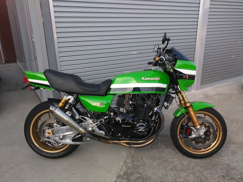

This might give you guys a hint what im looking for. I like The aggresive look with The wide rear wheel.
Last edit: 28 Dec 2019 17:42 by Street Fighter LTD.

I fixed your picture. Next time click the insert tab

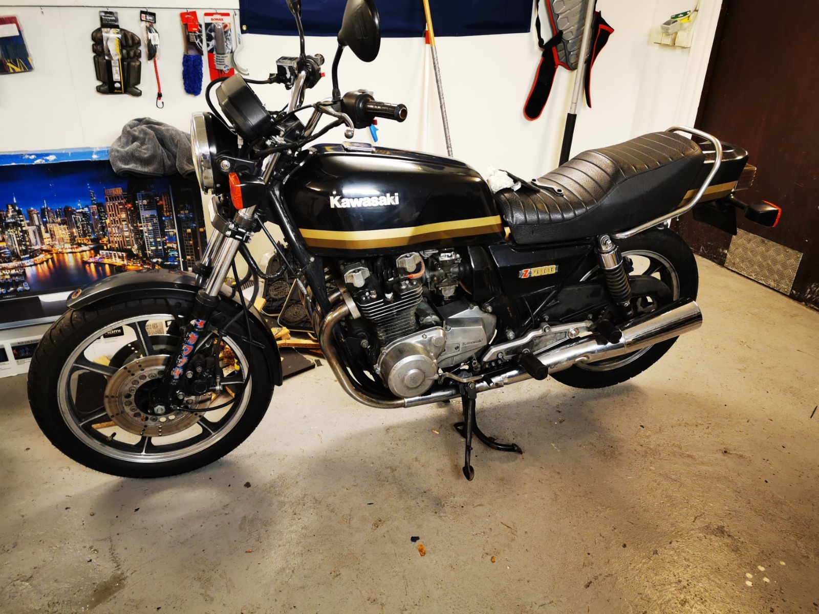

This is my bike. What you say about paint laser blue or almondwhite?
Last edit: 29 Dec 2019 21:47 by Escobar89.

that looks like a clean original bike. any suspension can be made to fit. Depends on how much chopping you want to do. The gs1000r was a race bike and probably not what your are talking about.
Last edit: 30 Dec 2019 02:37 by DoctoRot.

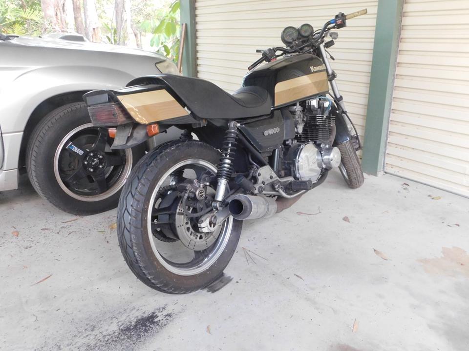

Hi Escobar, I am just popping back up here, have been neglecting my bike for a long time but just getting into it now. I have a GPZ1100zx swingarm, with wheels from the same model. So up to a 140 rear tyre which looks great but I prefer the 130 .
if you want the really fat rear you will want to convert the front to match,.
You don't see many black ones, I say go black again, maybe do something different with stripes.
