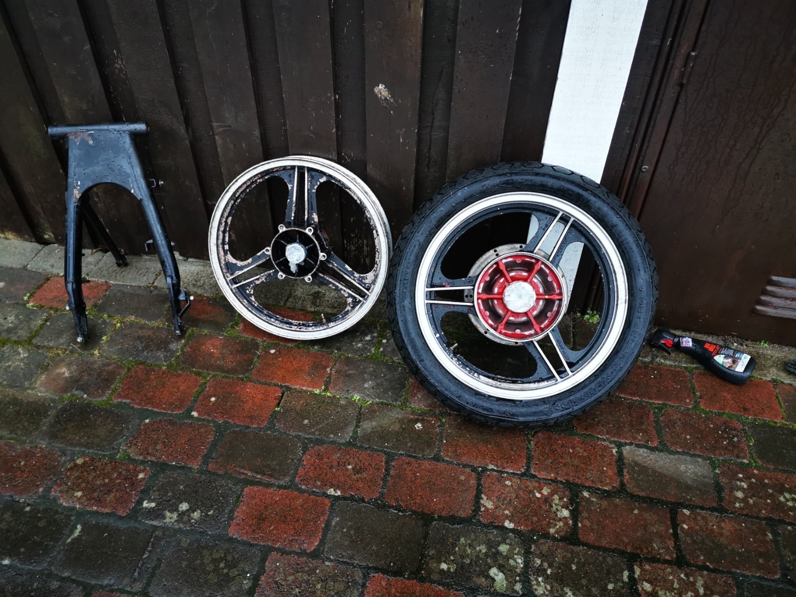

I got the katana swing arm and also bought a set of Gpz750 wheels. Looking forward to see the result

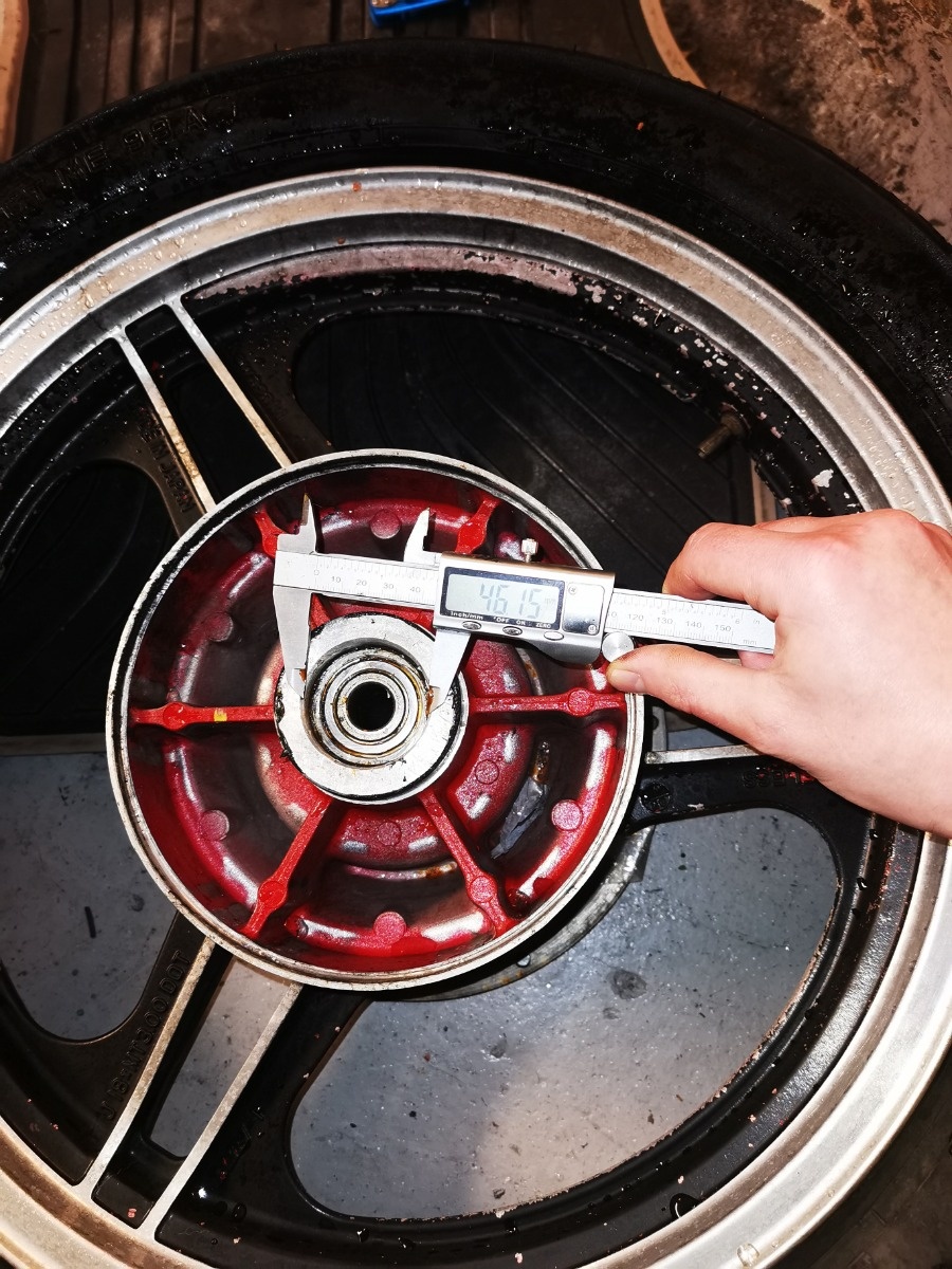

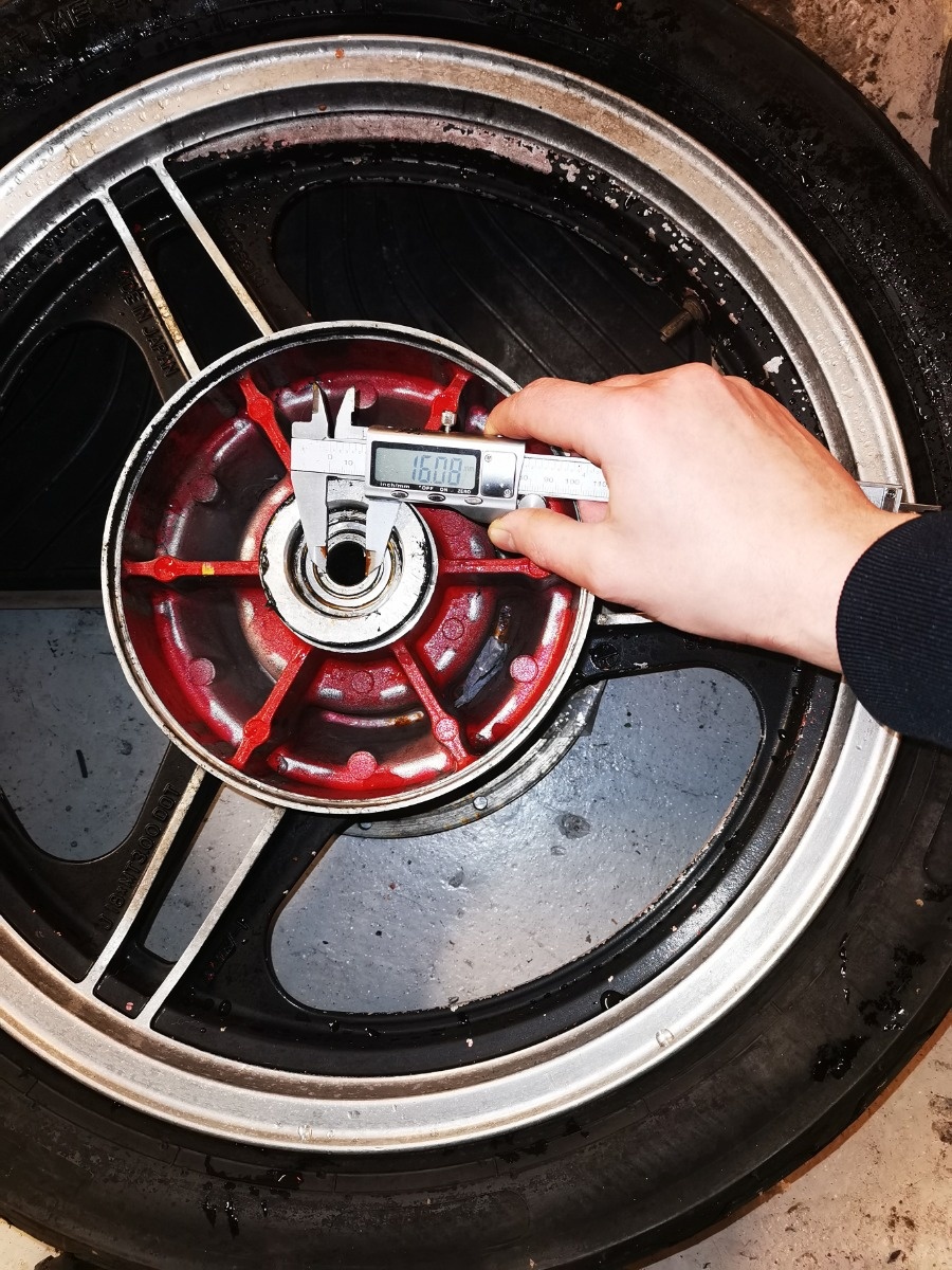

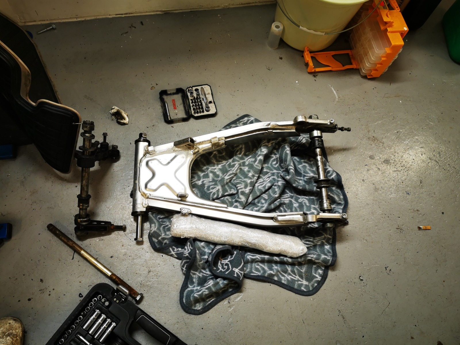

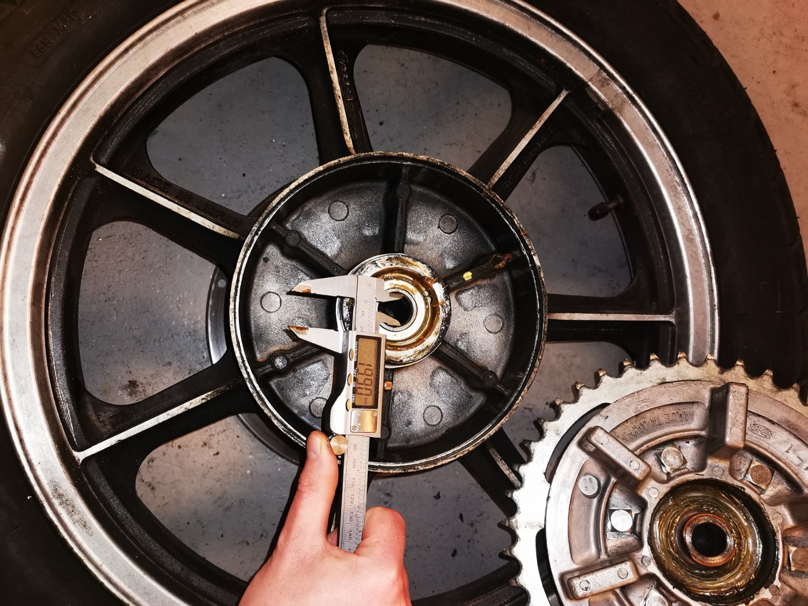

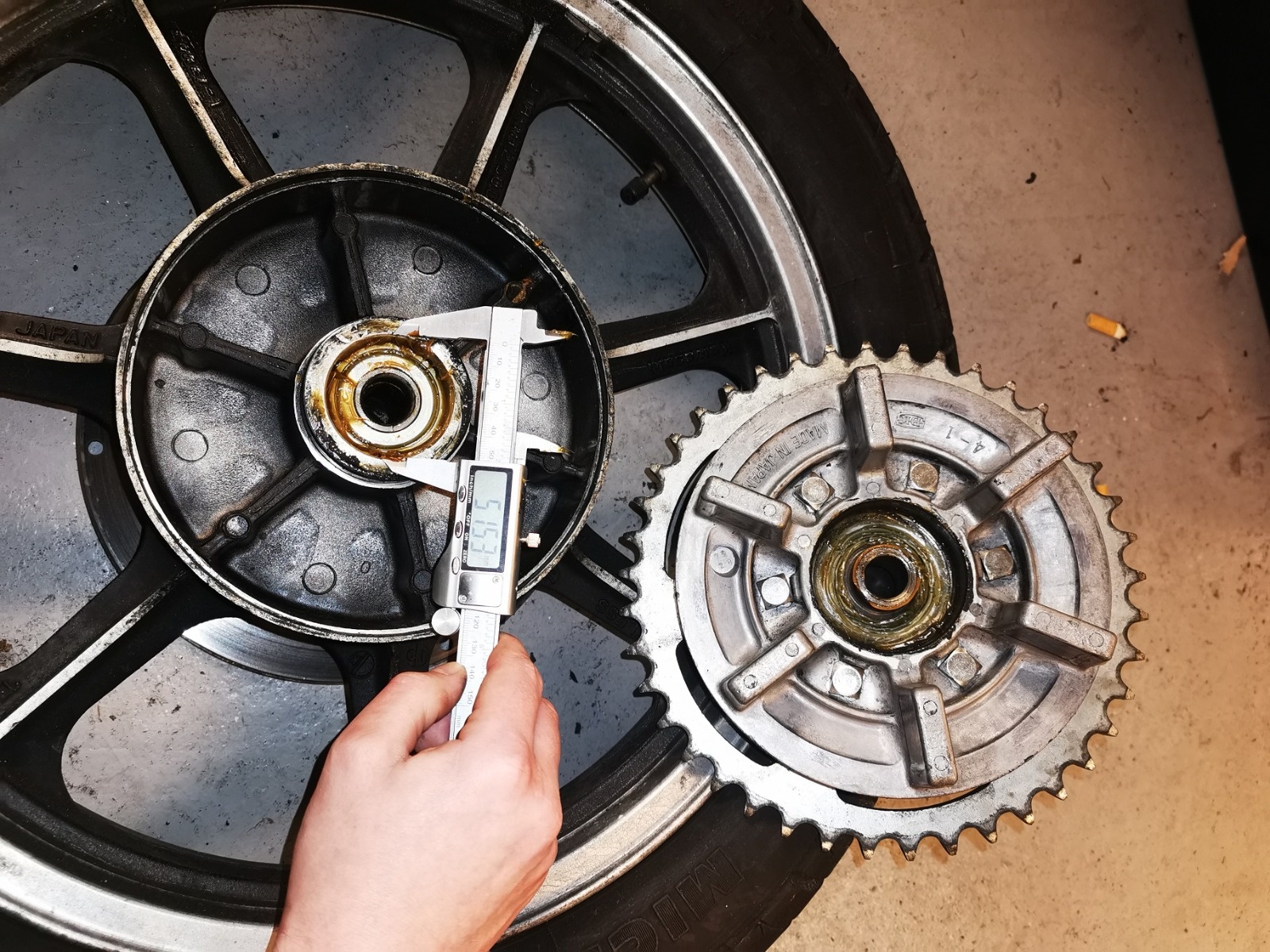

As someone of you guys notified me earlier in this thread, i need some spacers between The swingarm and the frame, it differs about 10mm between original swing and The katana swing, so im going to ask a workshop to machine me two 5mm spacers (38x16x5mm).
The second mod I need to do is to get a another wheel bearing for the gpz wheel since the pivot for the rear wheel axle has has a smaller diameter.
Please let me know if you guys has any other inputs!
Cheers!
Cheers!

Save money on the S/A spacers and just use washers.
