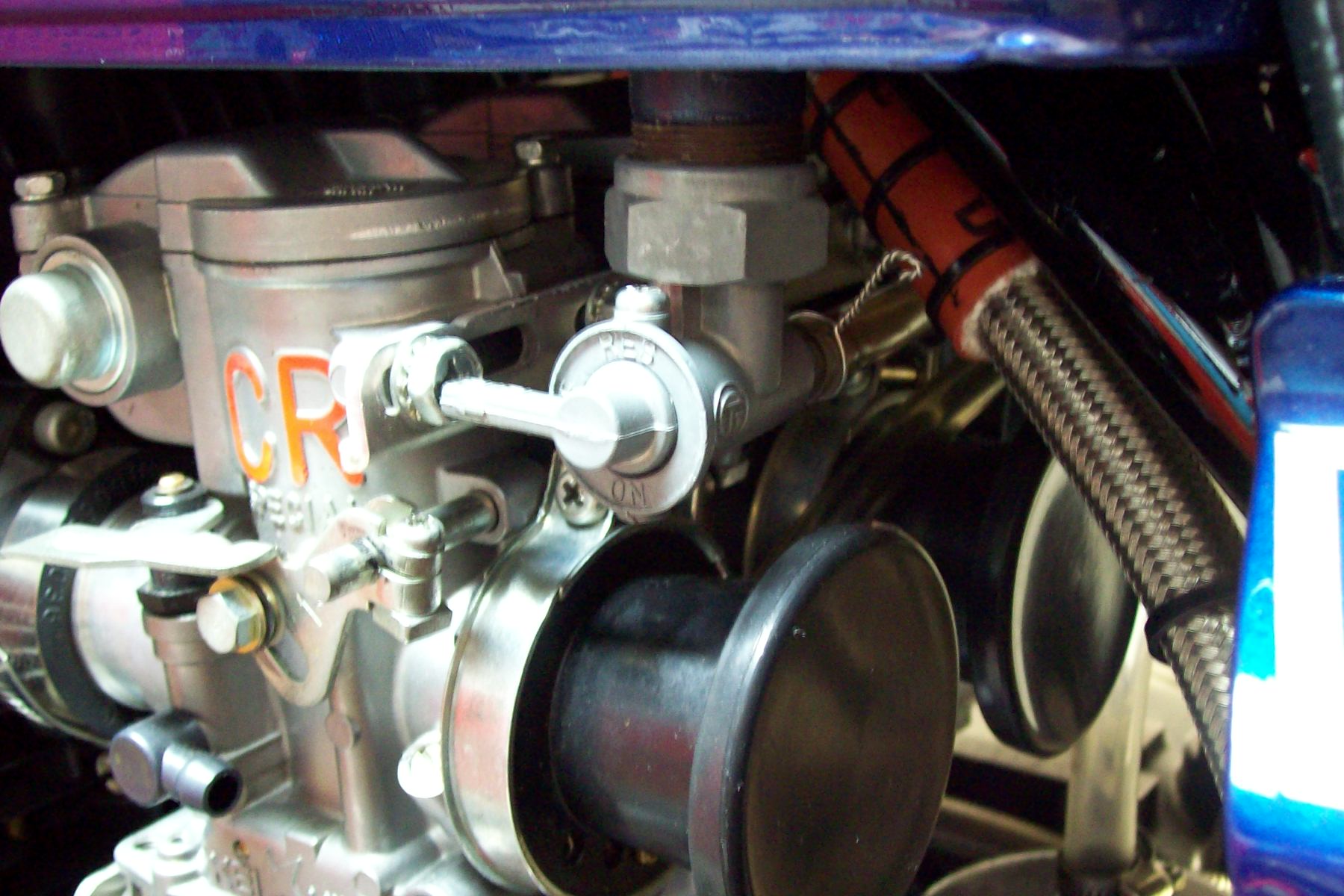

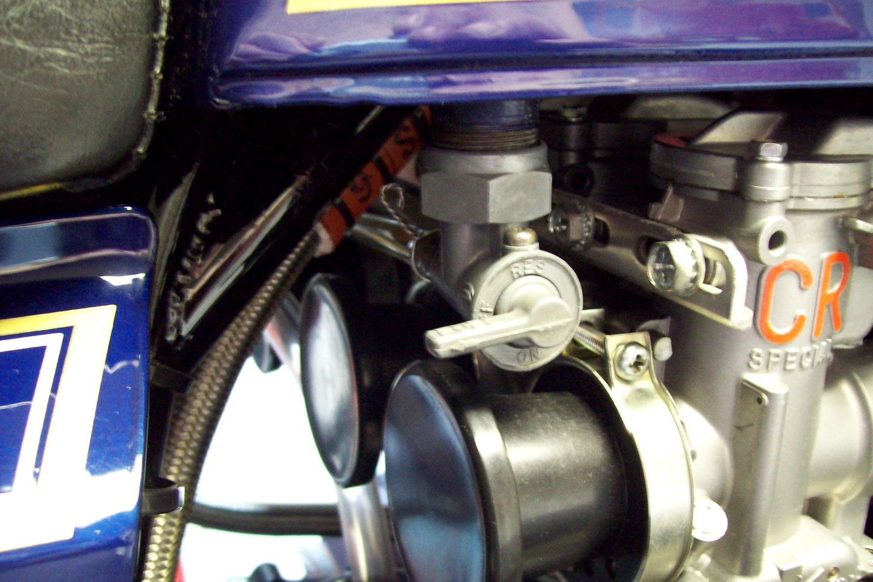

Most of the early Kz900 and Kz1000 fuel tanks will not empty all of their fuel completely. Even on reserve some will not drain that last 1/2 gallon or so of fuel. What I did on my Kz1000 fuel tanks was weld in an extra early model petcock piece that the petcock mounts to on the right side of fuel tank. I also move those petcock mounts as far rearward on the tank as I can too. With the petcocks on both sides of fuel tank, they pickup ALL of the fuel in the tank!!!! There might be an ounce or two left in the tank, but thats it!!!
Left side petcock mount moved rearward with Z1r petcock.
The extra right side petcock mount welded to tank which is also moved rearward on tank with Z1r petcock.
