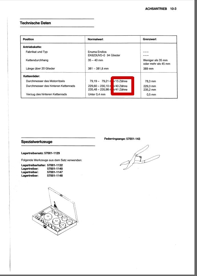

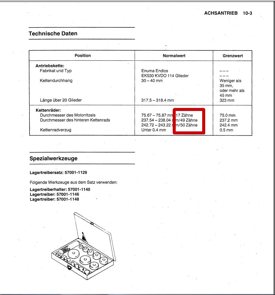

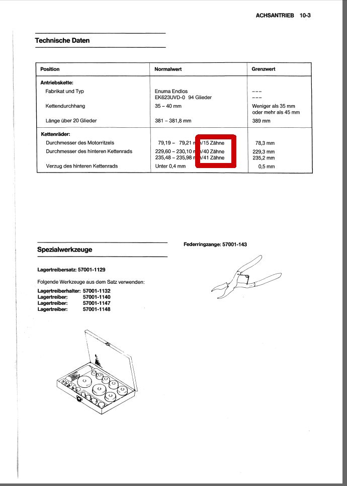

Re: I'm so sorry
18 Jun 2019 13:22
The GPZ900R max. Speed is round about 250 Km/h = 155 mph under optimal conditions with a single driver!!!
You shamal do 140 mph in 4th gear!!! Sound like you drive with the wrong front/rear sprocket setup (secondary gear ratio)???
GPZ900R front/rear sprockets 17/49(50) = 2,88 to 1
GPZ1000R(X) front/rear sprockets 15/40(41) = 2,66 to 1
Just a thought...
Just a thought...

18 Jun 2019 14:08
No i have a new did set 17/49.. I really dont know what can i do. Its very frustrating on the highway hitting the 7000 rpm limit..
