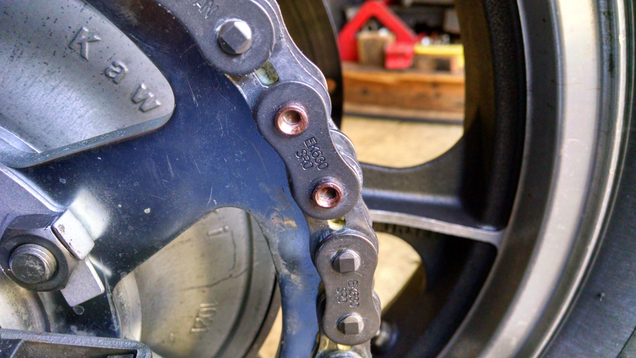

I went from a 15/41 with a 630 chain to a 18/42 with a 530 chain. Acceleration is still brisk but the freeway rpms are much lower. There are a few threads on KZP gearing on this forum.

Heh, my 750LTD has a 630 chain out of the factory, and a mechanic friend of mine was like "but why? this is a drag chain"
Is there any benefit to the smaller 530 chain other than a slight reduction in weight? I ask because my 750 snapped its chain once... It was a brand new chain and it just tore the master link clip on hard acceleration... and this bike has even more power.

I'm keeping my 630.

There are more quality choices in modern 530 chains, and yes you loose some reciprocating weight. If your 750 snapped a chain, it was either a cheap or terribly defective chain, or the master link was not installed properly.
A KZ does not make enough power to snap a high quality modern drive chain.

I didn't think a kz could snap a 630 either but none the less it did. I think i may have been too tight. I figured the wheel would spin if that much torque were applied.
The next chain i put on it lasted a long time.

As texaskz stated, it had to be a cheapo master link. I go to great lengths to make sure any link I put in my chain is the same link that the rest of the chain is made from. Also I feel that riveted chains master links are stronger that clip type links.
