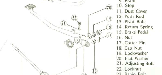

On your back brake, have you checked to make sure that the adjusting bolt( # 21) hasn't come loose and spun out ?
That would cause the master cylinder to not release.
It happened to me.
As far as the front brakes try some fresh fluid.
