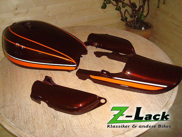

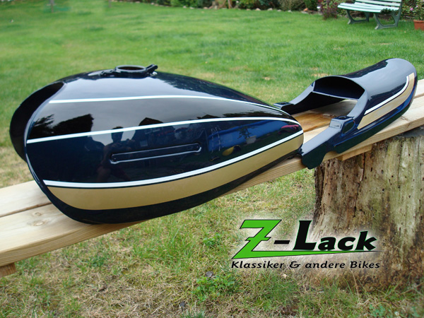

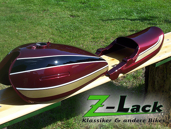

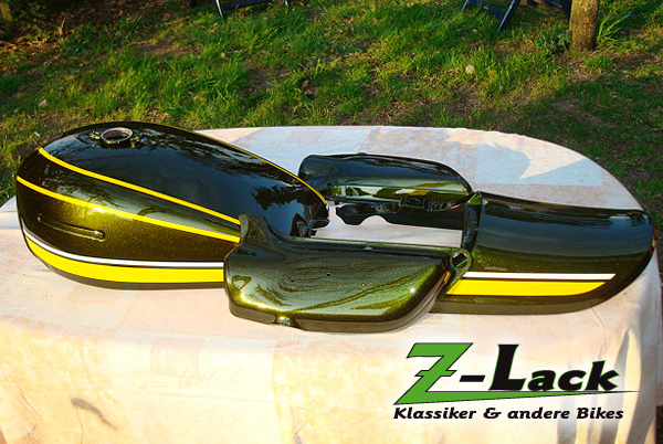

Do you have any pics of the bike?
A shopping guide, sorry only in German language.
Z1 74 color set
Z1A 74 color set
Z1B 75 color set
Z1 74 color set
Z1A 74 color set
Z1B 75 color set
