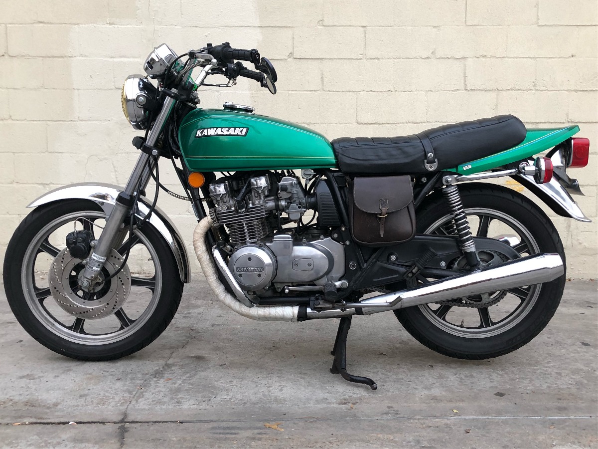

1977 KZ650. Its a great bike. I have other bikes but this one is a blast.
I have a problem I cant figure out.
The bike has been fine. However. when Im stationary., like at a light, or whatever, the bike WILL NOT shift into neutral. As a matter of fact, no matter how much pressure I use with my foot to upshift it, it will NOT go into neutral. When the bike is moving, its a bit easier.
Is this a clutch adjustment issue or worse? Bike shifts fine through all the other gears but neutral is a problem.
Oil is regularly changed and the bike is maintained well. Any ideas?
Oh and it shut off on me twice today when trying to get into neutral...on the road. How embarassing. had to kick it to start it again.
