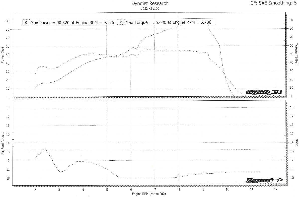

The wires are ok since they are wire-strand copper core, but decided to get another set of resistor caps from the UK...nice-new red ones.
That faulty cap may have been causing an issue during the dyno session. Scott said there was something causing electrical interference with the system as he was running it. :pinch:
May have to take another ride on the dyno. After this simple fix and revised carb jetting, the engine runs incredibly better. :woohoo:
With 127.5 main jets (vs. 132.5), I'm using more throttle rotation range, and the roll-on response is faster-crisper, but yet without pops and spits, even after raising the needle-clips to the third notch. I may go smaller yet with the mains, to see what effect that has, but with dense-warm air ahead it may be good as is. These RS carbs are a trip.

26 May 2017 21:40 - 26 May 2017 21:43I'm a little surprised at, under 56ft lbs of torque.
Is that normal?
And that A/F ratio looks way to rich to me above 5Krpm and will be worse as the weather warms up.
Is that normal?
In a half-arsed feeble attempt to improve it, I've changed main jets from 132.5 to 127.5 and lowered the needles one notch to the 3rd clip-space. Pilot jets are 120, and I switch air jets (between .07 and .08) depending on the air temperature and humidity.
Not sure about my approach, but the engine seems to like it better...
With little other than you guy's advice, I rely on my general ability to figure out how things work...and beyond-obsessive tinkering.
Professional dyno-tuning would certainly make more cents.

31 May 2017 08:12 - 31 May 2017 08:22Street Fighter LTD wrote: Hi Dave
Glad bike is improving
One word on this though
. Changing to many tuning variables at once can make it hard to pinpoint what causes
a good or bad change in performance..
Dave![]()
Still experimenting...
Then: 132.5 Main Jets, 120 Pilot Jets, .07 Pilot Air Jets, 4th-Clip on the Needle
Now: 127.5 Main Jets, 120 Pilot Jets, .09 Pilot Air Jets, 3rd-Clip on the Needle
Better...but best
Should I go leaner til it pops...perhaps 117.5 Pilot Jets?

31 May 2017 08:17daveo wrote:Street Fighter LTD wrote: Hi Dave
Dave![]()
Now: 127.5 Main Jets, 120 Pilot Jets, .09 Pilot Air Jets, Center-Clip on the Needle.
Then: 132.5 Main Jets, 120 Pilot Jets, .07 Pilot Air Jets, Second-Clip on the Needle
Better, but best...
...go leaner til it pops?
So next try a free change ( No parts needed ) which would be to lean out needles one notch and see what happens .
Give it a try
'Dave
- daveo
- Posts: 3088
- Thanks: 848
Re: Dynamometer Appointment Scheduled
31 May 2017 08:25 - 31 May 2017 08:33
Thanks Dave!
Do you mean drop the needle further? :ohmy:
Does changing the baffle from Street to Competition have a similar effect, or does that negate everything and create chaos?

- Posts: 5053
- Thanks: 2257
31 May 2017 09:49
Drop the needle down. So put the clip up one notch ( Seems ass backwards , but think about it ). This will lean out fuel mixture some.
If runs like crap go the other way and see what that does. Worst case is you put needle clip back where it is now. Put what ever baffle in the pipe you plan to ride with or you may be doing this all over again .
Unless racing professionally I like my jetting a taste fat ( rich ).
