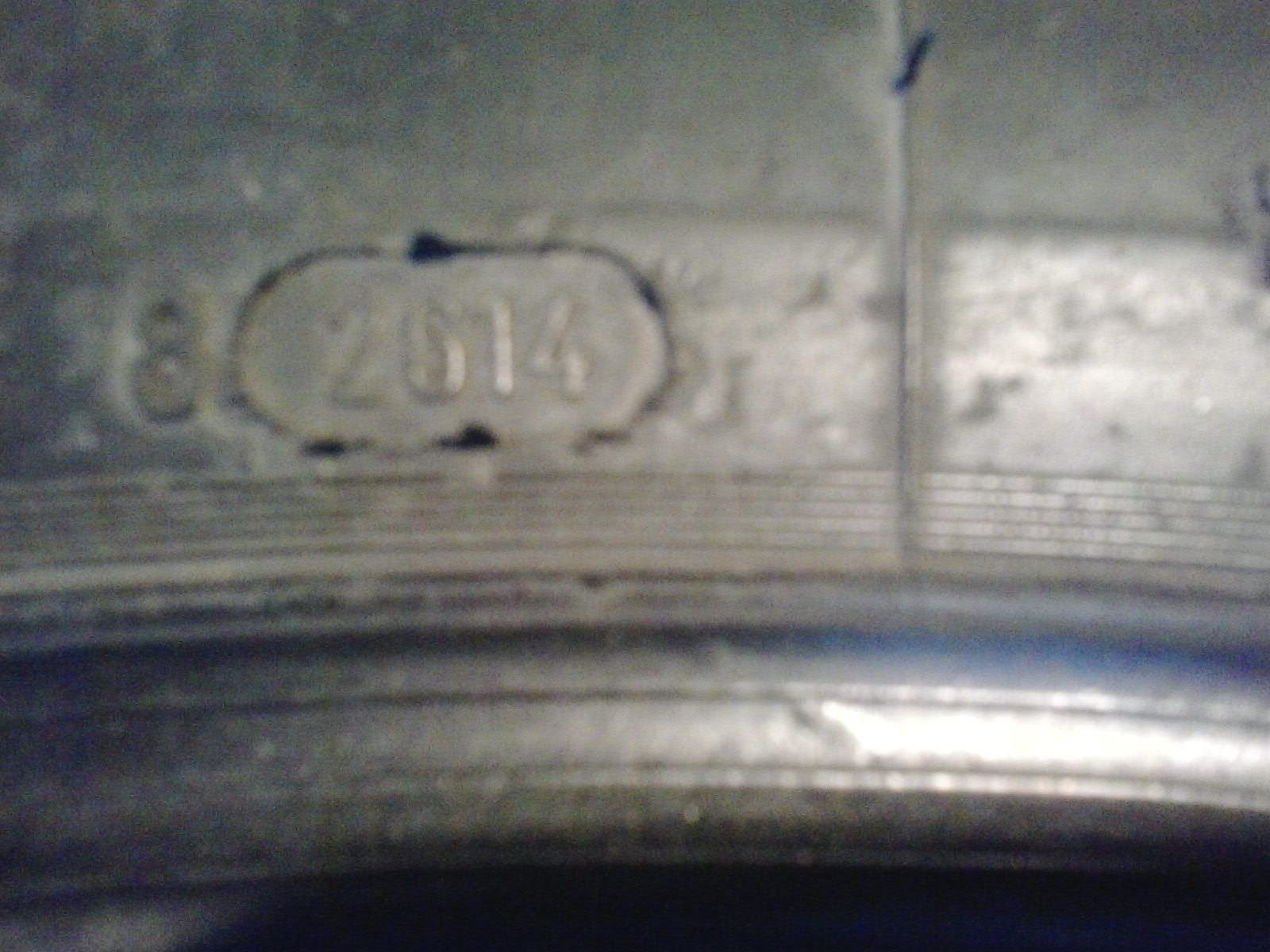

Who put the tires on?
What are the dates on the tires?
Check them for balance and trueness
Tires have lines were the rubber meet the rims, make sure they are seated evenly on both sides all the way around
Modern metric equivalent tires don't all seat well on these old 18 and 19 inch rims, my son picked out some tires for his 650 and I could not get the rear tire to seat right
A out of round or poorly balanced rear tire can make your front end shake
Here is a picture of an Avon Roadrunnrers manufacturing date (26th week of 2014) and the lines underneath , sorry for the crappy pic :blush:
