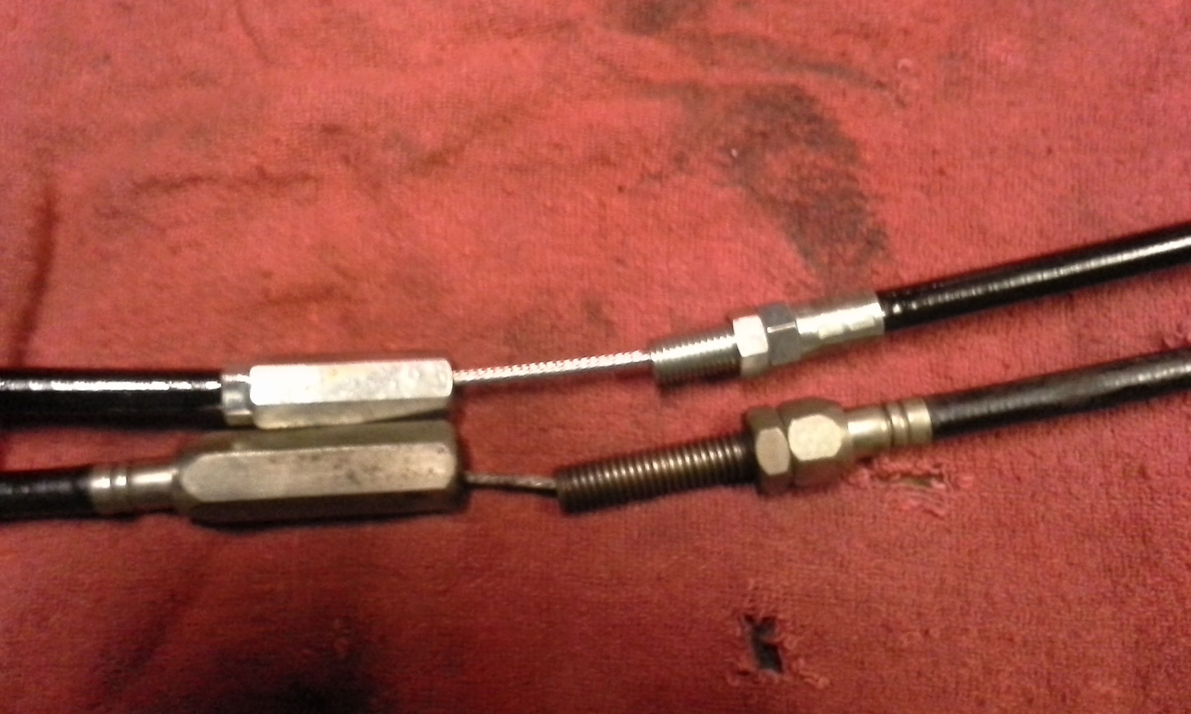

With the mild winter I had the 73 beater bike out a few times and noticed the clutch cable fraying at the perch. Instead of grabbing a good used one I ordered a new Motion Pro. At $12 I should have known it was going to be a piece of crap and i was right.
The adjuster is narrow and not enough threads to properly adjust the clutch. I Thought maybe I was doing it wrong and even got out the Z1 series manual and followed the proper procedure, like it's rocket science lol
I ended up grabbing a good used one and the new motion PRO will go in the junk bin. I would say it might be usable in an emergency situation( to get you home) but you would have the have the adjuster at the perch all the out and that wouldn't last long.
Here is the pro compared to oem

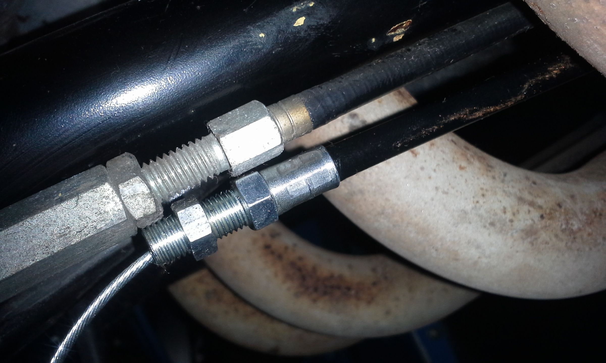

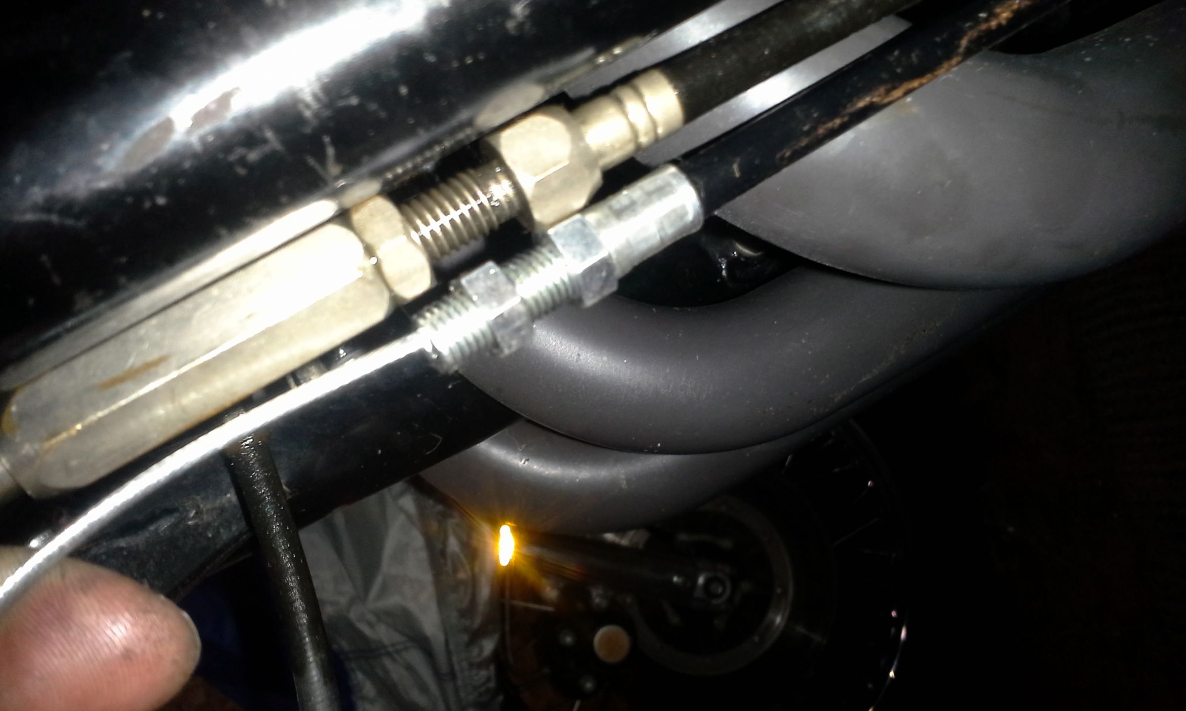

properly installed on Z1
I also compared it to my kz1000, same result, not enough thread. Thanks motion pro

Yup mine too. I used a couple washers at the case to give me more adjustment room. I'm convinced it's another marketing ploy. Runs out of adjustment then John Q Public will buy another one.

Perhaps the MP has a longer unsheathed inner cable than does the OEM cable. Which would necessitate more sheath extension via mid-adjuster and/or perch adjustment.
This might be shown on the first image posted with the red background.
How does length of unsheathed inner cable compare between MP and OEM? (At shortest sheath length with both adjusters fully closed).
If length of MP unsheathed inner cable matches length of OEM unsheathed inner cable, the only difference would be amount of extension provided by the mid-sheath adjustment and perch adjustment, which if insufficient on the MP would be unacceptable.
A closer gap in the clutch pushrod adjustment might reduce the sheath extension needed at mid-cable and perch.

29 Feb 2016 08:11Patton wrote: Perhaps the MP has a longer unsheathed inner cable than does the OEM cable. Which would necessitate more sheath extension via mid-adjuster and/or perch adjustment.This might be shown on the first image posted with the red background.
Not sure what you're trying to explain, you sound like a politician. In the real world it's a $12 clutch cable that non usable. Period
