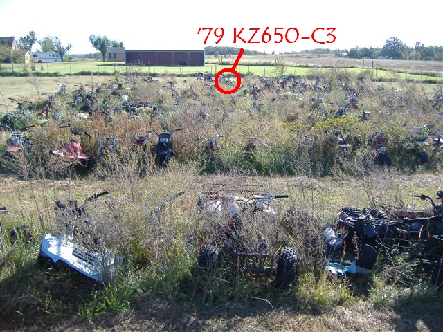

At any rate, I remembered I have an old '78 kz650 sitting in the shop, completely dismantled down to the bare engine still in the frame and that's about it.. I got this old beast at an auction up in OK a few years (argh ... again) ago for just $10 because it was near the end of the day and no one else was bidding. Well, that and it is an ugly bike due to sitting outside for a while:

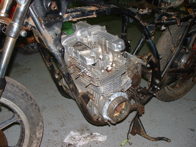

So I ultimately, stripped it down to the bare bones:

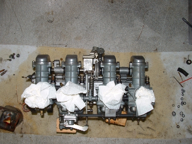

Then... well, life happened and I forgot about it. It's sitting in the shop still (several hours away) and pretty much covered in blankets and plastic. The plan was always to rebuild it in a custom resto-mod; I'm thinkin' like a silver frame and black tank and skins. I started rebuilding the carbs way back when:

So the question... What is the bare minimum needed to fire-up and run the engine in the stripped down frame?
I'm talking back-woods engineering here.
Like I wanna fire that engine up with the absolute minimum of needed parts.

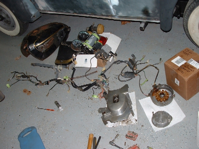

As it is, the entire wire loom was removed and most of the engine parts that weren't permanently rusted on:
So what would I need?
Rigged ignition switch...check.
Coil packs...check.
Exhaust...check.
Fuel, gas can, atomizer bottle...
Anyone ever tried this before? I'd like to know how it went....
Coil packs...check.
Exhaust...check.
