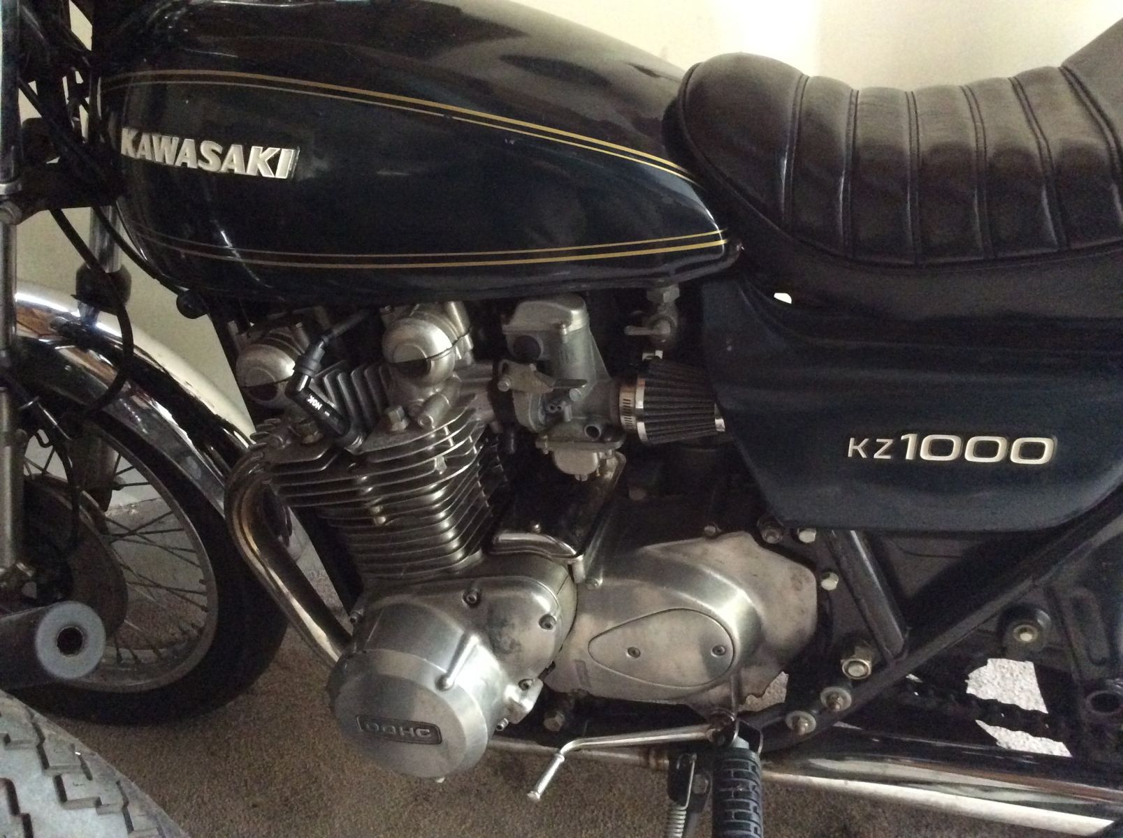

The standard had spoke wheels and flat seat, much more classic looking imho! Here's a pic of my 77 1000a ( it's got the saddleman seat so a standard comes with flat which I'm getting soon enough) also the pipes are not stock...
