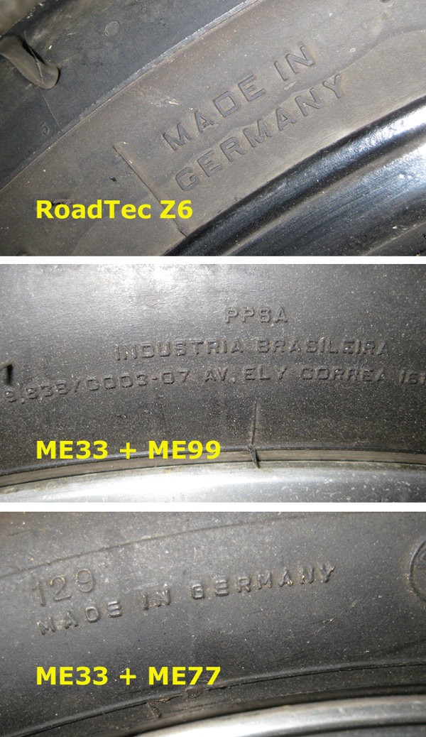

08 Sep 2015 06:02 - 08 Sep 2015 06:12rhityx02 wrote: Not to offend anybody who are the Metzeler likers but...it would seem that a company that does nothing but motorcycle tires would have a better quality control system in place no matter where they are manufactured. Cracks small or big in the side of a motorcycle tire is enough to make me second guess buying the Metzeler brand. But that's just my 2 cents.
Ty
I completely agree, no matter where a tire is made it shouldn't start to crack - however, moving production abroad is most often done to cut costs which often leads to loss of quality,some times due to lack of qualified employees or a difference in work ethics. The company I work for has some goods manufactured/assembled in China and I have seen some stuff slip through their quality control that I wouldn't have approved.
My RoadTecs are Made in Germany as I said, but it turns out that one 650 set (ME33 + ME77) is Made in Germany, while the other set (ME33 + ME99) is Made in Brazil, these are the ones currently on the bike.
I just inspected all 6 tires thoroughly with a flashlight - the ME33/ME77 set is worn out and was removed from the bike 10 years ago when I swapped to cast wheels, just never bothered to remove them from the rims. The ME33/ME99 are currently on the bike though they are getting a bit ripe. Even though both sets are well past their prime there are no cracks or dry rot whatsoever and apart from one set being dead from age and use I can tell no difference between Made in Germany and Made in Brazil.
Btw, both sets are Lazers, not LazerTec.
Likewise the RoadTecs came out spotless, which they should being only a couple of years old.

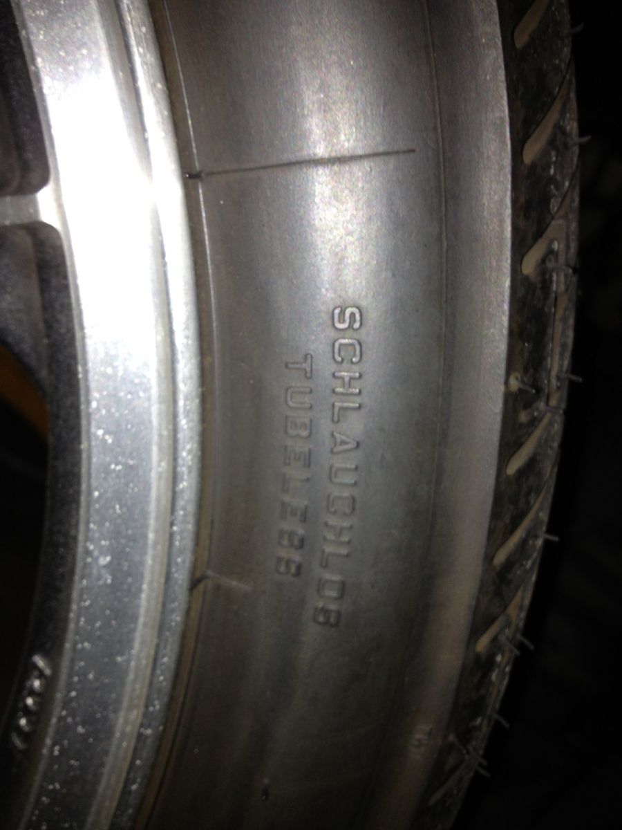

Pete, you're right, sclauchlos is German for tubeless - my Made in Brazil tires say that too.
Might add that I'm not on a mission to defend Metzeler, I have no reason to, but this is the first time I have ever heard about these problems after happily using Metzelers for many years. I paid good money for my tires, the set of RoadTecs cost me $450, so if there really is an issue with new Metzeler tires cracking I definitely want to know about it before buying them again.

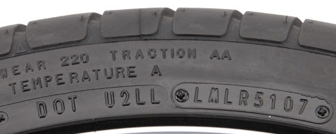

Don’t take me wrong, I am don’t worship Metzler in any way, but if your tires crack up you must have been cheated.
Have you checked the mfg dates on your tyres?
What I know the ME33 and 99 haven’t been in production for quite some years by now so they might be really old by now. Lots of rubber dealers don’t care much as long as they can clear their stock. I always check mfg dates before a buy.

08 Sep 2015 08:29That "is" German for tubeless.....

08 Sep 2015 08:41Danke, mission,... that's Thank You in German,
