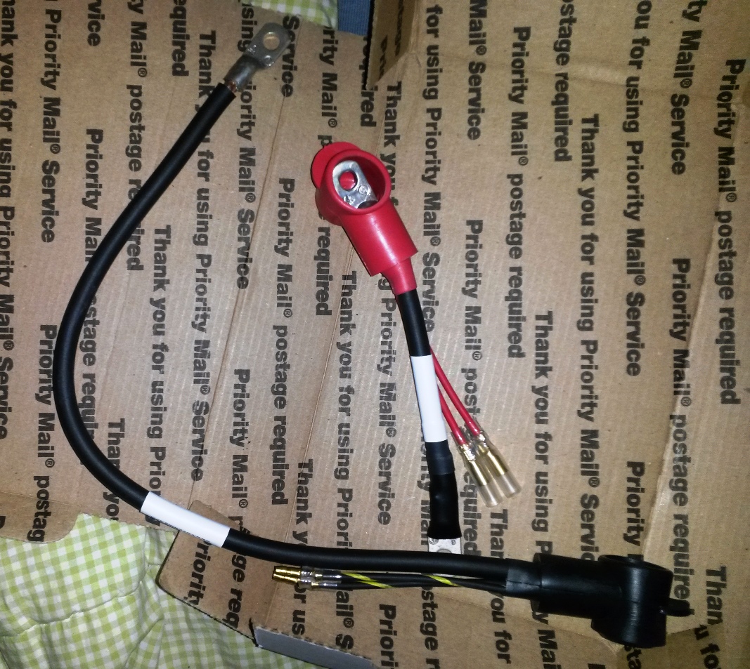

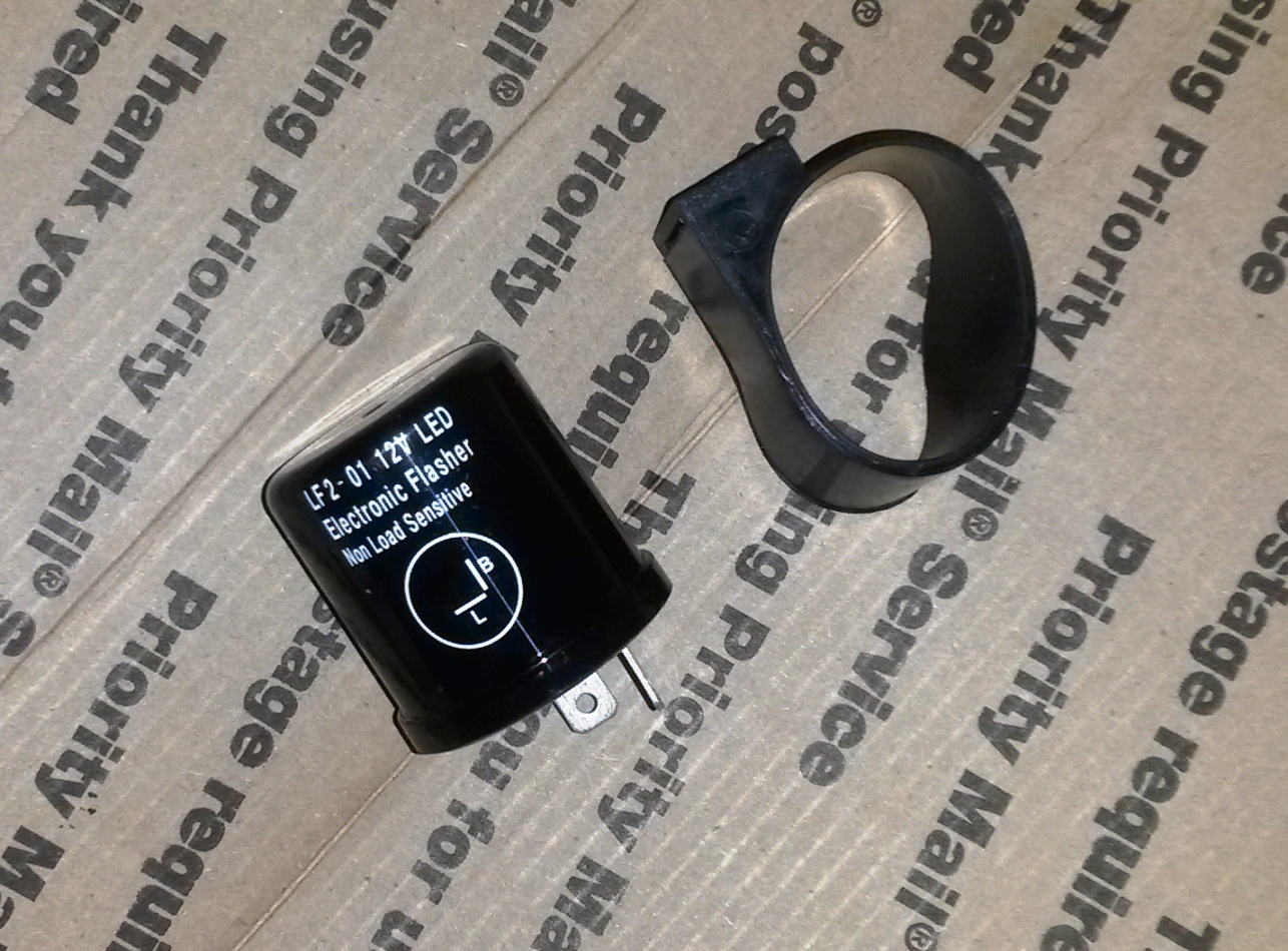

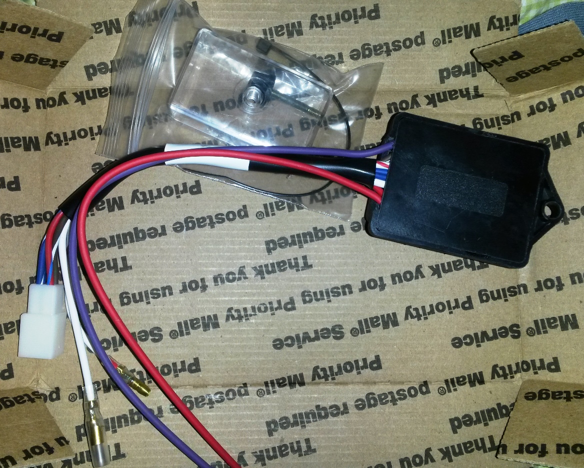

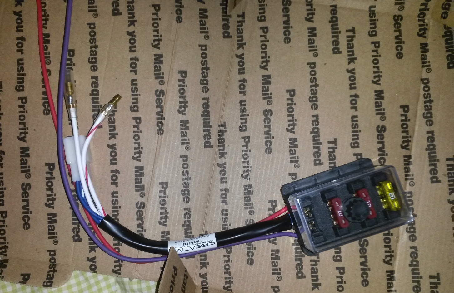

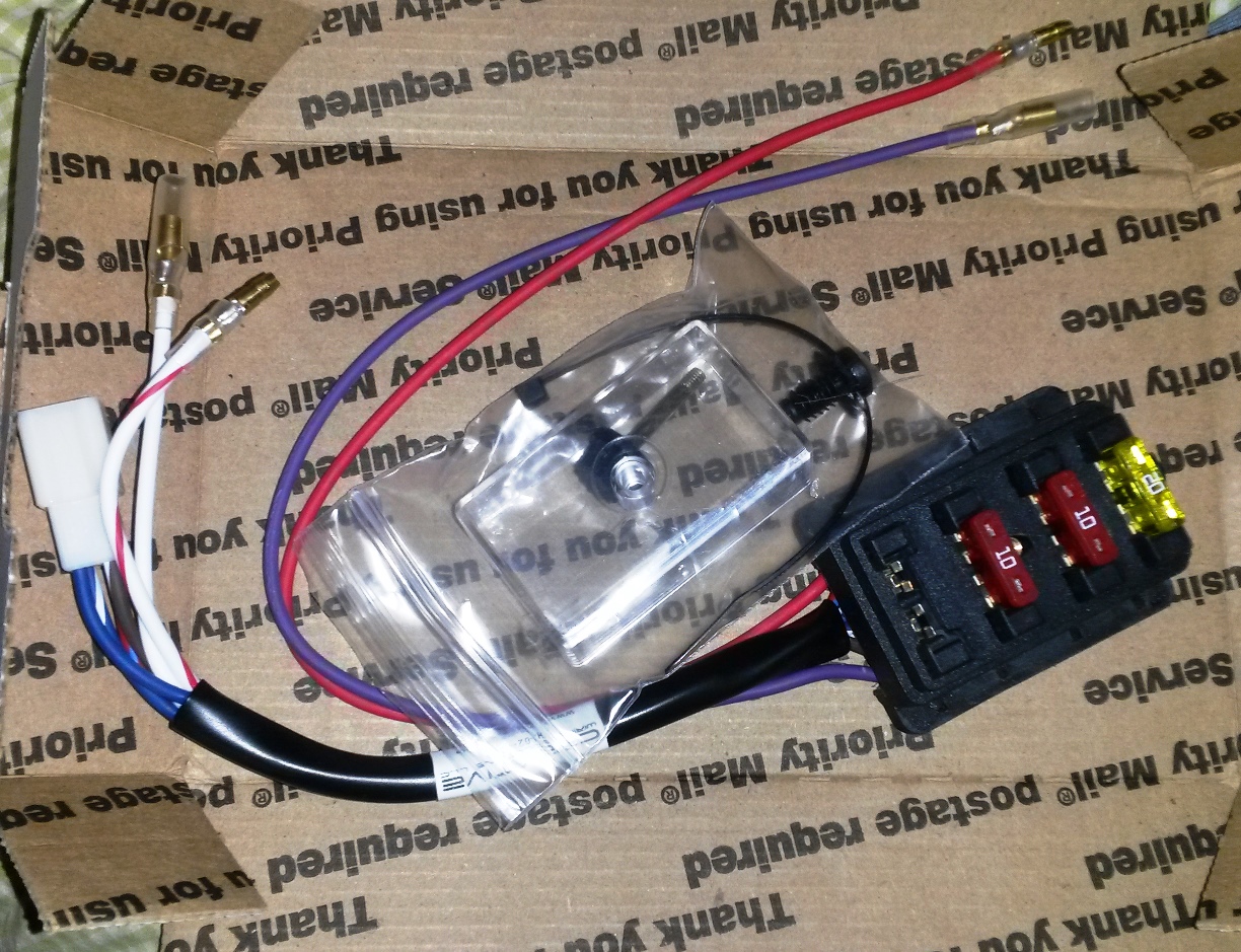

I got the order in today and the box looks real nice and well put together. It's much nicer job than I could have done. I also got the battery harness and a non load sensitive flasher i.e. LED/incandescent compatible.
Some quick pics and I'll try to get them installed this weekend.

I went out to see if i could just hook up the fuse box last night and ran into a snag. My factory fuses are hard wired. The bike really doesn't have fuse box/block just a plastic box that covers the fuses and keeps them together and prevents them from touching. No worries I'll just have to hard wire the box in, I'll just use butt connectors for now but I'll solder them in eventually.
I put in the flasher, works fine once i reversed the wires from the OEM one I don't have any LED lights installed yet so we'll have to see if it works with both types wired in. I figured out there was once a hazard flasher but it's gone. I tried pluging in the old flasher to it but it didn't do anything. I looked up the parts diagram and they are different part numbers, I don't know what the difference is or if that was the issue, might have wiring issues too.
I haven't put in the battery leads yet, Maybe today, I took the day off.

OK, I couldn't stop thinking about it and I went out and put the battery leads on. These cables are much heavier gauge and a bit stiff and I had to bend the ring ends a bit on the battery end to get them to my posts.
I ended up putting the positive on backwards, It fit better and the boot covers the solenoid connection well, it wouldn't be useful on the battery end at all. The boot's much bigger than the original and doesn't fit under the wiring cover. Since the fuse box isn't going to fit under it either I just removed it. There was a lead hard wired to the original cable into the [regulator. I clipped it off at the double bullet connection, one end to a 10A light fuse other to the accessory fuses, put on a weatherproof ring connector and put it under the battery lead on the solenoid.]
The negative went well too. It's just barely long enough to hook up to the original ground point on the block. I took the boot off since it also doesn't fit on the post style of my battery. There are 2 ground leads that come off the battery end that have male bullet connectors which facilitates the deletion of a loose ring connector that was attached to the negative post and fed into the harness with an identical male bullet connector.
I'm going to hold off wiring the fuses since it's nice today and I'm going to go for a ride. It's supposed to be stormy tomorrow so maybe then.

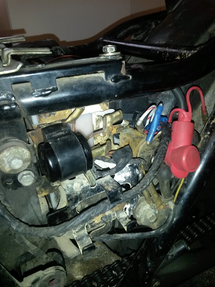

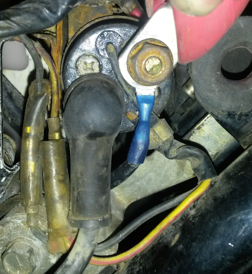

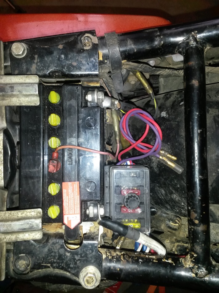

Everything is in and functioning. I haven't gone for a ride yet but I've tested everything electrical I can think of with the bike running and not running. I butt crimp spliced all the fuse wires with weatherproof connectors. except one male bullet connector for the 20A circuit which plugged right into the positive female pigtail.
The box wouldn't fit under the side cover so I put it behind the battery just under the positive cable zip tied to the old electrical cover screw hole. You can also see the negative cable bullet connector.
pic of the flasher and the positive cable at the solenoid. you can see the harness wires and butt connectors. And the missing hazard flasher. I still don't know what that's about.
The ring connector for the regulator.

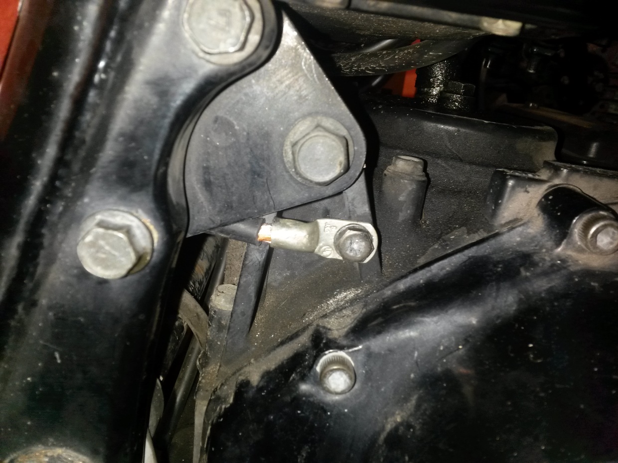

The negative ground to the block.

- zukdave
- Posts: 1678
- Thanks: 227
Re: Creative Wiring Solutions, LLC.?????
23 Apr 2016 15:25
Not talking shit but ya'll ain't got a car wash close ?
Can of engine cleaner and a hand full of quarter's go's a long way.
