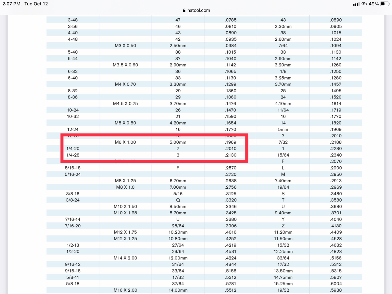

Steve, you mentioned 1/4” drill for an M6 bolt. That is to big.
www.natool.com/wp-content/uploads/2019/0..._web_catp113-116.pdf
