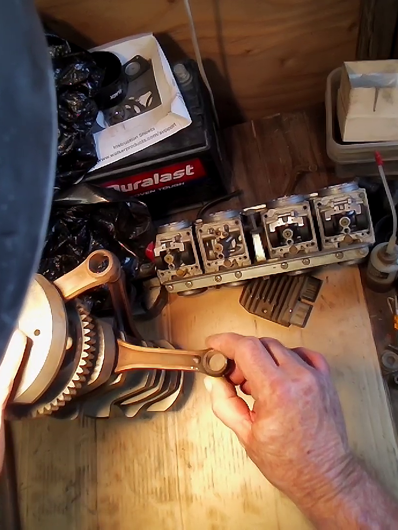

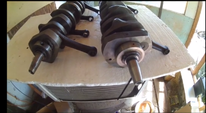

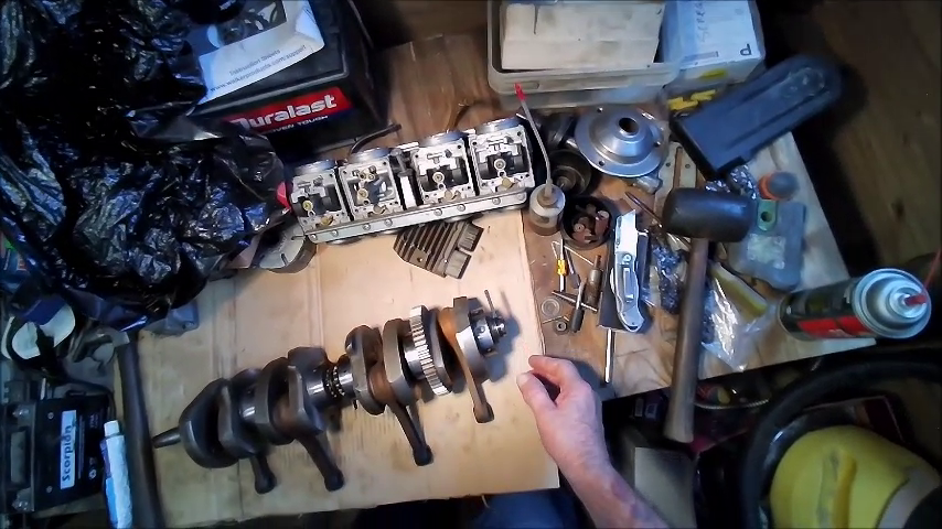

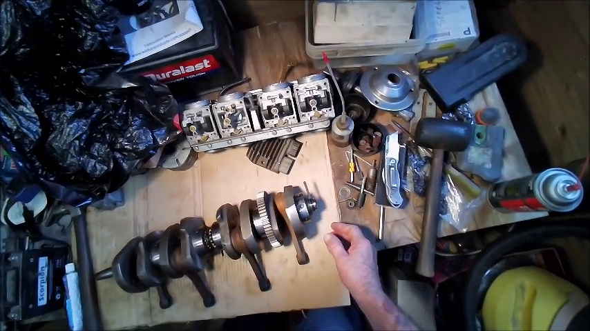

16 Mar 2026 11:33As I understand it the key disappeared on the 1000 with the switch to the "big pin" crank and the later generator for the MKII around 1980 ?Steve i know this thread of Z2 Crank info has turned into anything but, ha. I Friend sent me a second Z2 "early" engine to restore. Meaning it will have the "Keyed" rotor crankshaft assy or part number 13031-044. Later ones weren't keyed, tapered friction fit and had a different part number 13031-1007. I know this thread is all of 11yrs old and still running but still interested in those fonts found on connecting rods?
The keyed rotors continued to the early 1000's. I have one.
I still have the crank so I can take pics of what you need.

Not sure if it was the first 1000's but I do know the went with a heavier crank for vibration. The lamb chops came back on the later engines,
I don't know why I couldn't reply to last comment on the quote.
rumble.com/v2m9q4w-z2z-crank.html
- Posts: 23776
- Thanks: 3042
Re: Z2 750 crank (Bossie the Kaw)
16 Mar 2026 11:52

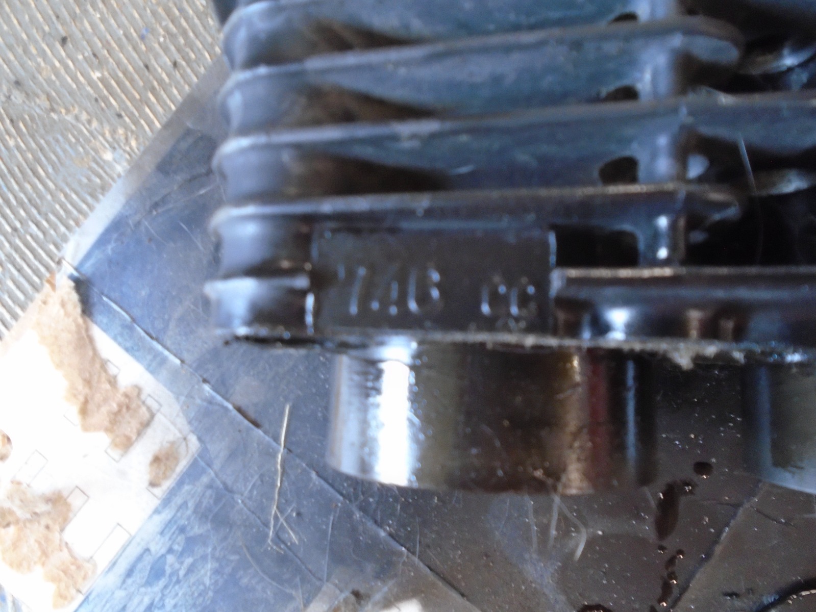

BTW the fonts on the rods are 5ZZ on all four. They moved the pins to make it 58 not 66mm stroke.

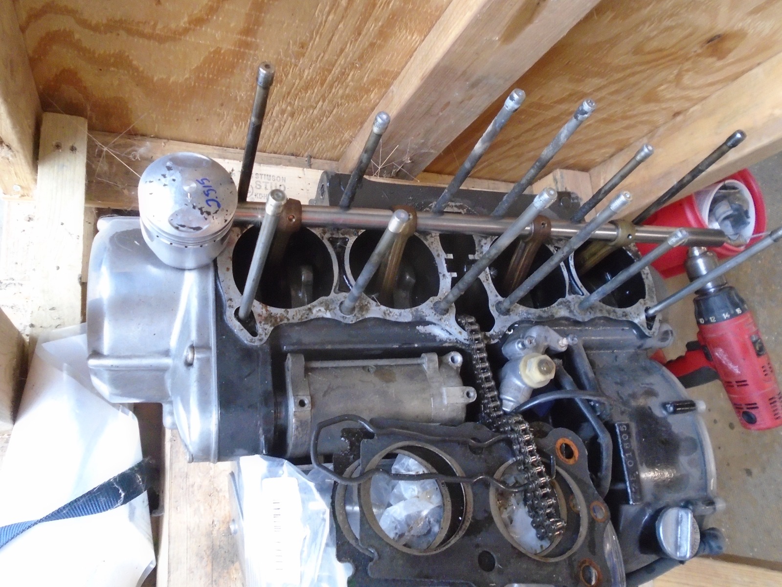

I was just going to add some literature to your files when i pulled this Z2 engine apart. Haven't even pulled it from the shipping crate yet, waiting on S pring consistent weather. I don't need a crankshaft assy. Actually ran across a fella that had 1 complete engine and going to pick-up 2 more. Back to your tire changing Steve! Ya know there are service stations that do that..right, ha.

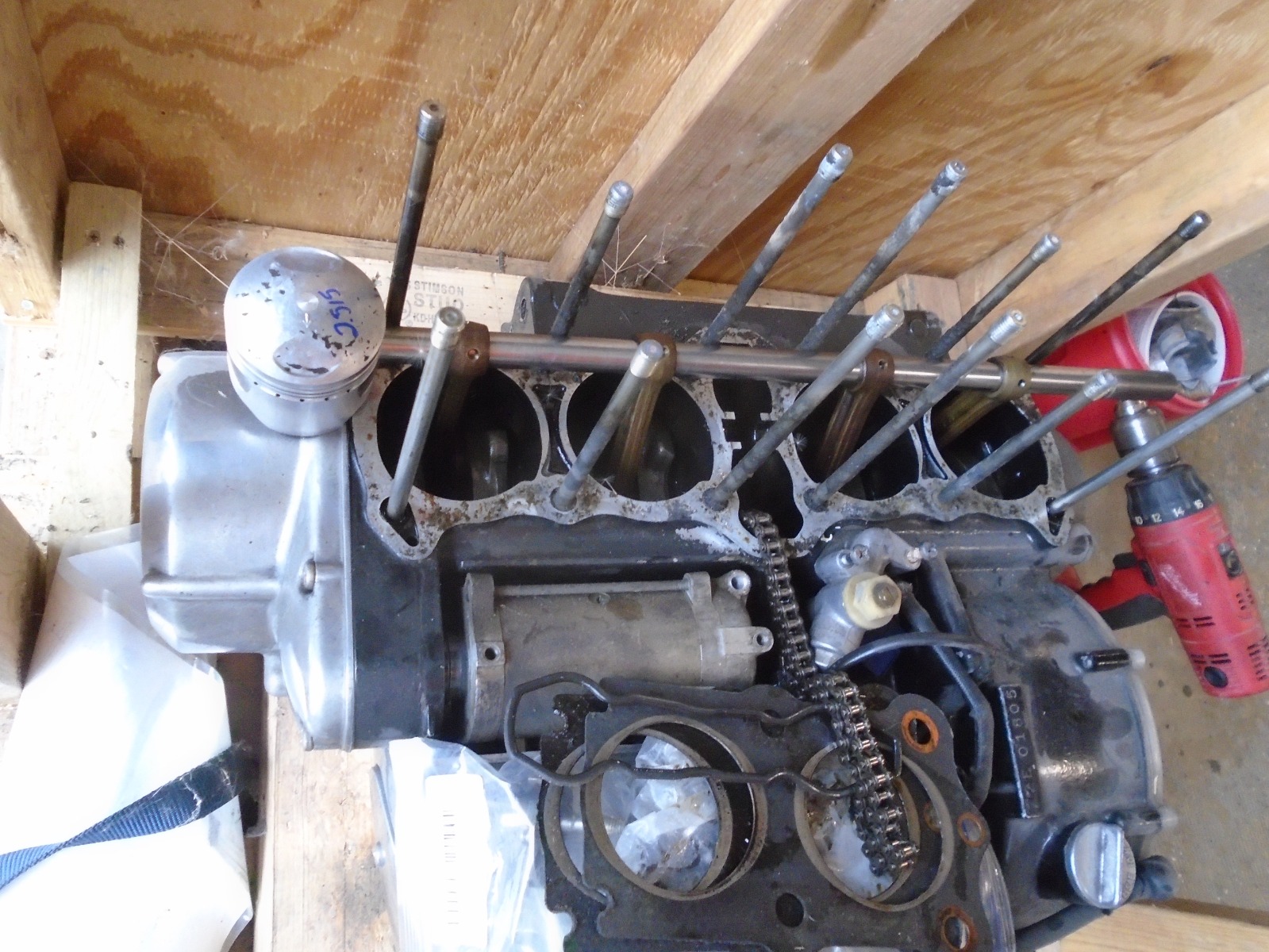

03 Apr 2026 06:15
Good Morning Steve!! Let's get back on track of where this party started, Z2 stuff. Going thru this Z2, finally. Going thru the whole thing after someone else had their hand at it. Power coated the engine but too shiny of finish.
