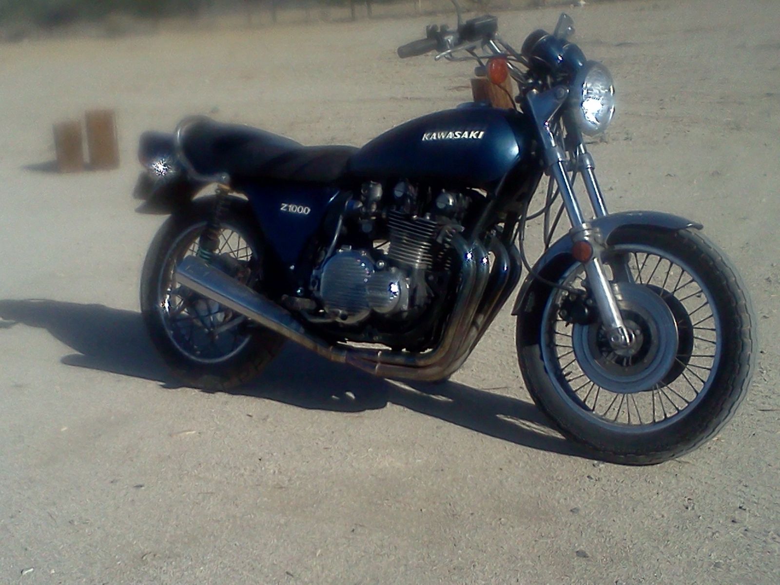

Hi guys,
New member here from Boise, ID. I'm looking at a 1977 KZ1000a soon. It's for sale for $1200 with a title.
All I know about it is that the engine and transmission should be sound (good compression, but will verify). The exterior of the bike however leaves some to be desired. It has pods, 4-1 kerker, and likely has been rejeted. The fork tubes are off of an LTD model and they are "chopperish" looking so the original tubes need to be put back on, as well as the stock airbox (he does have the air box). The tank needs to be replaced as it's had a serious tank slapper incident in the past. Various other things are expected that come up that needs replacing as we all know.
I plan to basically bring it back to mostly stock but with some Z1 influences. Sadly, it appears that no one makes 4-4 exhausts for the KZ1000, so I'm stuck with a 4-1 or the factory 4-2 exhaust (which appear to be cheap on eBay).
I'm kinda on the fence about this. The seller seems to be a very honest guy and invited me over to do a compression check. I've always wanted a Z1, but they are so rare and stupidly expensive. This seems to be close enough. I can probably work him to $1000.
I told him that I would be only interested if it's mechanically sound. I'm thinking I'm looking into $1000-1500 to basically get it back to where it should be (seat redone, stock fork tubes, fork seals, stock exhaust, new tank, gauge refinish, battery) excluding the paint/decal work which I do myself.
What's your guys' advice? Stay away?
