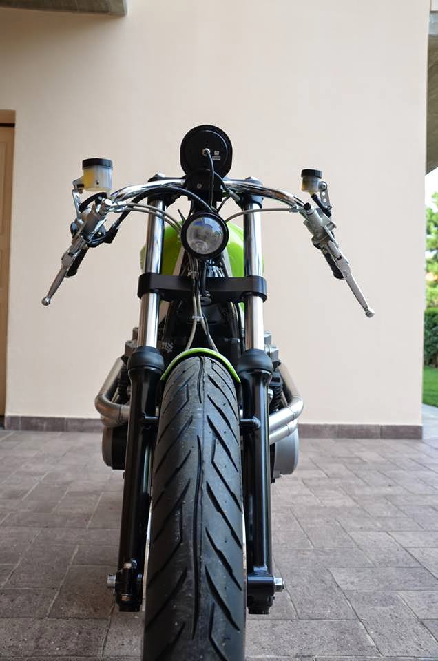

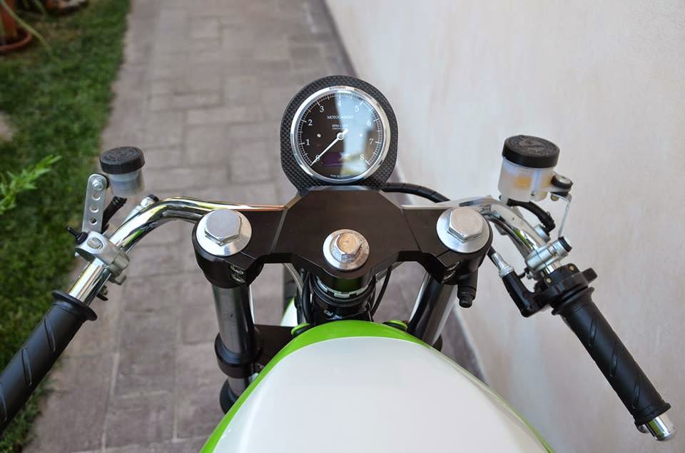

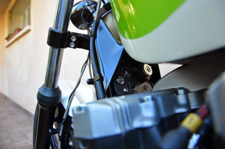

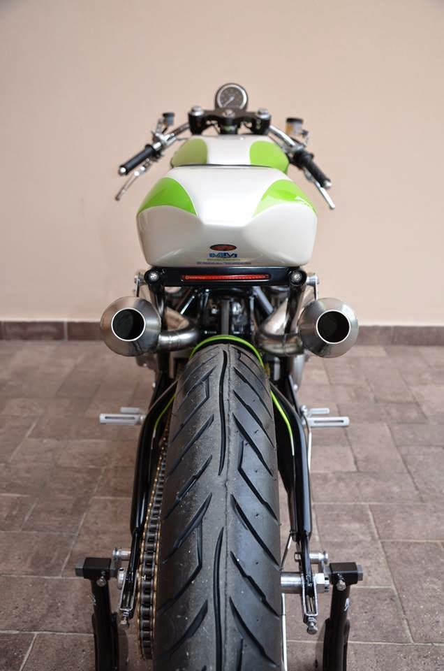

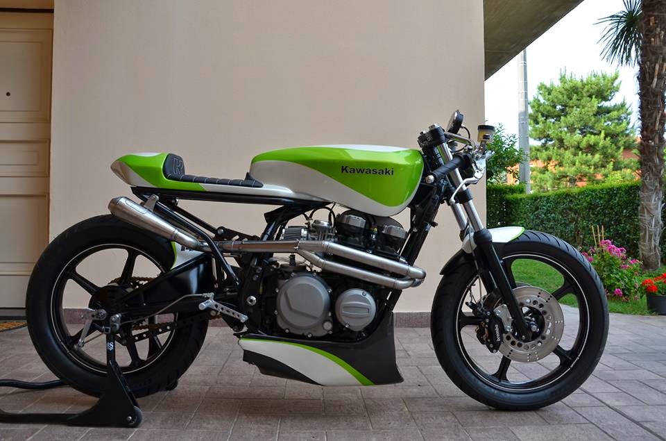

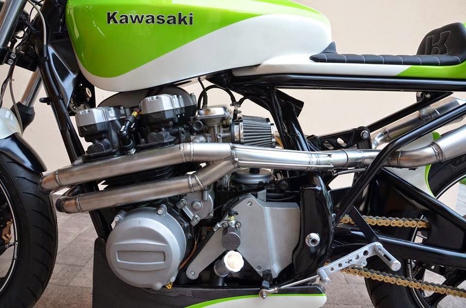

Ran across this during some google searches. Thought I'd scrape the photos and post them here for inspiration.
Done by Manuele Spadoni.
Not sure which model it is. Judging by the dual disks in front, no oil cooler, drum in the back, and CV carbs, I am guessing it's a European model that we did not get in the U.S.

Ahh, yes, I did only say "looking". If that tank is not metal, you can't use the moonshine most of the U.S. passes for fuel. I wonder if that tank is actually just a shell hiding the coils and a small metal tank underneath.
But, other than that, I don't see anything obvious that makes it un-rideable for at least short trips.
The hydraulic clutch setup is very cool, but I've never felt the need for it on the 550. It has one of the lightest, smoothest clutches I know of, as long as it's all factory parts. (The 650's are very good as well, when stock.)
The rear brake rod will add "springiness" to the rear brake actuation, which makes for less feel, and easier lockup, but that should not be too hard to fix by putting the rod-to-pedal connection on the other side of the frame, like on a stock frame.
All that aside, for a cafe/brat/whatever it is, it's the nicest kz550 I've seen.

Sharp looking bike but I wouldn't want to get stuck in traffic, those exhaust pipes will cook you alive
Nice seeing a fresh set of Avons, it reminds of whats waiting for me down stairs.

Headstock says zr550a, if I'm not mistaken that is a 550 zephyr, the 90s type ones? Or instead of just kz in the us and z worldwide did they also throw in zr elsewhere?

Yes, good eye. That must be the European Zr550A.
Europe got a Zr550A which was not a Zephyr, but more like a cross between a '82/'83 Kz550H1/H2 (gpz) and an '83 Kz550A4 (standard).
The motor had the standard Kz performance variant due to having no oil cooler, so it likely has standard performance cams, and the lower 9.5 compression (gpz was 10.0). So it's basically a Kz550A4 motor.
The frame looks very much like the '82/'83 Kz550H1/H2 frame. The U.S. Zr550B (zephyr) had dual shocks, but the European Zr550A models had the rear end from the '82/'83 KZ550 H1/H2 (gpz).
Notice the wheels have 5 spokes, not the usual 7. That makes the wheels similar to the KZ550H (gpz). But the rear has a drum like the Kz550A, whereas the Kz550H had a rear disk.
