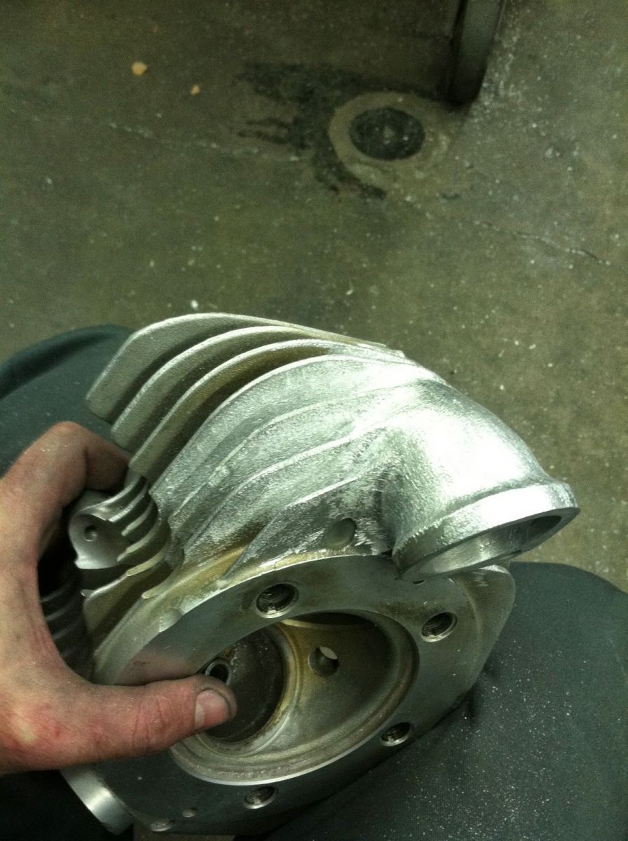

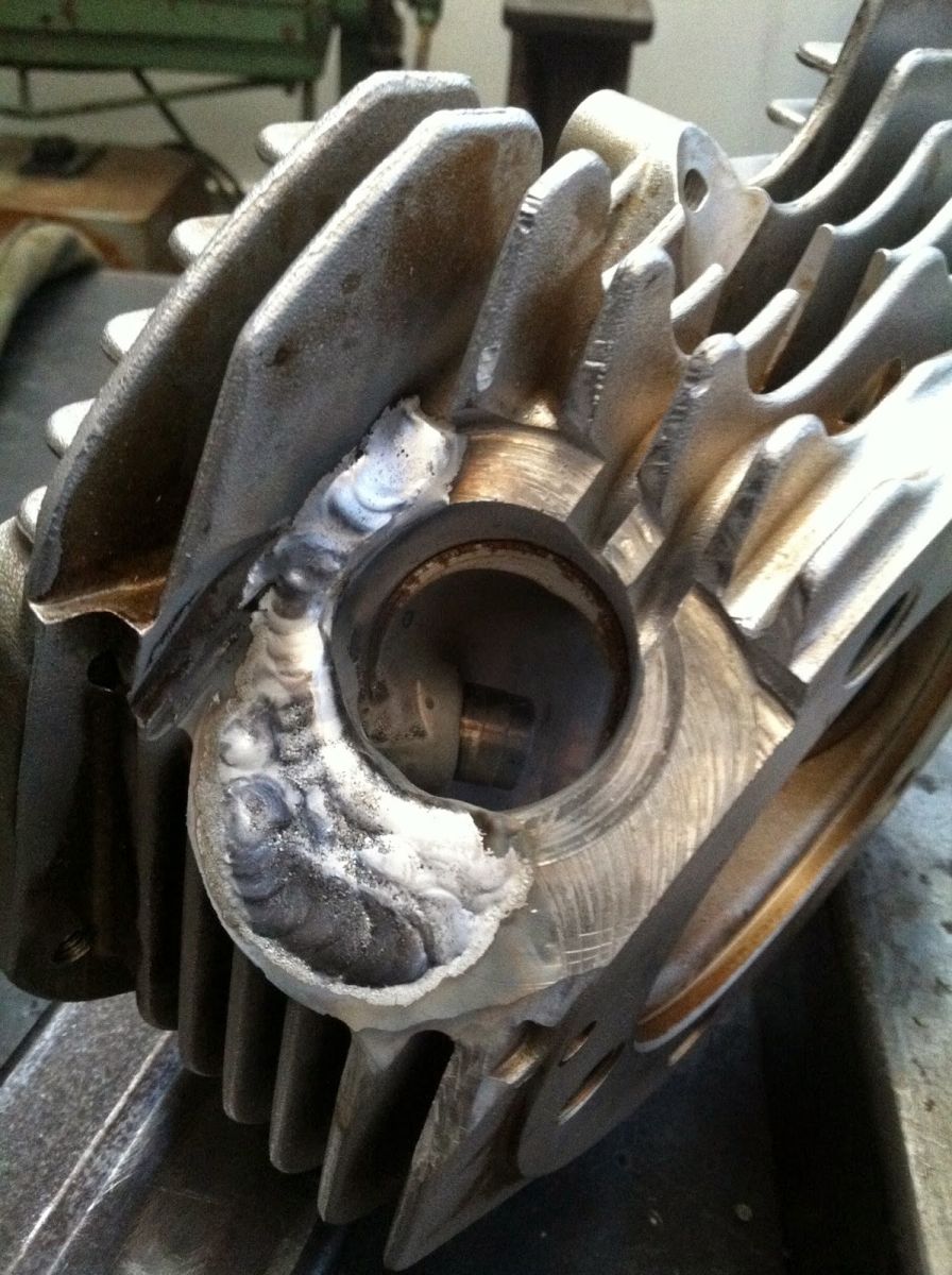

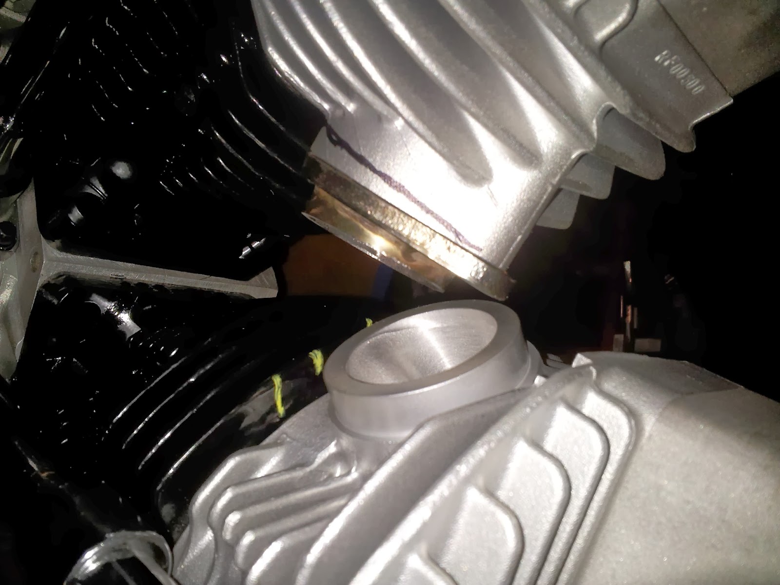

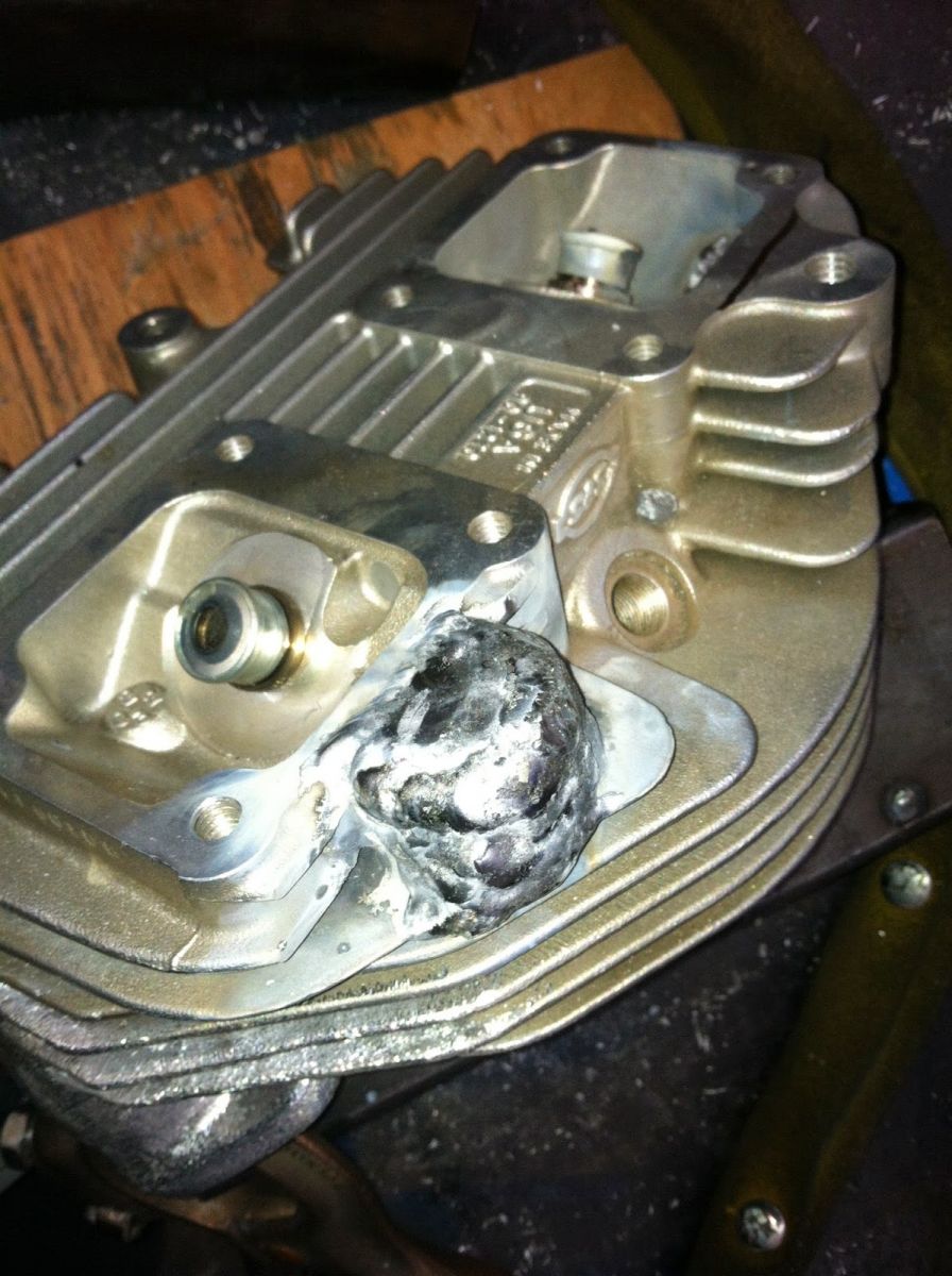

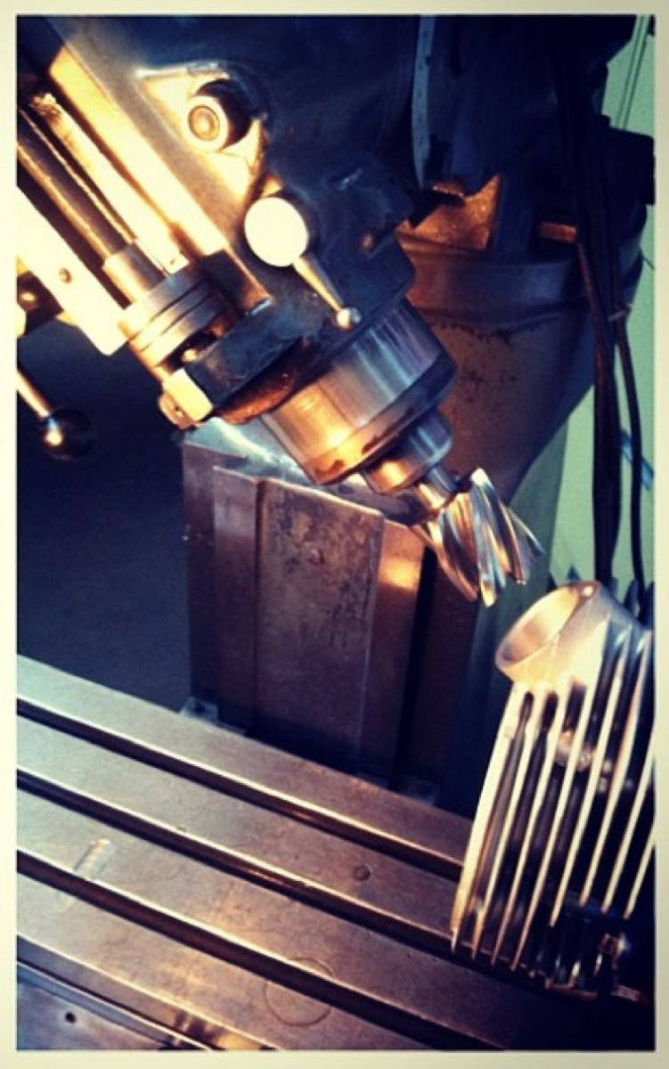

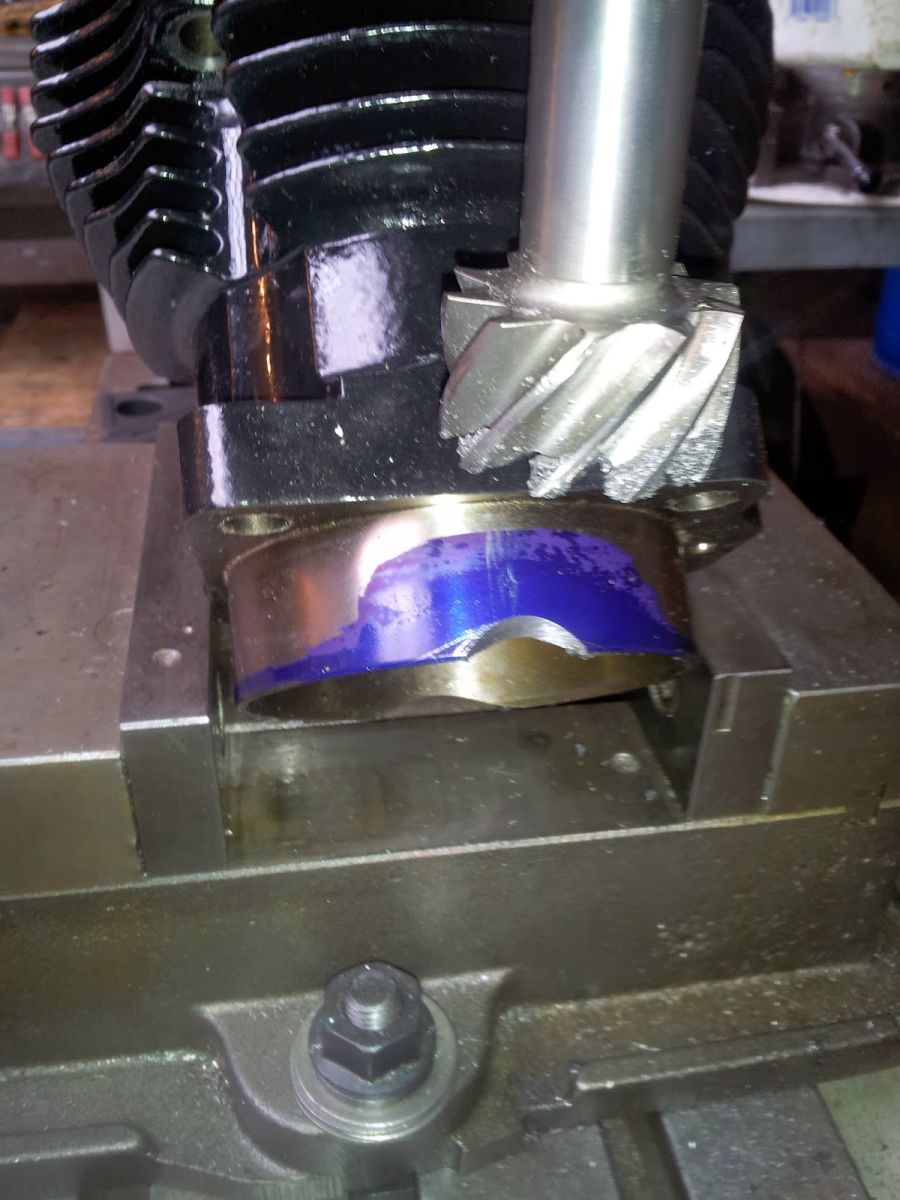

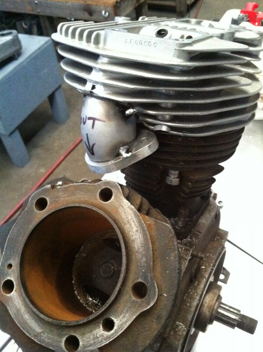

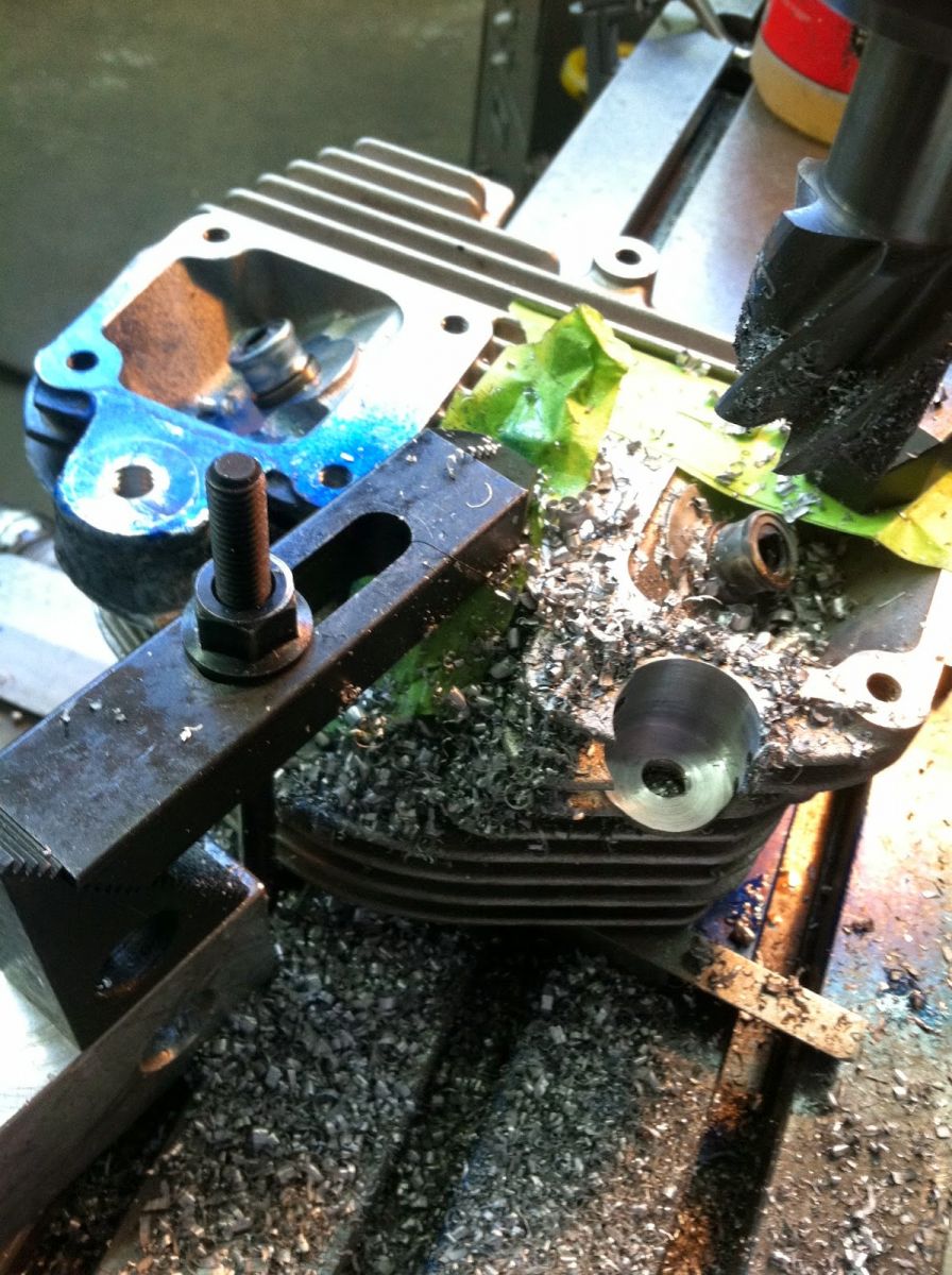

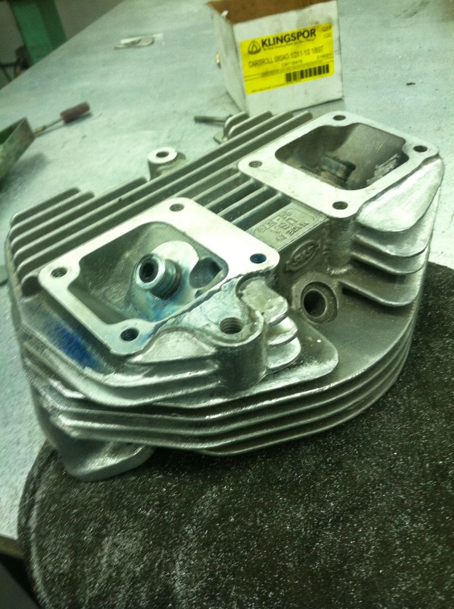

12 Oct 2014 10:47 - 12 Oct 2014 10:52floivanus wrote: Guess i dont see how swapping the head and cams round (dont most harleys use different cams front and rear, put a front cam in rear. Bam, swapped head?)
Other than that, yes a suspension swap, peanut style tank (it's a full gallon jesse) minus the easy seeming head swap standard harley fare.
A single loop softail frame seems rather unusual to me. Is it considered swap when you build your own frame, swingarm, triple trees and wheels from scratch? As far as the heads, all you have to do is swap exhaust and intake cams, but the rest is a bit more complicated than that....

shovelheads have a single cam.
brandons bike is a shovelhead based engine.
so there is just a touch more involved than switching intake and exhaust cams.

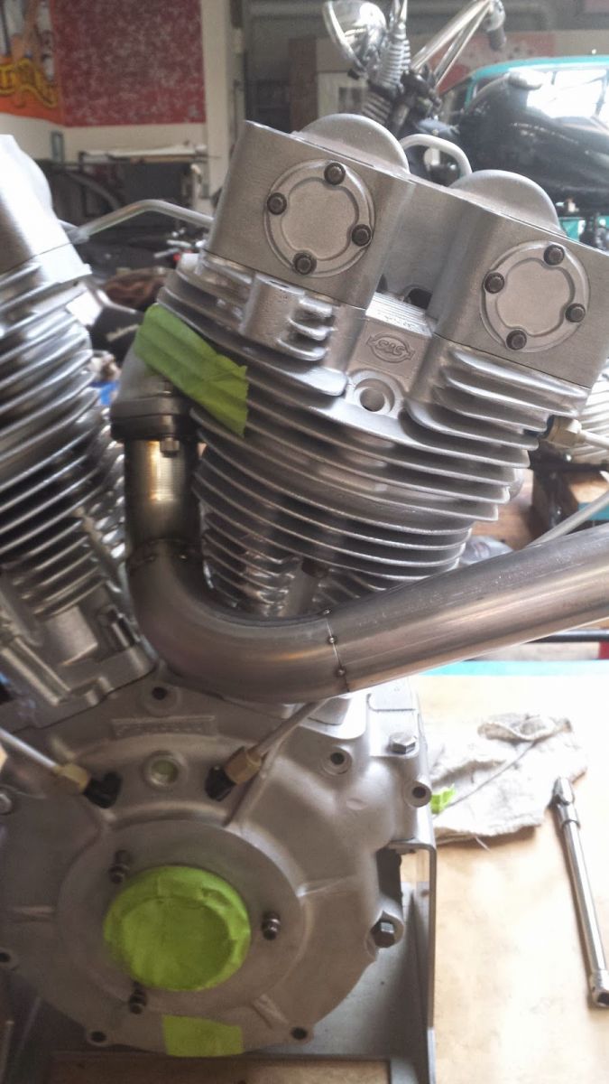

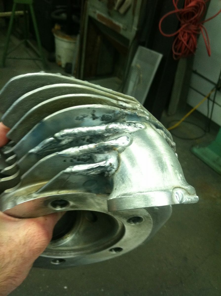

I can appreciate craftmanship, but a 180° turn in the port before it exits the head?!
