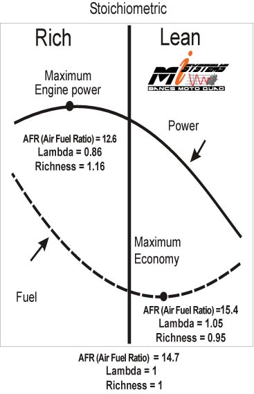

With those CV carbs your Mains and Needle position do nothing for mileage when cruising.
Its all about the pilots and mixture screw adjsutments.
The pilots should be the stock 37.5 you say is in there, as the 40's would be to herky-jerky performance wise.
If you tune your mixture screws for highest idle, then they ARE too rich in comparison to the stock positions.
For example:
The bike should be running reletively lean at and off idle - as there is very little load nor power demand, and generally tuons of air cooling the motor. Closer to stoichometric or leaner is perfectly fine.
When you demand power - the engine demands fuel and swings back towards the richer side of things as it transitions to the Needles, Mains even more.
Dont be afraid to have fairly lean plugs for cruising. They should have just a whisp of black ring down at the bottom of the porcelin where it meets the metal inside, and a nice toasty marshmallow brown ring around the tip and thensome. The rest being reletively clean and white is fine - so long as there is no black/silver specs and the heat strap reads around the middle. Then timing and combustion is good.
You want excellent fuel economy - tune your mixture screws about a full 1/2 turn leaner than the highest idle point on those carbs.
For example:
