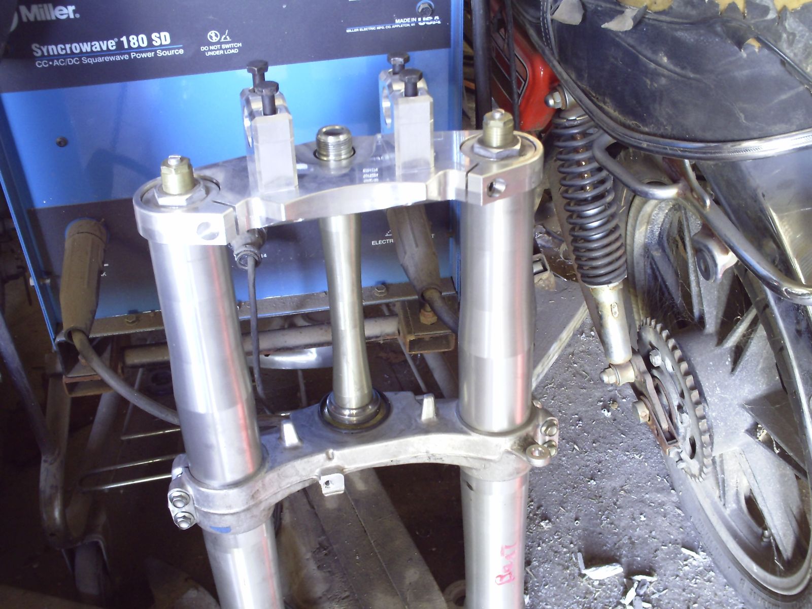

here is an example of one of irishwill's upper non-gullwing upper triples with a gsxr 1000 lower on busa legs.

31 Mar 2011 02:15porchev914 wrote:jus1975 wrote: Do you know if he can make them to fit other sized forks.
I'm sure the program could be modified, but there is more to it than simply changing the diameter or width of the fork tube locations. The stem is cnc lathed to use the GSXR hardware but the KZ bearings. I'm really ignorant about what goes into his triple tree programs, irishwill would be the man to ask about changing things for different front ends.
MTB, yes, including the SSSA/hardware/wheel/shock combined, those triples were still more expensive. Not alot more mind you, but more :blink: The triples were $650 shipped.
How much did that Yoshi nut cost ya? One of your nuts??? :laugh:

That stem nut was $33. It sounds like alot of money for just one nut, but just to buy a stock nut was $28..... so, I figured the cool laser engraved Yosh logo was worth the extra 5 spot. Besides, it brings a nice contrast to the black triples and stem

01 Apr 2011 10:16porchev914 wrote: That stem nut was $33. It sounds like alot of money for just one nut, but just to buy a stock nut was $28..... so, I figured the cool laser engraved Yosh logo was worth the extra 5 spot. Besides, it brings a nice contrast to the black triples and stem
Does that setup have another nut under the triple for the bearings?
Or is that a big bolt threaded into the stem to lock the top triple nut (the Yosh one) after you tighten it down?

There is a single bearing preload nut under the top triple. Its all gsxr hardware, the stock kz hardware was eliminated.
