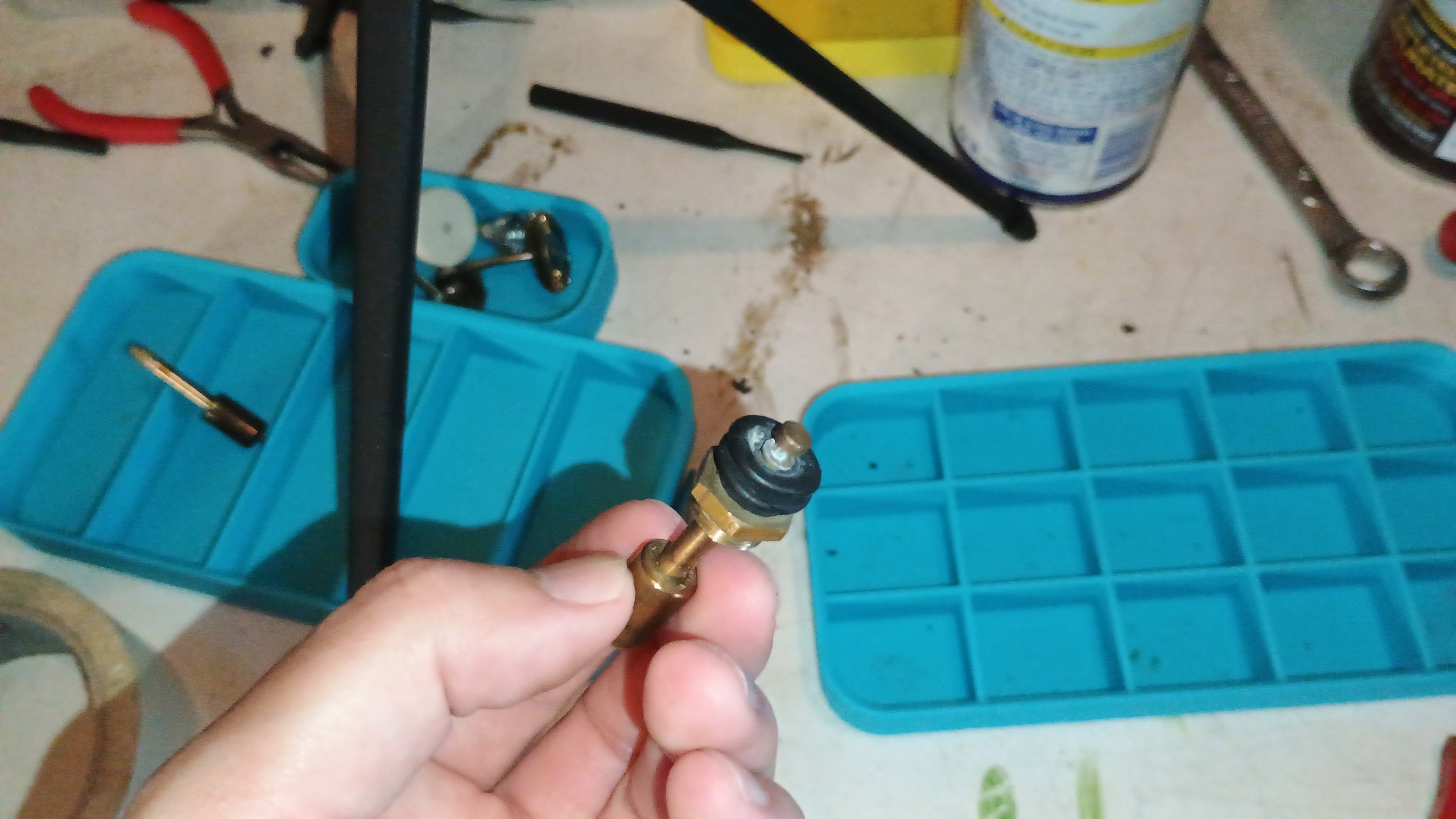

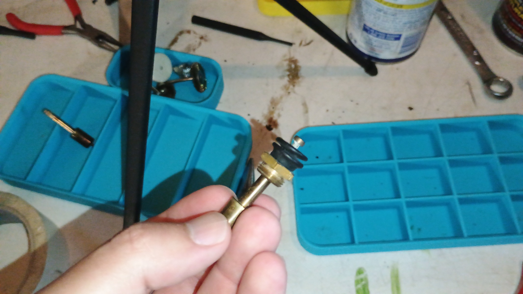

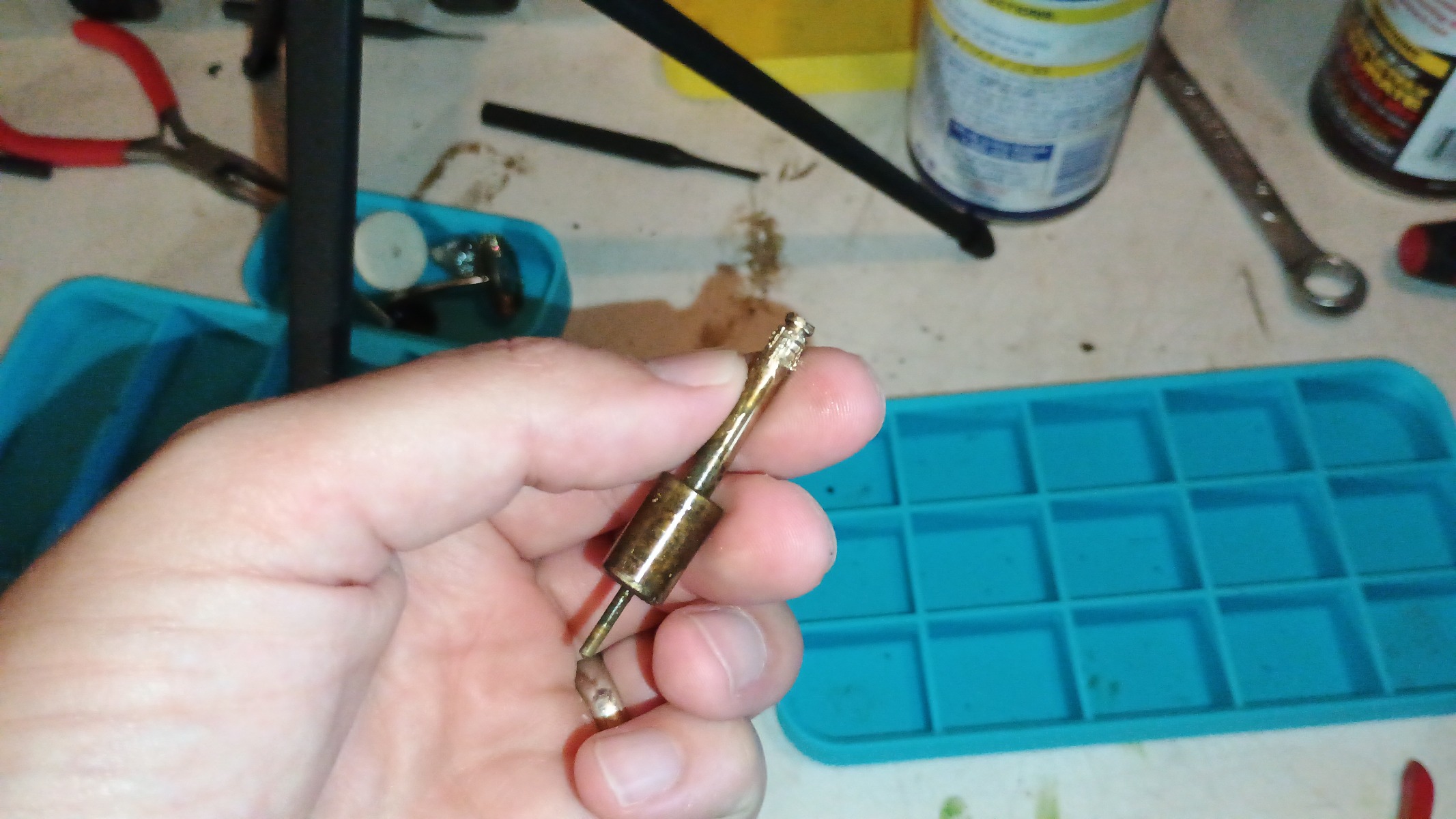

Does not look ruined.
- Savage89
- Posts: 25
- Thanks: 13
Re: 1982 GPZ750 (KZ750r1) - An Opportunity in Learning and Bonding
25 Aug 2026 05:19
While I wish that was the case, I popped the little end off where the choke rod attaches in some of my early attempts to get it out. Otherwise, it's fine.

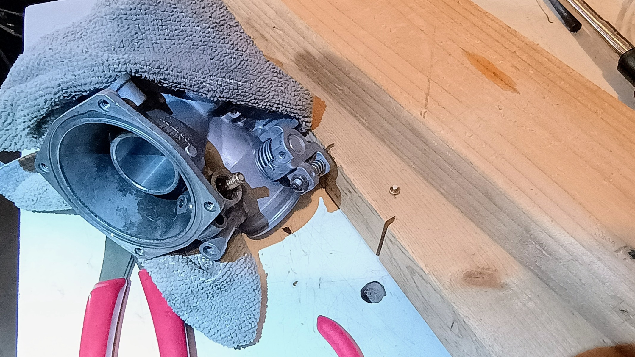

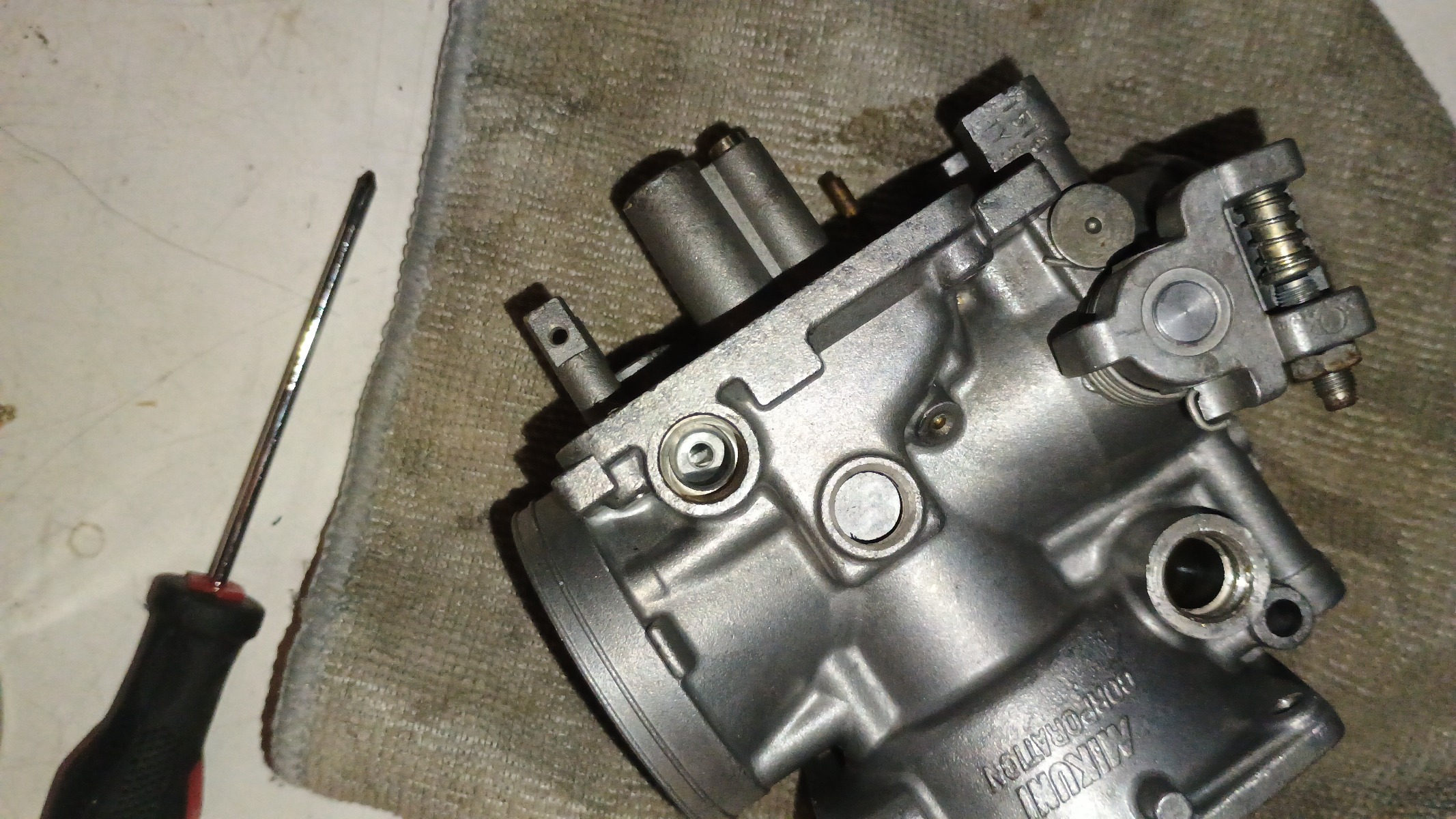

Ahhh. How does the bottom of the plunger bore look? That is where the seal sits. If that area is badly pitted, you may need to look for a replacement carburetor.

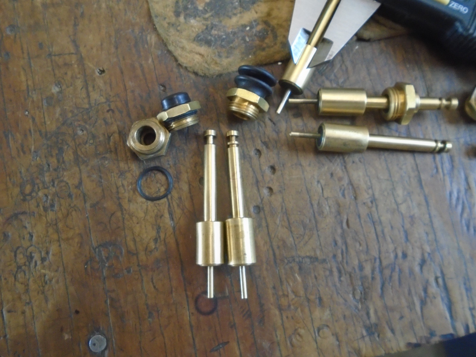

Whoops ha, stuff happens though. They had two different styles of those plungers for the BS34's. Did your ones come with bellow style or plain plunger dust covers? I've both already "loose" styles of both if you don't already have replacements. Might pull out another one, unmolested, for comparison just to be sure..

25 Aug 2026 06:38The bore is surprisingly clean, I'm really pleased actually. Looking it after the fact, I wonder if rather than being stuck with corrosion from water, it was just gummed up with a bit of old fuel that really locked it down. Thank goodness too! Looking online, getting new carb sets for this is expensive...Ahhh. How does the bottom of the plunger bore look? That is where the seal sits. If that area is badly pitted, you may need to look for a replacement carburetor.

Here's what i was talking about, BS34-32 Mikuni similarities. They both used the same dust seal shaft size 4.67mm ish but went about the production of those rubber seals in different ways. Also used on Suzuki too. So focus on Mikuni, not Brand. Either accordion bellow style, which you have, or
simply a boot.
- Savage89
- Posts: 25
- Thanks: 13
25 Aug 2026 11:46
Oh interesting, it's crazy how similar the plungers are. Just minor differences.
