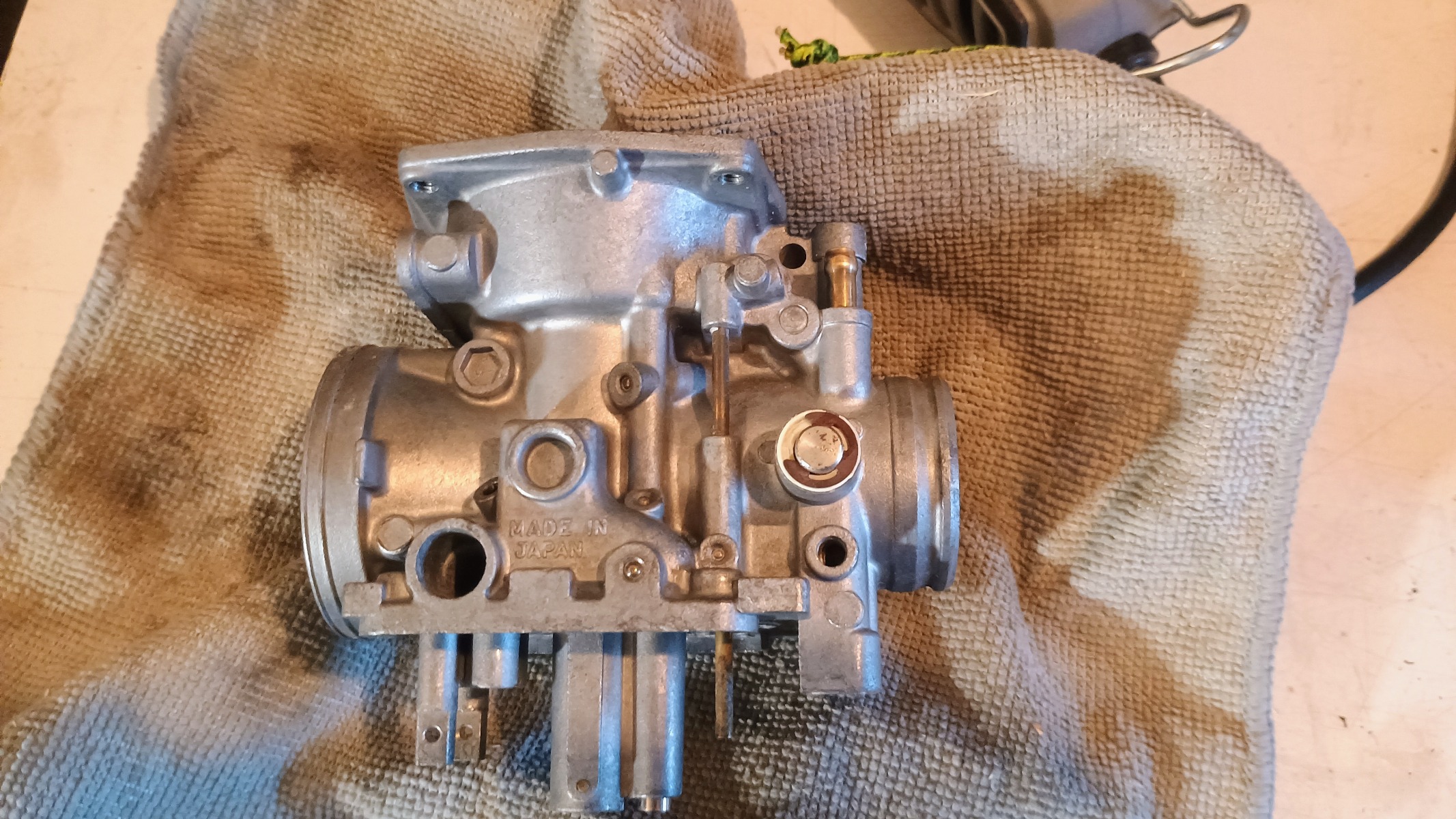

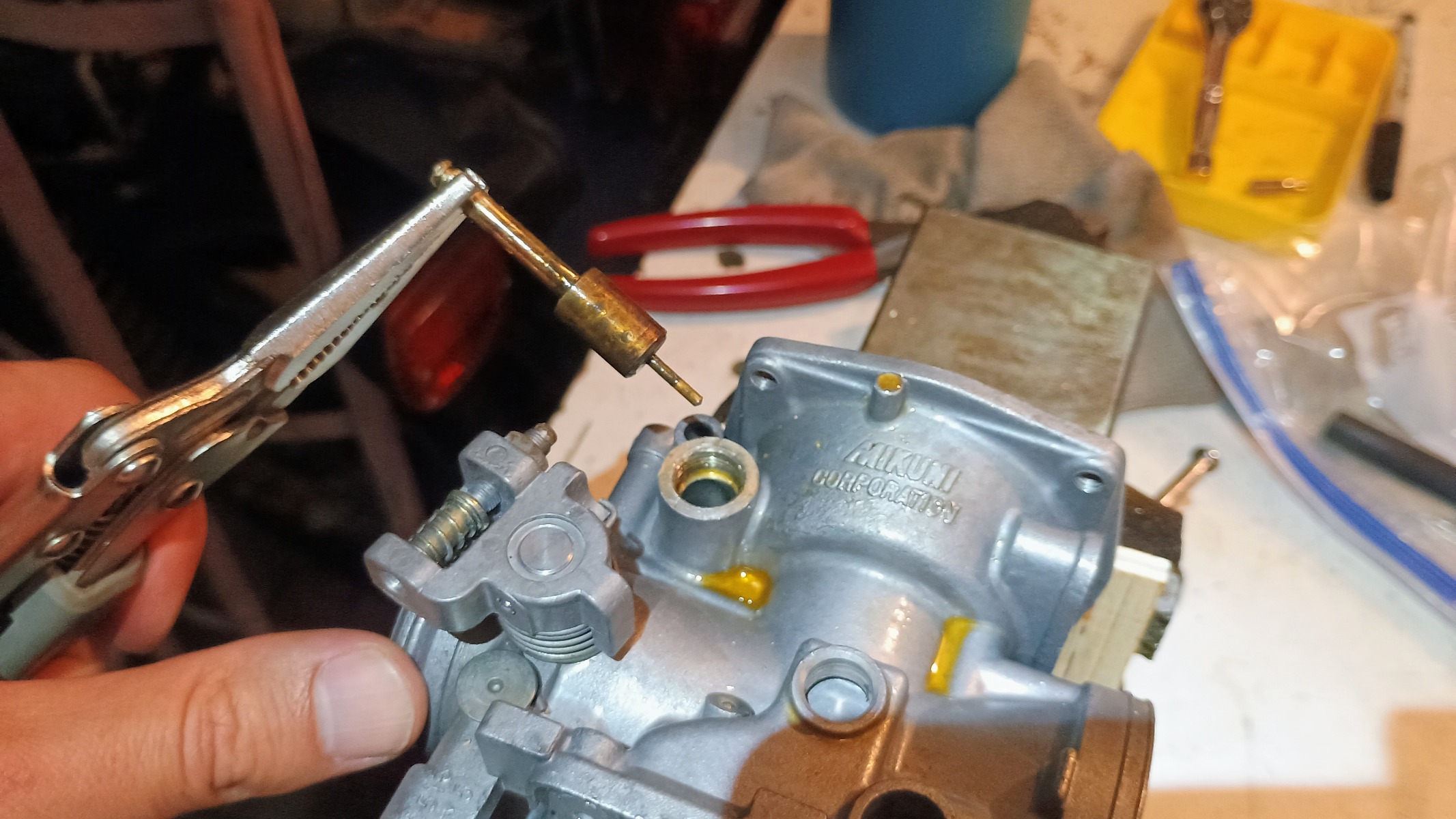

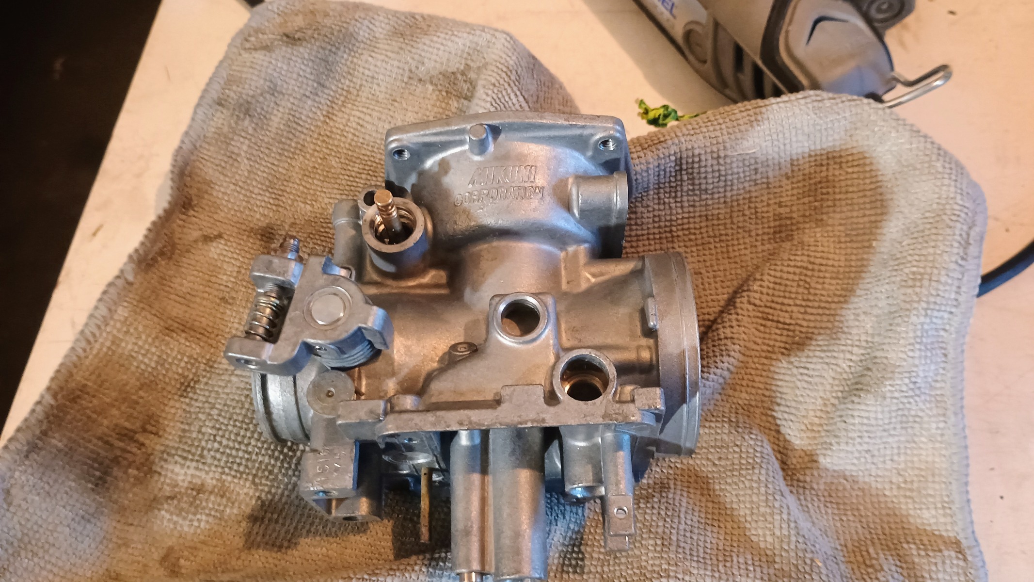

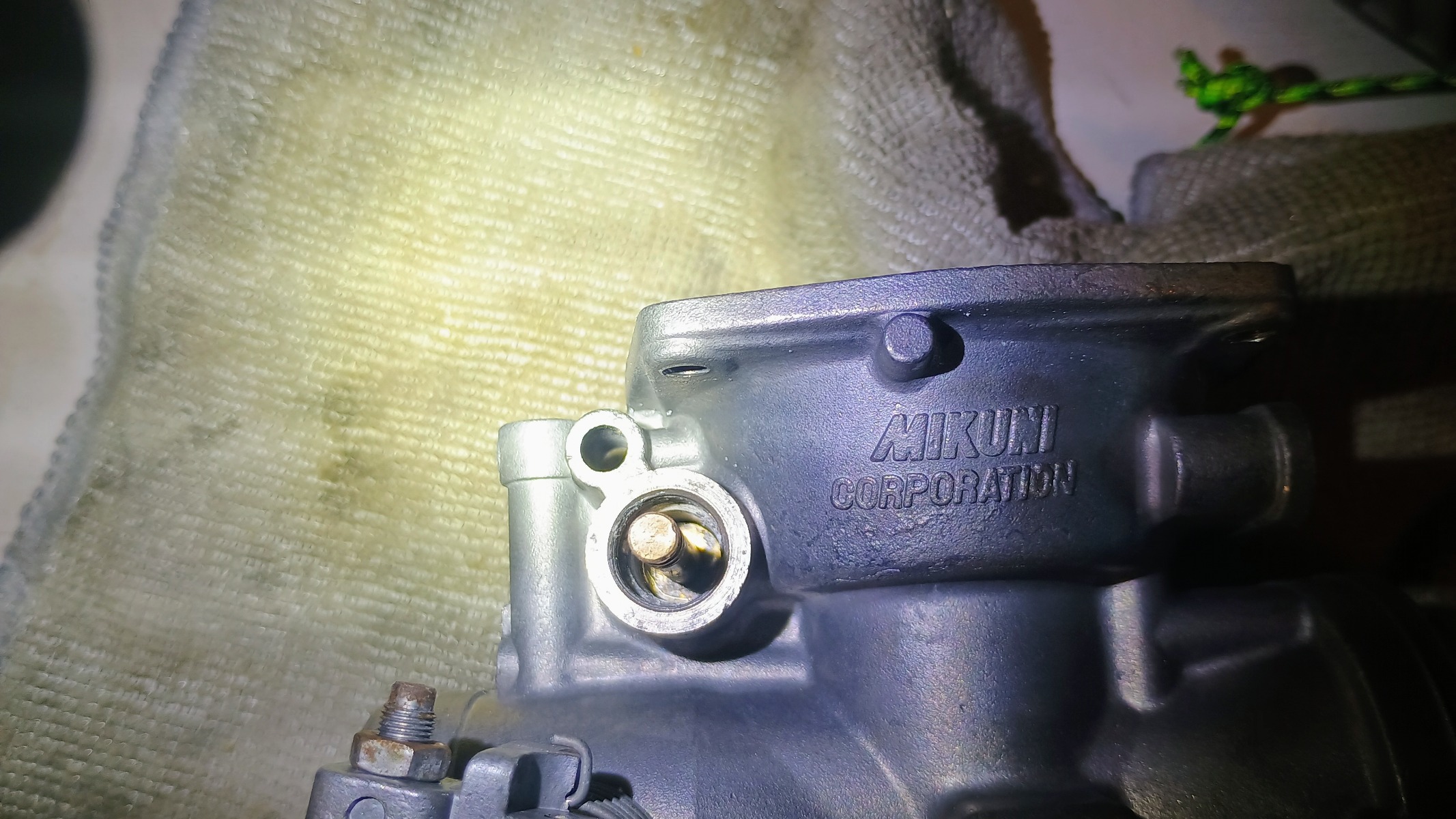

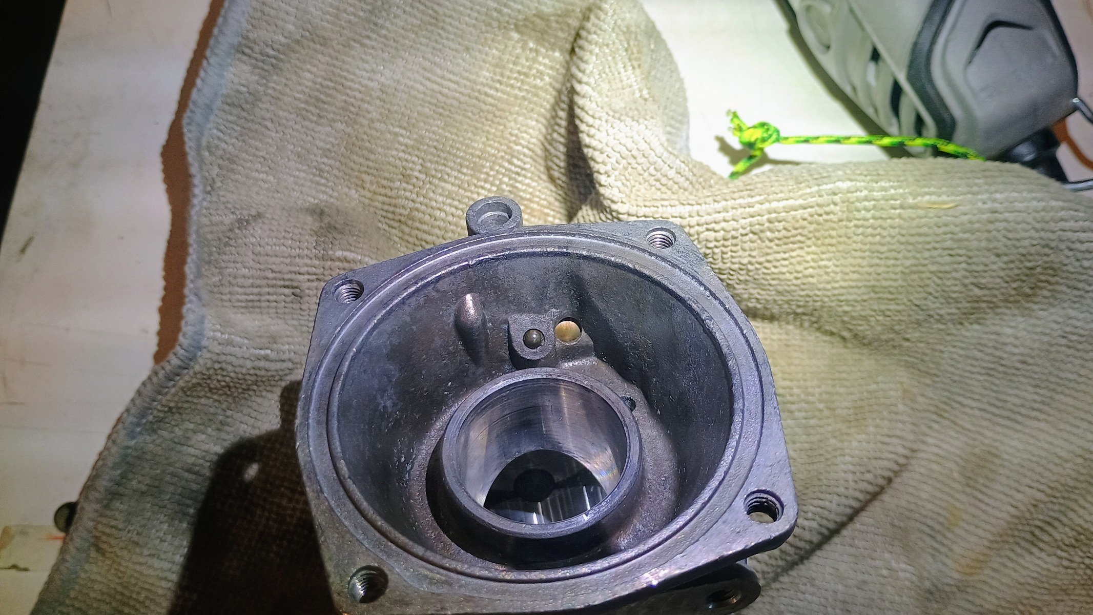

Alright, I come before you all today in search of recommendations.
The boys and I got the carbs off the bike and started on carb #1. We got everything off and out except for the choke plunger. It seems to be locked in by something. Either corrosion of sorts, or gummy fuel. I've already run the carb body through the ultrasonic twice, and it hasn't come loose. I'm prepared to hit it with a mini torch to expand the carb body and try to loosen it that way, but I'd love your recommendations.  Note: i've gone in with a brass brush and cleaned things up nicely. So any corrosion is no longer obvious.

Welp, I let it soak in pb blaster for a few days, blasted it with a heat gun, tapped on it many times with a hammer pulled and twisted with pliers, drilled holes in the plunger itself (it was already ruined before I did that), grabbed it with vice grips and it finally started moving and came free!!
