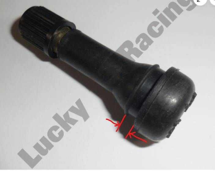

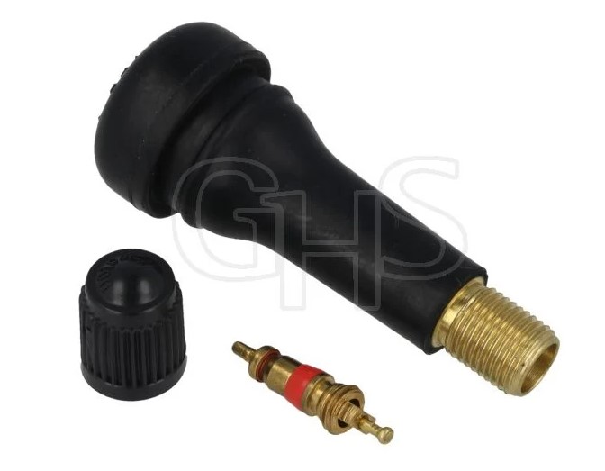

That looks to me like a "tubeless" valve for a "spoked/chrome" rim. Valves for alloy rims are normally a "barbed all rubber construction that "pulls" through the rim. (see below) I believe they are a pretty standard item so would question what your tyre fitter has told you !!!!
PS: the tubes may have been fitted because there is corrosion on the rim stopping the beads sealing correctly ?

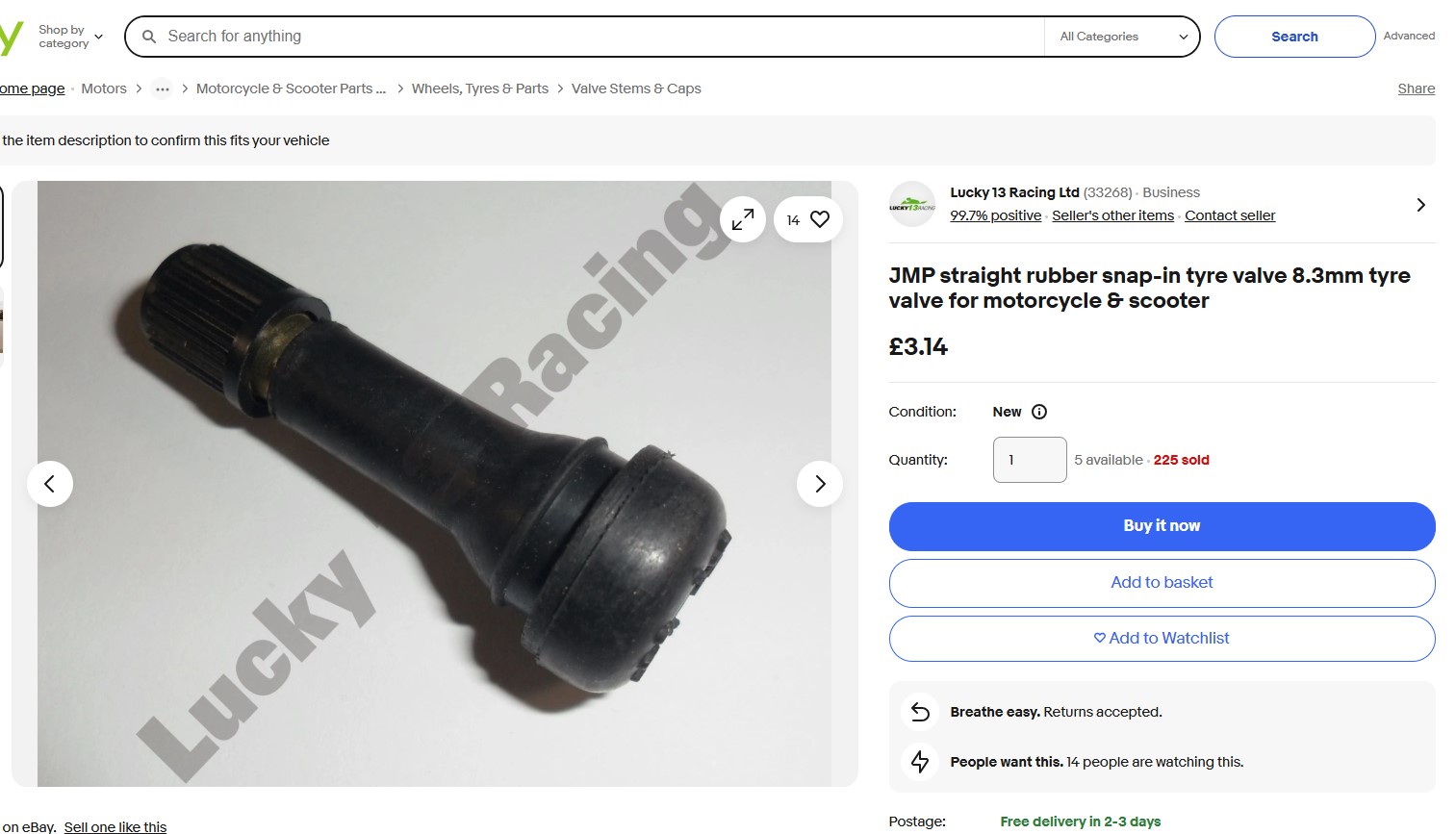

Hi there wasn't really any corrosion to see on the rims , and he did have the normal type in your picture but I think they were a larger diameter as used on cars, I'm sure that when I last got tyre fitted to a Zx9r I owned they just fit standard valves , I had these type of wheels on a Z550 in the 80s with metzeller me99 tyres fitted and i carnt remember having tubes in them , but that's a long time ago LOL.
M&P show them in 8.3 mm like in your picture but out of stock.
Thanks again Phil

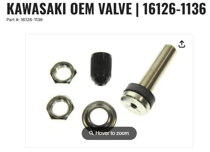

The OEM valve stems follow JIS 430 standard. I personally like the all rubber type better, but I'm not sure if the hole in the wheel matches.

22 May 2025 07:09Thanks Ed, every day is indeed a school dayThe OEM valve stems follow JIS 430 standard. I personally like the all rubber type better, but I'm not sure if the hole in the wheel matches

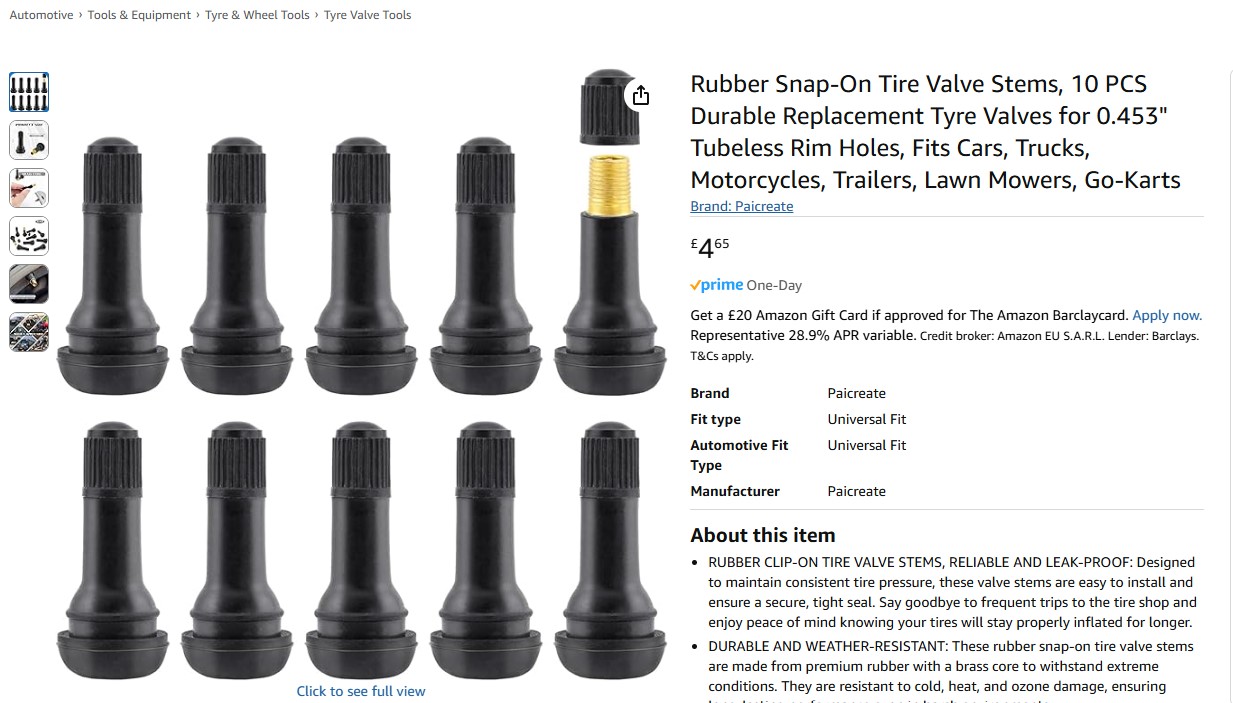

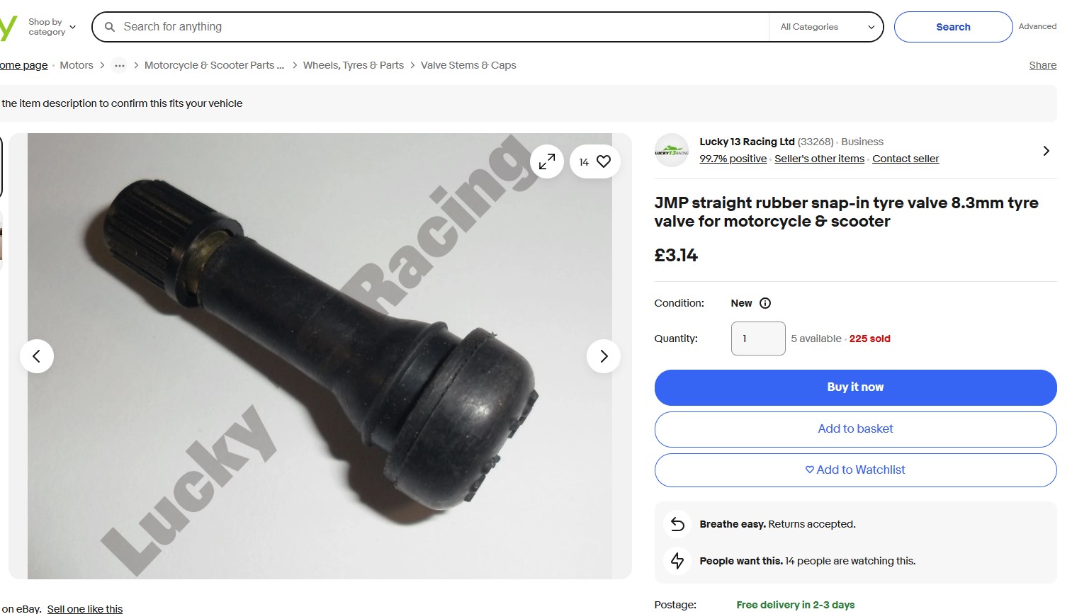

I found these also on Ebay, I think I'll be ordering a couple , looks like my rims hole diameter is 8.3 mm and the most common is 11.5mm standard on most cars .
