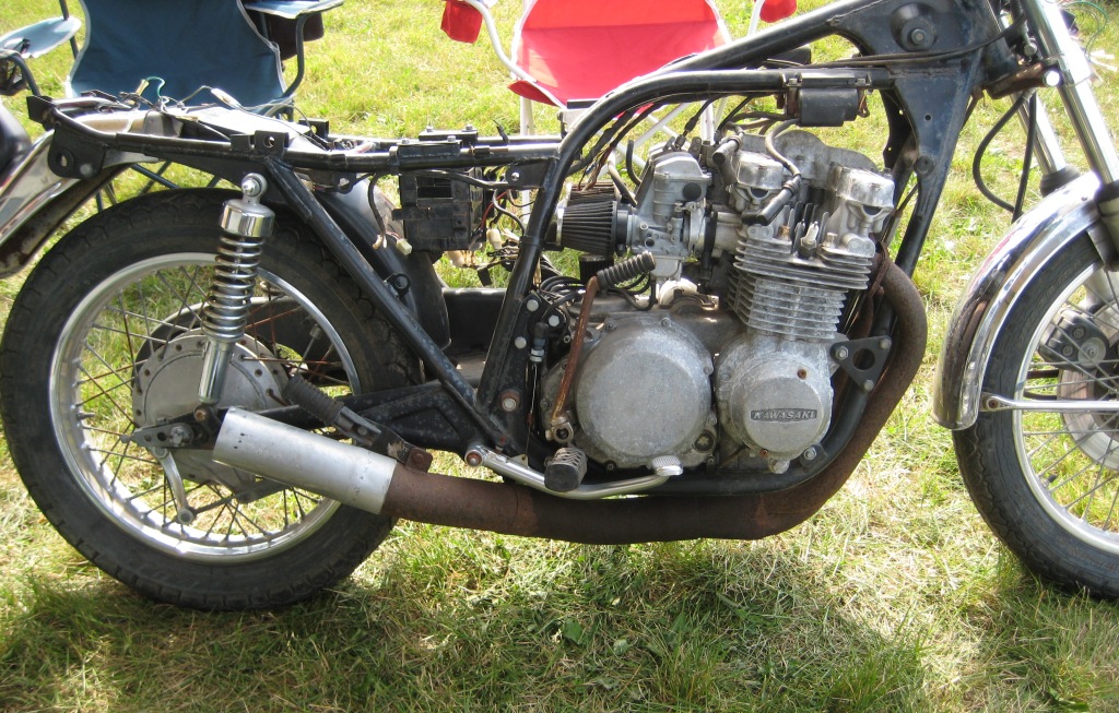

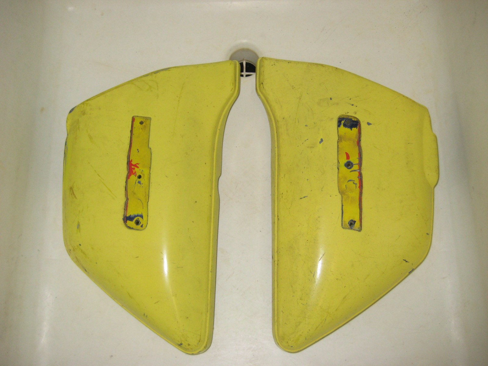

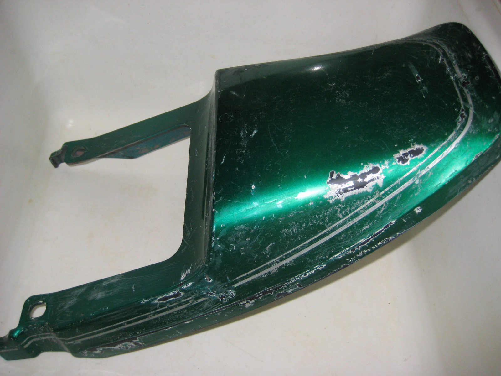

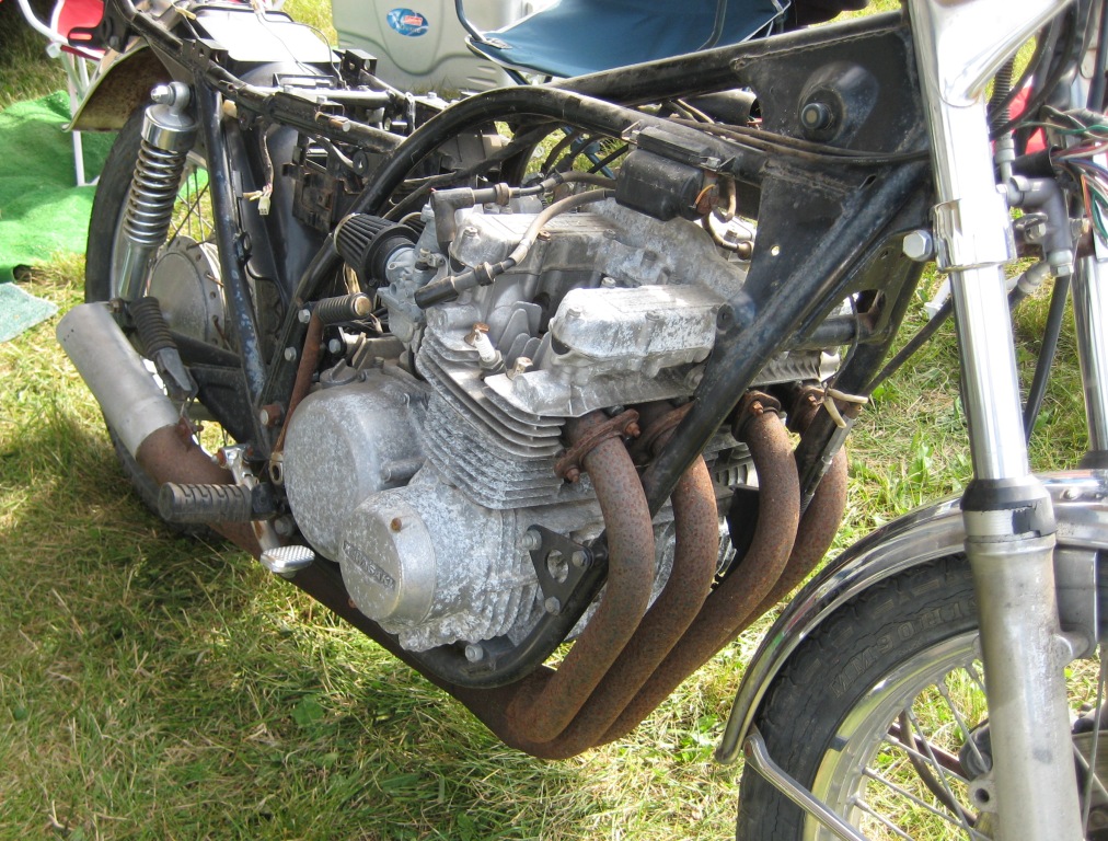

Just thought I would get the ball rolling on this but not sure on a timeline. Here are the pics I found of the day I bought the bike.
I took the tank, tail piece, side covers, and the seat off for the pics, all that was missing was the headlamp/bucket. It was already missing turn signals (a common mod)
The engine ended up being a low compression dog but it was free to rotate, just crusty with white corrosion.
I plan to cut down the stock seat foam, maybe do a aluminum or fiberglass solo seat pan. Fabricate a fiberglass headlamp shell. Alloy DIY rear set controls, minimal wire harness and smaller battery etc.
It came with a fairly clean tank and mismatched body pieces. All usable parts.

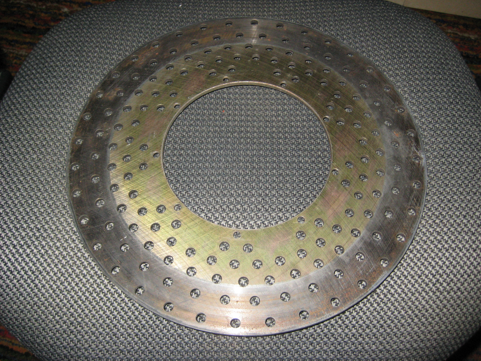

I found this 13" Mark Zero road race rotor in my brake parts spares bin. It was on my 831cc 650 back in 1986, I took it off for a smaller diameter when I converted the bike for drag racing.
I think I want to cut the diameter down a bit and machine it to accept floating buttons. From what I can gather the buttons are steel and held on with a cir clip, can make those as well. Will fabricate a alloy carrier to bolt to the front hub. May turn the front hub to get rid of gate flash grind marks.
Looking at used Ducati 4 pot caliper to complete the front brake.

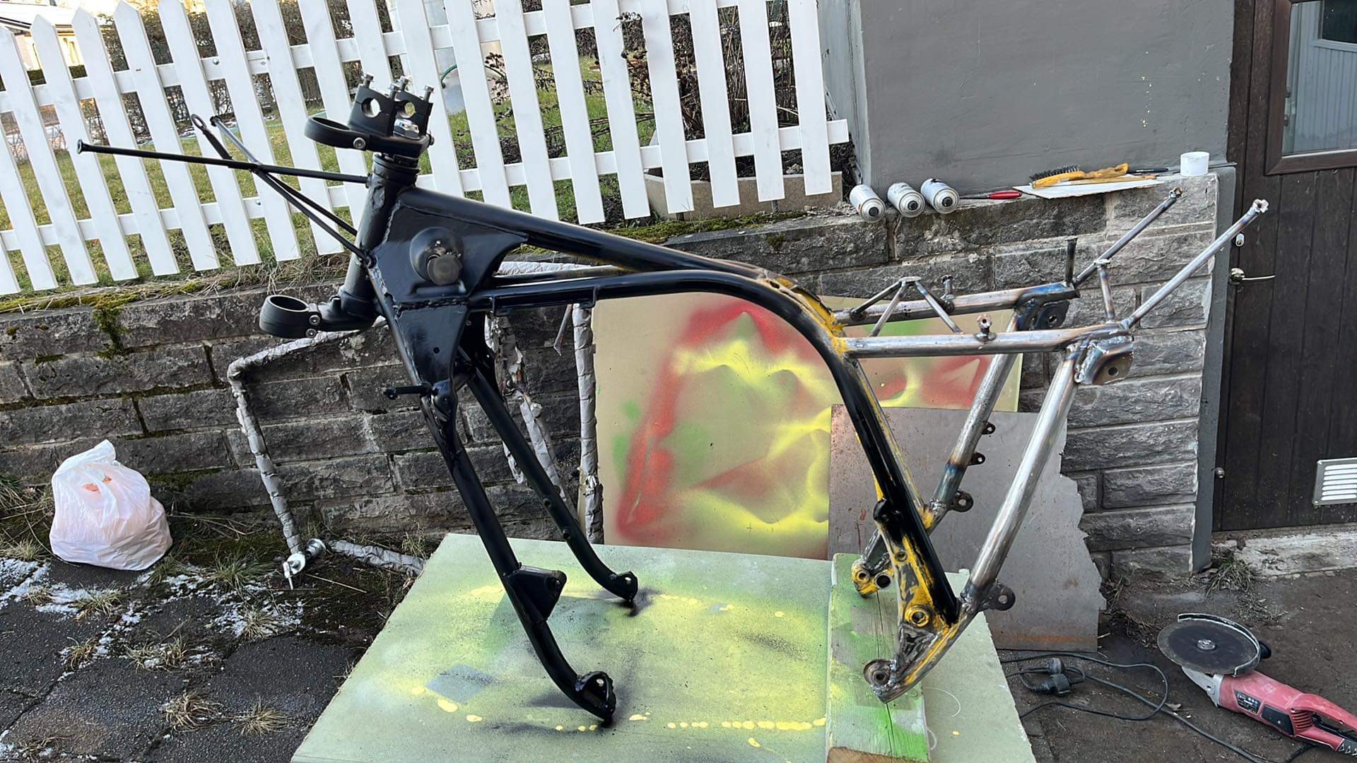

There is a few kgs to save on the frame. 🙂
Maybe not recommended for street use.
If I remember correctly the frame now weights ~10kg.
The whole bike weights 159kg without fuel.
But that’s without generator and starter. Aluminium swingarm and magnesium wheels.

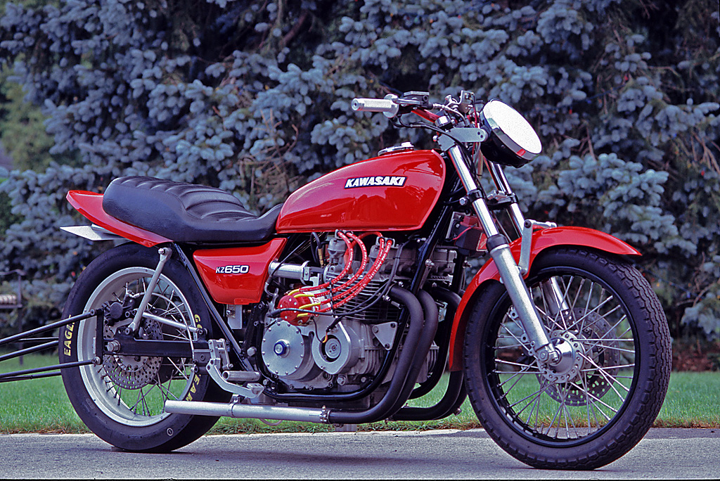

Yeah, my drag bike is maybe 10kg over that (dummy tank/light) The back half of the frame hoop was cut off, and a bunch of steel tabs. Seat foam almost non existent!
Not trying to get down as much because its a street bike. I don't want to do any frame cutting like I did on the drag bike. Plus I can't run total loss ignition because we have a daylight "light on" rule here they enforce.
It still needs most of the charging equipment, and it has to pass a safety inspection, so it needs all that on it till it passes (center stand, passenger pegs, turn signals) Once it passes inspection I can take all that stuff off it.
I think if I can get it down to 420 lbs I would be very happy with that as the engine going in it makes +85 HP at the wheel.
1978 KZ650B2 modified project

That drag bike looks great. Very long intake runners? Did that improve midrange or top end?
