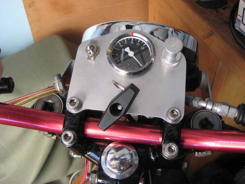

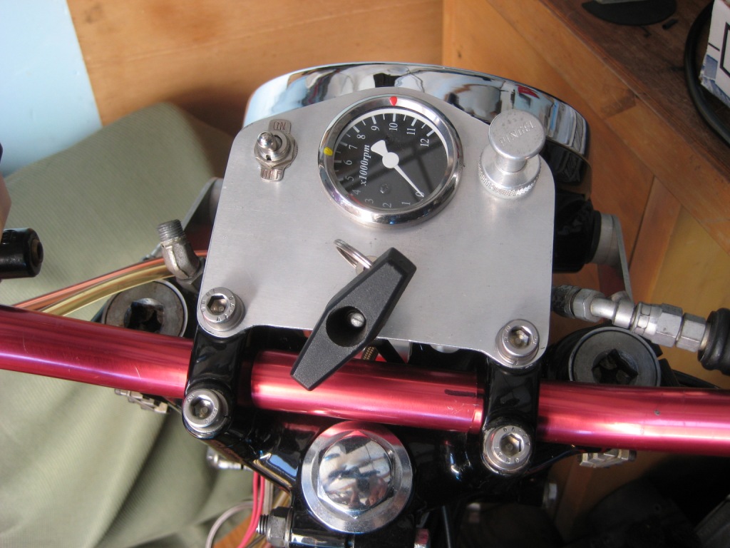

Noticed this picture of the new "dash" on my drag bike in a folder on my PC. I put one of those 60 mm tachs on it when I got rid of the battery. With the magneto installed I went back to a mechanical gauge and air shifter parts instead of the Dyna/MPS electronic shift minder, RPM limiter, air solenoid/kill etc.
Just shows how tiny these cheap gauges are compared to the Kawi gauges.

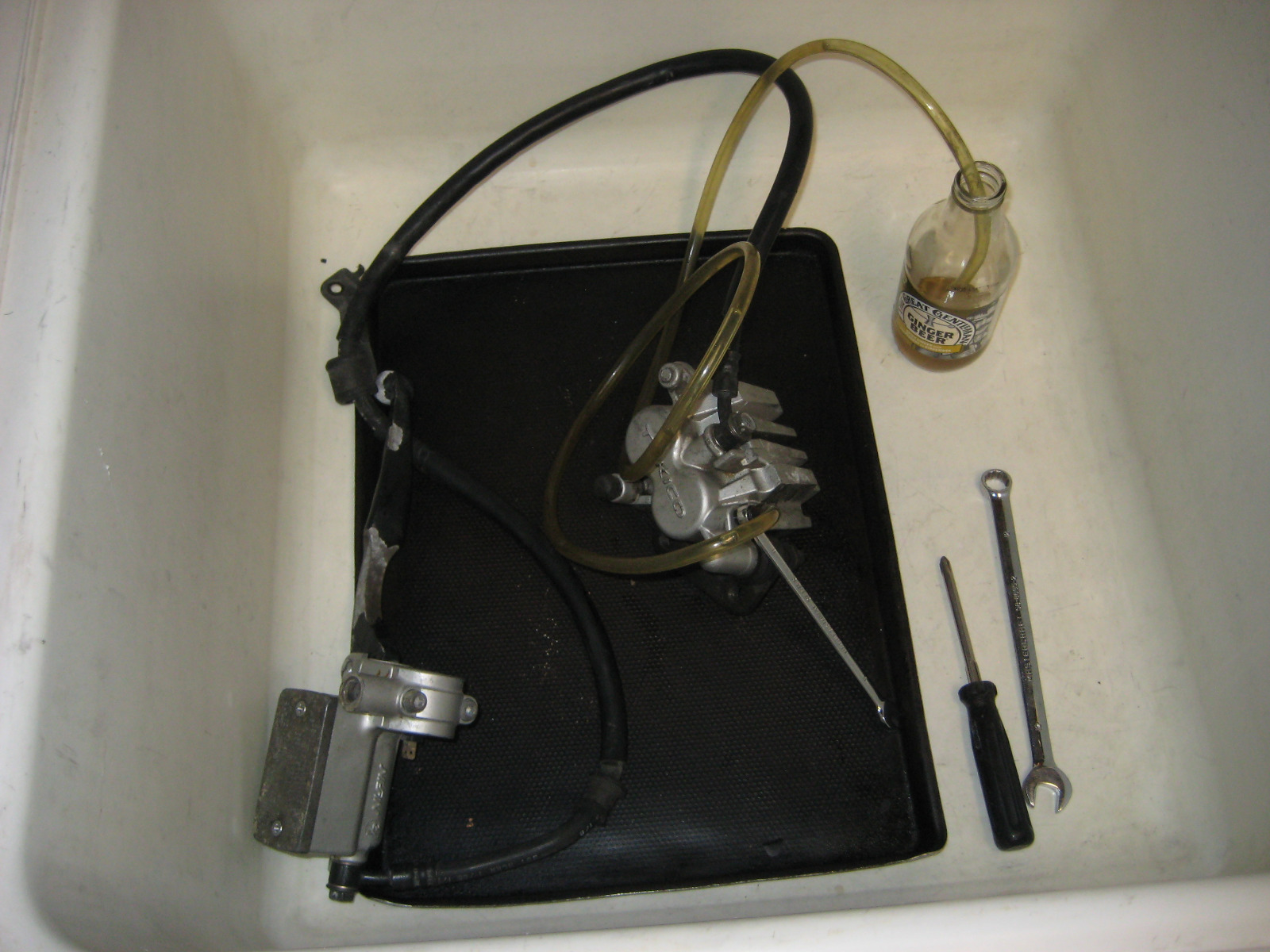

I received the majority of the parts I purchased recently for this project. The GPZ305 fender is going to work out perfect for this build, as its just the right size.
I just got around to testing the front brake set I bought, holds pressure with no leaks so that is good. The pads are shot so have to order a set.
The main reason for going with the modern parts was increased braking power. I do need to see if I can dig out the stock brakes to see how much of a weight difference these parts make, but no rush.
